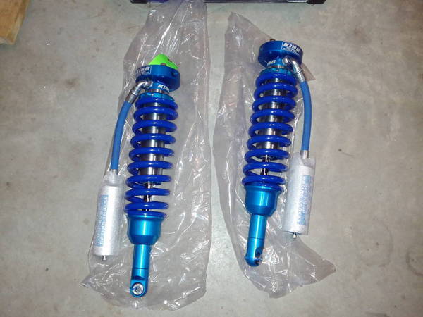

    Now to install.
    Question for ya. The coilovers are labeled for sides left and right, I'm guessing left is driver?

    Even easier than labels...the resis go toward the front...hahahaha

    Just gotta fig out how much I need to preload. And if both sides need a bit??

    I got 2.5" lift on passenger side as it came and driver side was 1.75". I added 6 turns to driver and it is spot on level if not just a little driver side high.
    If I were to do it again I would put 5 or 6 turns on the driver's then install and go from there.
    But you are setup like mine with bumper, winch and skids so it should be similar. Chris bought my old coilovers and his was exactly where mine sat with them.

    You talking 6 complete turns or just 6 good cranks?

    Full rotations

    There. A pic of both. Now to find time to do the install of them and these..

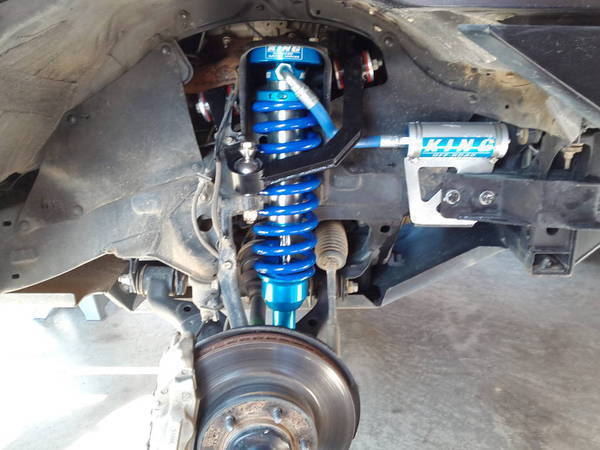

    Got one side done!!
