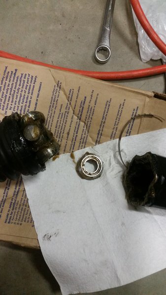

    Ok, so I tried to seat the tulip like you said and am now about 90% sure that I screwed up the new CV axle. It won't seat. HELP!
    Every time I lift it horizontally and get it to seat it still won't rotate freely all the way around. It still feels like it pushes itself out at about 3/4 turn.
    I am completely stumped and have no clue what to do.

    Found the problem. Took the cv apart and one of the roller bearing thingies had popped off the center stud thingy. I know I know, all these super technical terms...
    I took a c clamp and pressed it back on. Let's hope that works.
    Here is a picture to help.
    Thanks again @allmotorrex
    Now all I need is a cv band clamp tool to seal it back up and maybe a new band. We will see if I can reuse this one.
