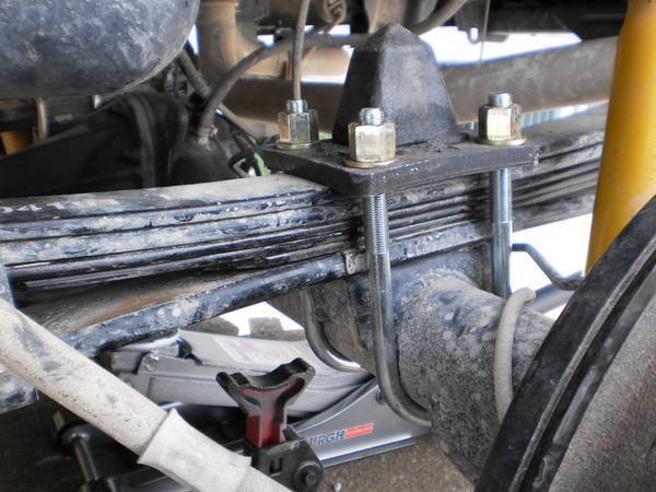

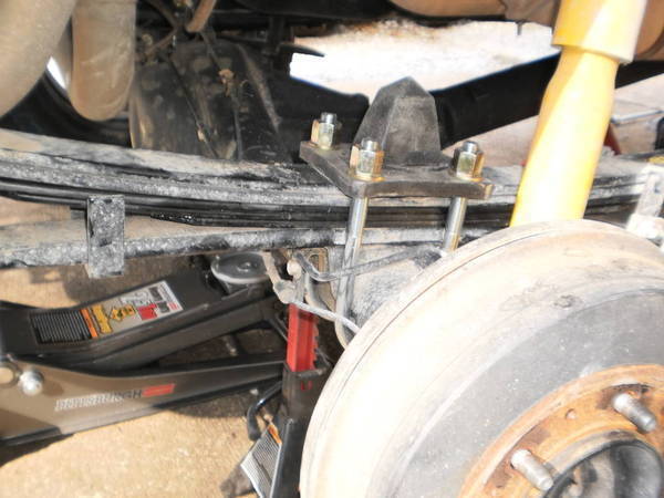

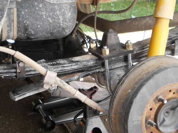

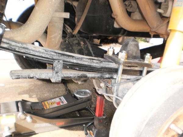

    well finally got off my butt and worked on the truck this weekend. took the single 1.5" AAL off and put on a wheeler's 3-piece progressive AAL. Decided to leave the overload leaf on. while i had the rear end in the air I also figured it was a good time to go ahead and install the ubolt flip kit and do the squeaky leaf fix.

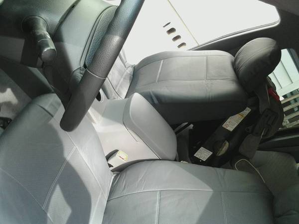

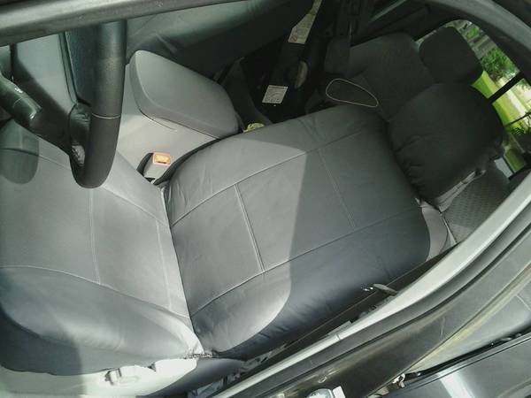

    ok so i got my seat covers in yesterday and was able to install the front two. I know that they dont fit perfectly and im sure someone out there has had better but i seriously doubt they got it for $70 shipped. plus this wasnt done for the cosmetic reasons, it was done to protect the seats since i have a very dirty job.
    so even though that sounds like me being a smart ass (and i wasnt trying to) they seemed to be good enough for my needs and expectations. on with the pics

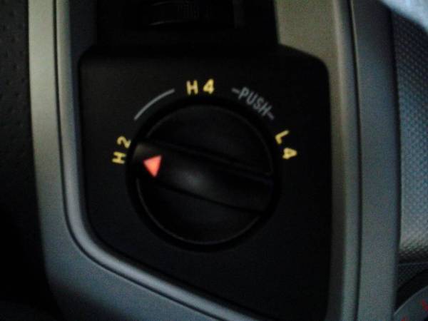

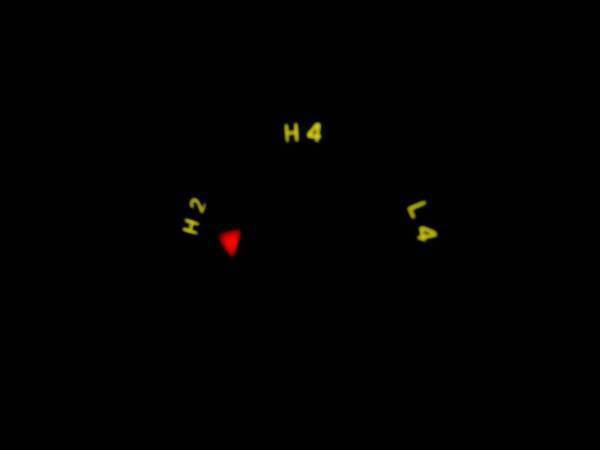

    Finally got the illuminated 4x4 switch installed, thanks RCBS204 for the group buy and outstanding product
    The lights are actually white letters with an amber arrow that matches quite well, just my phone made it look like yellow and a red arrow
    another pic with a little outside light

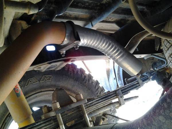

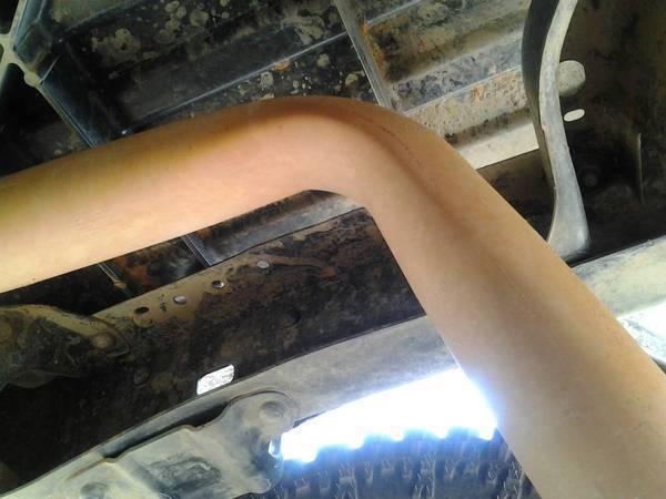

    Unfortunately during the wheeling session I did take a small amount of damage, which I thought was no big deal. I dropped into a rut and ripped off a rear mudflap, no biggie....right?? Well on the ride home I could hear a sligh rattle at stop signs and whenever I was idling. Got under the truck to diagnose and found this.
    decided to make a cut here
    doesnt look like much in the picture but that is due to my lack of photography skills. When I lost the mudflap it also pushed the exhaust up and forward and bent that last bend inwards. (The bend looked similar to a cobra that was flaired out ready to strike, round but flat if that makes sense.) I knew this was causing restriction because of the slight decrease in throttle response I felt I was experiencing. So I knew It was time to get the cutoff wheel out. Ran to the parts store and got a 45 deg elbow and clamp and this is what I came up with for a fix.
    not perfect but I believe it will do, at least it wont be in harms way anymore. I plan to grab some black bbq grill paint sometime and spray the pipe so it doesnt stand out as much but gonna leave it dumping out right there.
