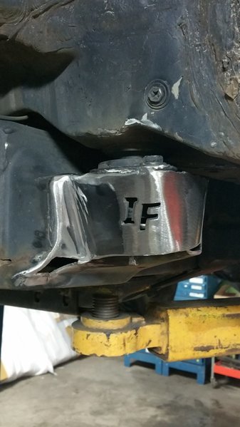

  10. Jul 23, 2016 at 7:40 AM
    #650
    TacoFMS
    TacoFMS [OP] Bubble bubble bubble pop
    Jan 24, 2010
    #29938
    7,996
    Justin
    Louisa County, VA
    Just a vehicle to take trash to the dump
    One or two things modded... Check out the build thread
    Currently happening at an undisclosed location.

  11. Jul 23, 2016 at 8:32 AM
    #651
    2ndGenJonny
    2ndGenJonny Well-Known Member Vendor
    Jan 3, 2013
    #94306
    18,457
    Jon
    Gilbert, AZ
    You must be doing this much cutting for 35s in the future
  12. Jul 23, 2016 at 8:34 AM
    #652
    colinb17
    colinb17 If at first you don't succeed, don't try skydiving
    Jan 6, 2008
    #4127
    20,178
    Colin
    Charleston, SC
    '07 TRD Sport 4x4
    Build thread in sig... 4-link long travel
    finally, someone doing a cab mount chop right the first time.

  13. Jul 23, 2016 at 8:39 AM
    #653
    2ndGenJonny
    Jan 3, 2013
    #94306
    18,457
    Jon
    Gilbert, AZ
    I run a setup that he is headed towards and i didnt need that much.
    Sure there is the do it once argument, but if youre not doing 35s, no need to hack it up that much IMO
  14. Jul 23, 2016 at 8:45 AM
    #654
    colinb17
    Jan 6, 2008
    #4127
    20,178
    Colin
    Charleston, SC
    '07 TRD Sport 4x4
    same amount of cutting and welding to cut off a small portion or the amount Justin did. really no structural loss between the two if you plate it up right.
    so if it's the same amount of effort, and there is no downside, why not got for it the first time. even if you're planning on 33s, you never know when you'll want to go up to 35s. just my $0.02

  15. Jul 23, 2016 at 9:03 AM
    #655
    TacoFMS
    Jan 24, 2010
    #29938
    7,996
    Justin
    Louisa County, VA
    One side done!
    ajohnson and Slimwood Shady like this.
  16. Jul 23, 2016 at 9:04 AM
    #656
    TacoFMS
    Jan 24, 2010
    #29938
    7,996
    Justin
    Louisa County, VA
    Exactly this. No 35's in the future of this truck. Just figured might as well go big or stay home.

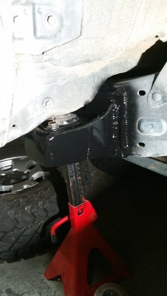

  20. Jul 23, 2016 at 10:43 AM
    #660
    2ndGenJonny
    Jan 3, 2013
    #94306
    18,457
    Jon
    Gilbert, AZ
    It appeared you were cutting a lot more. But you have as much as i do.
    This is what i thought you were doing
