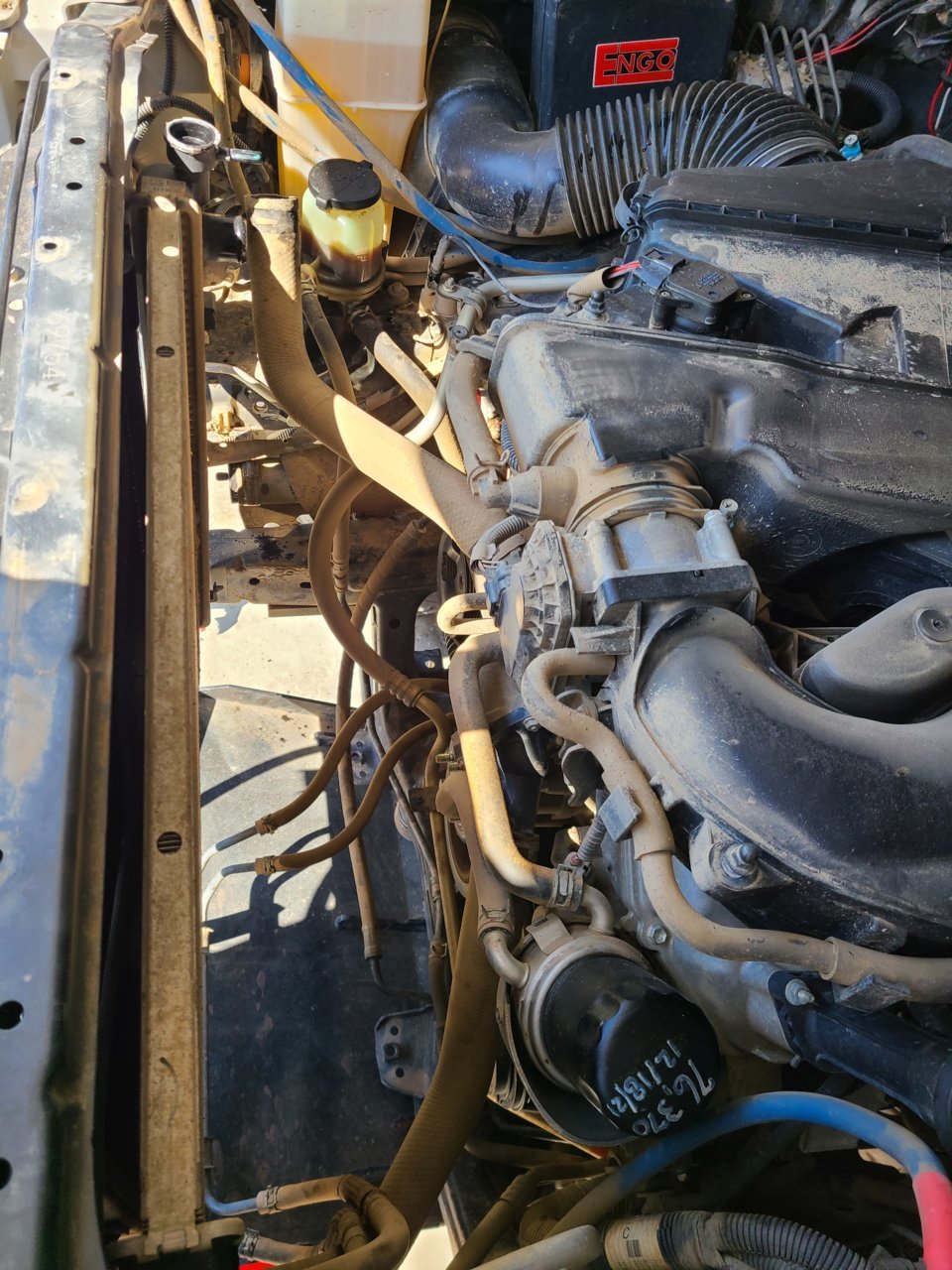

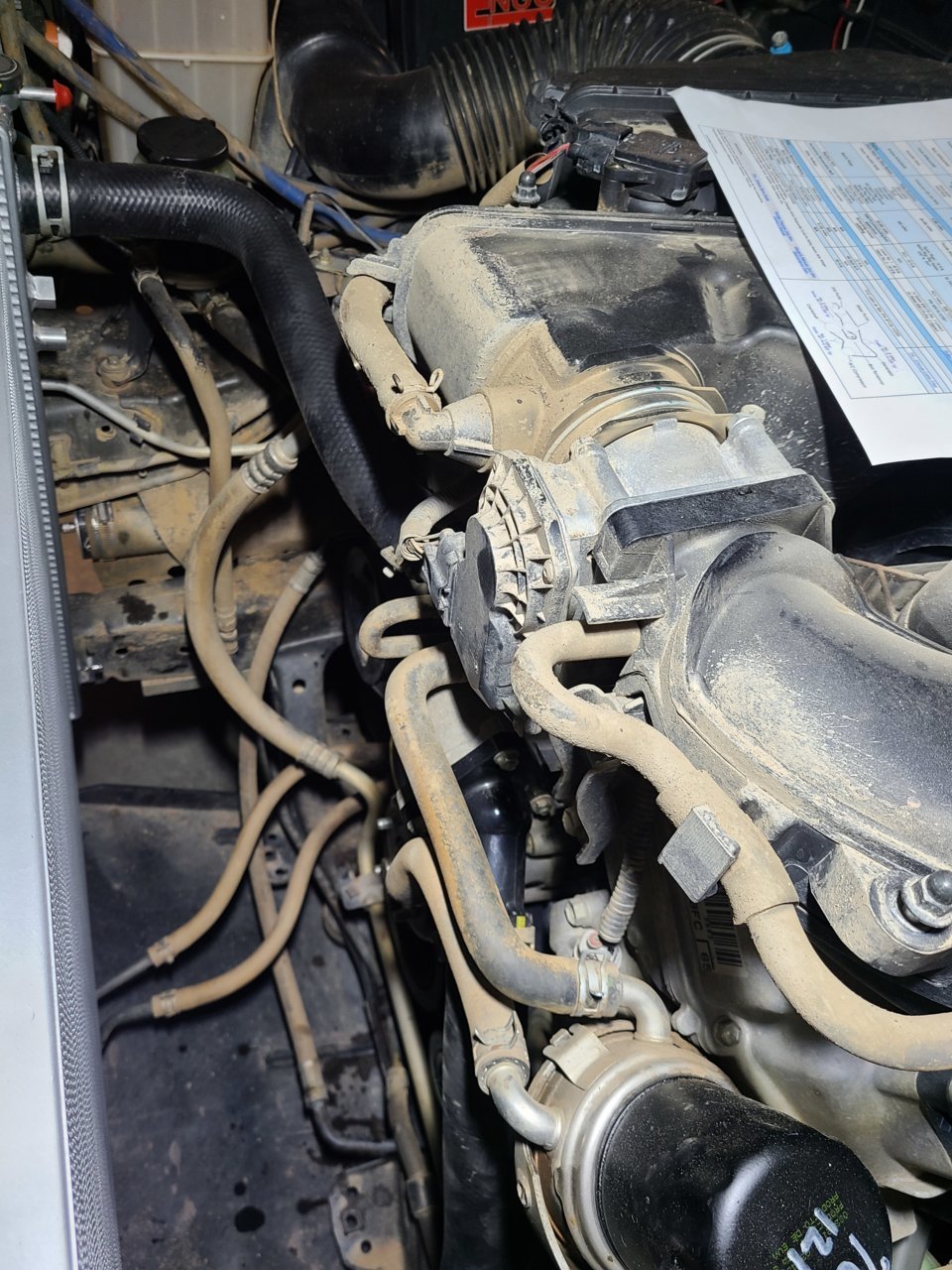

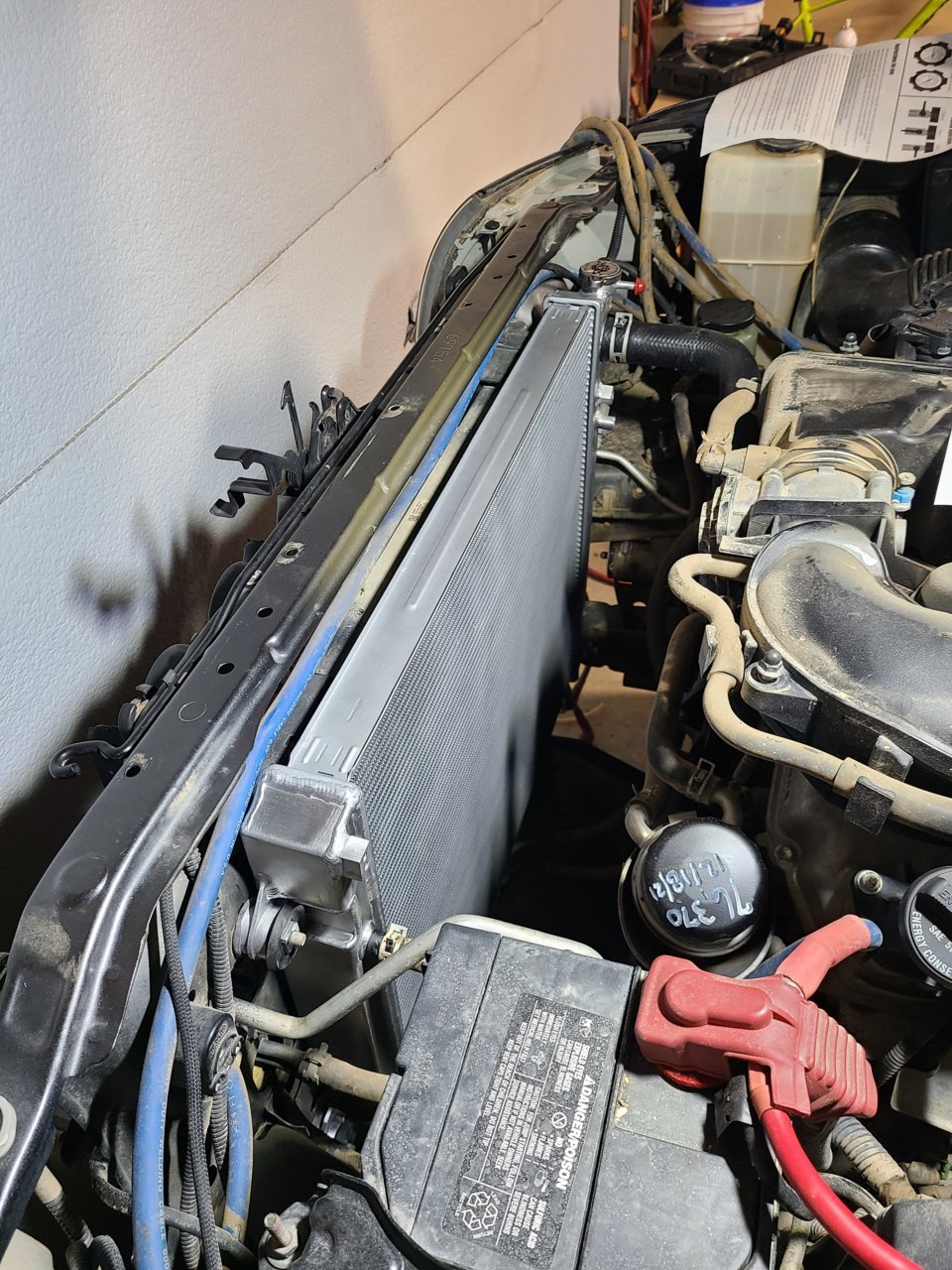

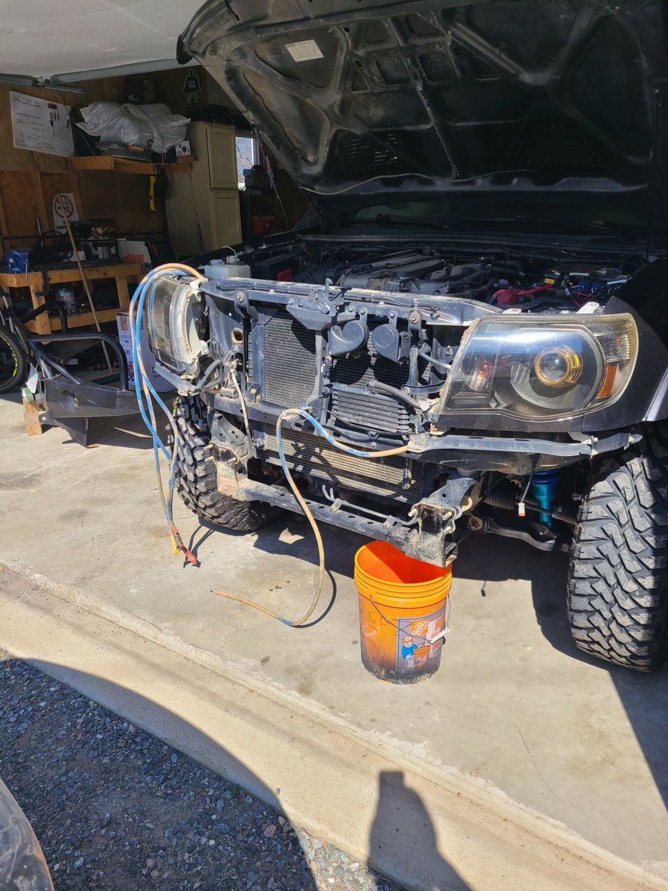

    Was a beautiful weekend this weekend. So I decided to take advantage and knock out a project or two...
    Dropped the bumper. (No fun at all by myself, but oh well. It has to happen.) Then drained the radiator and the block.
    Removed the old upper and lower radiator hoses, stock radiator, stock thermostat and housing as well as the original water pump and idler pulleys.
    Installed a new CSF radiator, Mishimoto 160 degree thermostat and new housing along with a new Toyota water pump and upper and lower hoses. Also decided to replace the idler pulleys while I was in there.
    Had decided to pull the trigger on a new tool purchase as well a couple weeks ago. Picked up a vacuum coolant fill tool. It hooks up to compressed air and pulls a vacuum on the entire cooling system. (Which also allows you to check for leaks.) Then you just put the other tube in a bucket of new coolant and close the vacuum valve and open the fill valve and it automatically pulls the new coolant into your radiator and block. It is supposed to eliminate all air pockets that can form when refilling your cooling system. Seems to have worked quite well. Also made it very nice and mess free when filling up the radiator.
    Ever since I purchased this truck new it has always run a bit hotter than everyone else's trucks, plus tends to run hot on trails. (The main reason I cut holes in the hood last year or so.)
    After completing all the work I started the truck and let it idle to temp. It came up to around 160 and after revving for a bit it seemed to max out around 165 or so, but then came right back down to about 158 when left to idle again.
    So it definitely seems like a win to me! Plus gives piece of mind with the maintenance aspect of new pump, pulleys and hoses. Not to mention a new belt and fresh coolant.
