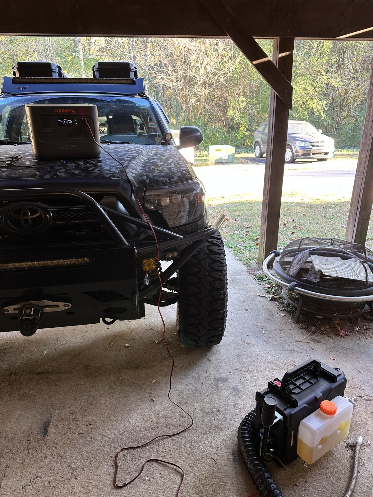

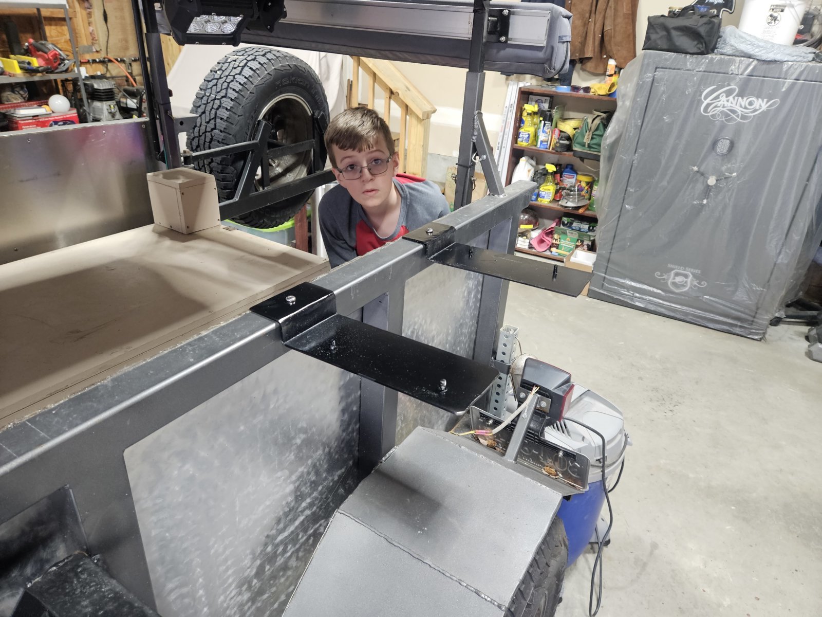

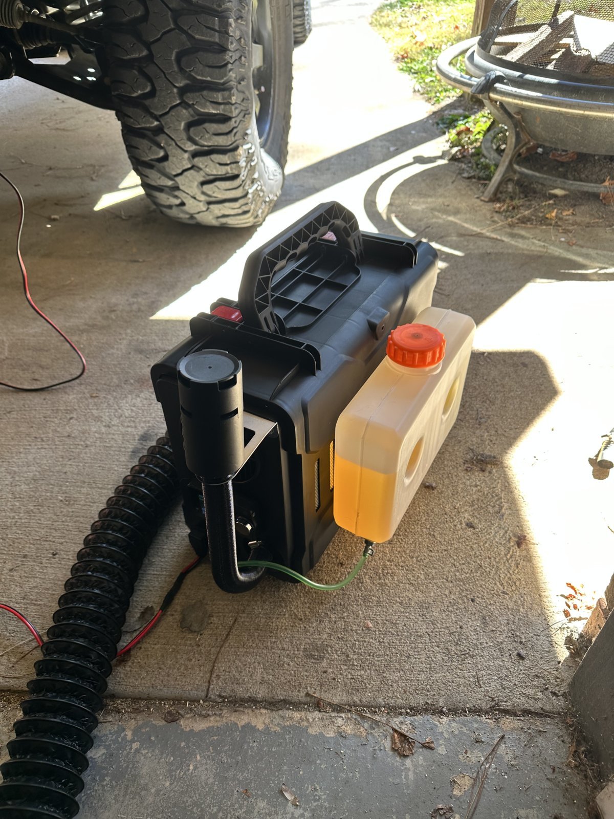

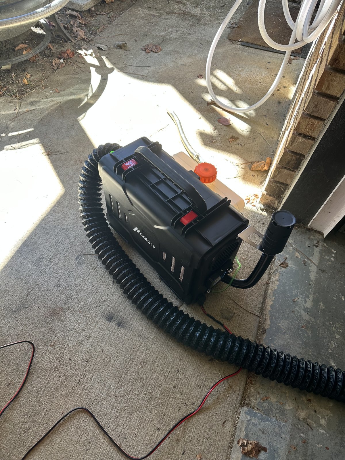

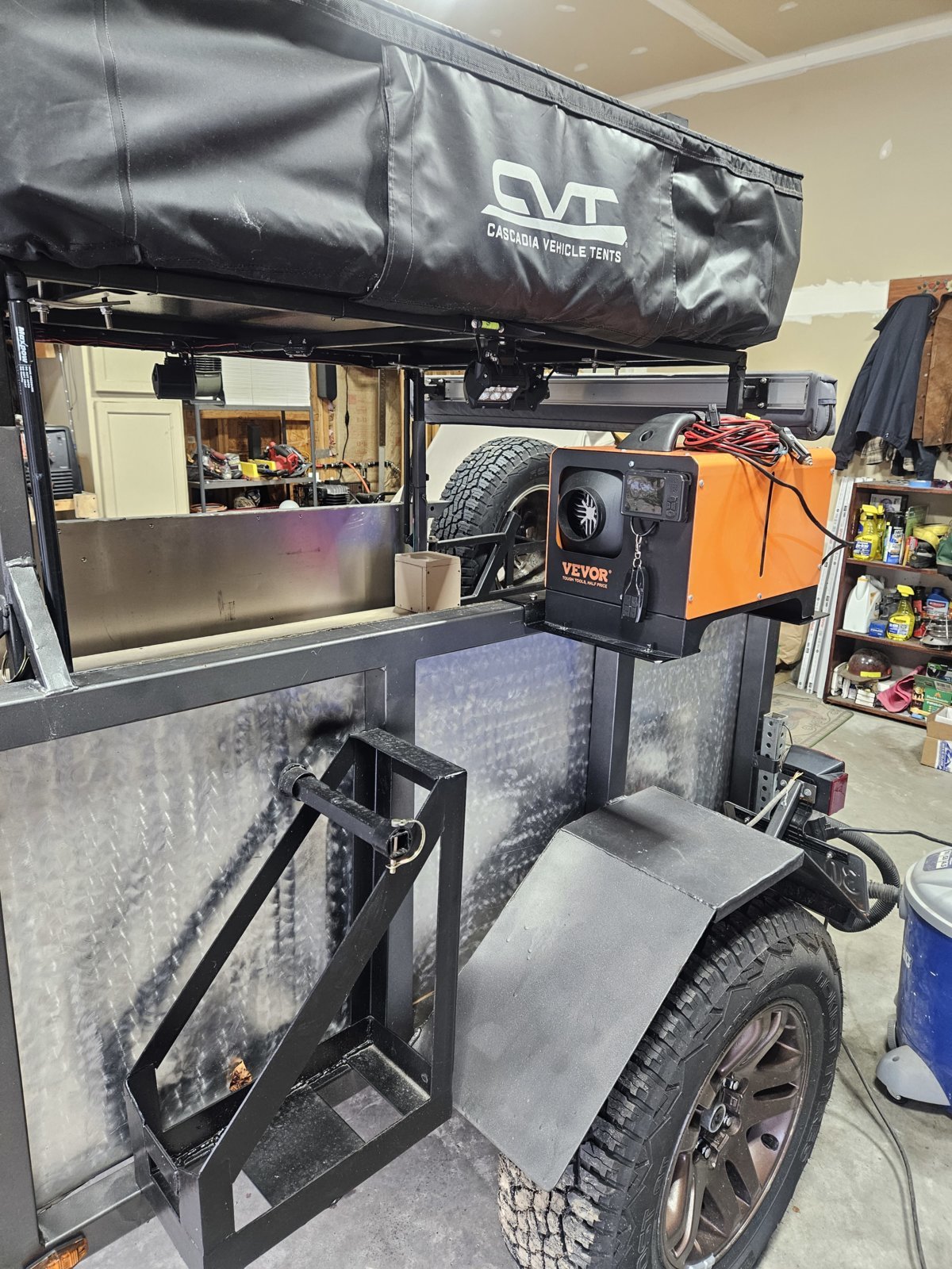

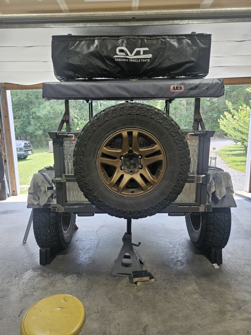

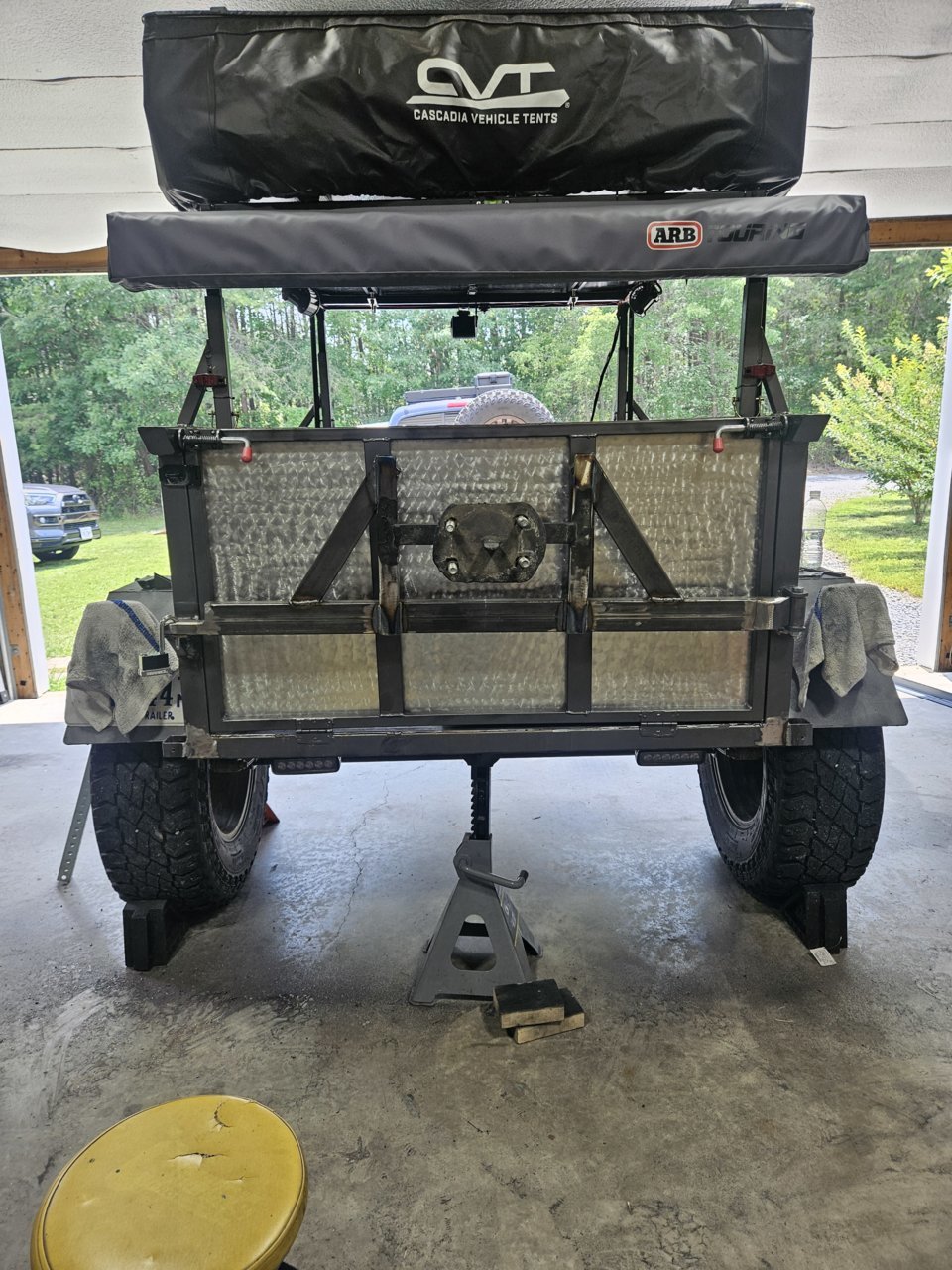

    Got a diesel tent heater (because I'm not camping while freezing all night anymore) and worked on making so brackets to hold it while in use. They will be removed during travel and the diesel heater packed up.
    Put some rivnuts in the top of the trailer rail to hold them in place.
    Seems to hold it with very little sag while having about half a tank of fuel.
    This will make it easier to plug in to the house battery as well as to direct the heater exhaust away from the tent and the hot air output directly in to the tent with an attached hose.
    Might be testing it out next weekend, depending on the weather.
