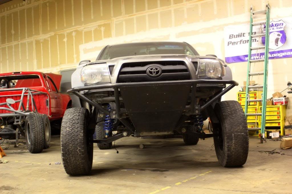

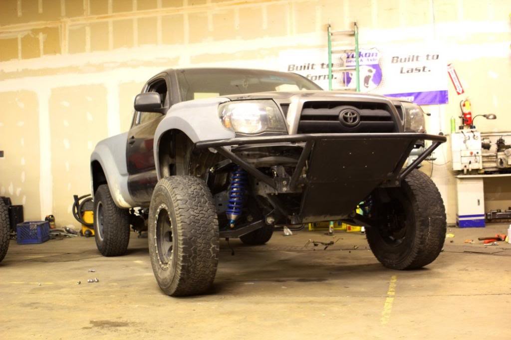

    More updates. Should be driving it by this evening depending if the heims show up or not

    Gotta get some action shots up!
    Lots of preload or is the spindle lifting up the front so high?
    Gotta get some 50T leafs for the rear to balance it out :cool:

    i have absolutely no preload in the coils at all. im running a 600 lb up front with a .20 on the compresssion and a .12 rebound. Thats what came in the 8"s when i bought them and let me tell you what, since im not running bumps this thing is smooth as hell. i have about a foot an a half of ground clearenace so its super nice not worrying about hitting much of anything at speed. ill end up keeping the 600s and the 20 up front probably.
    as for the rear, it leveled out quite a bit. that picture was after the drooped out the front and were replacing the tires. the 35s clear everything as well and no rubbing up front. only problem is the tire rubs on my driver side rear bypass. looked like the 1.5 wheels spacers are getting throw back there. other than that.... gotta start saving for that cage.

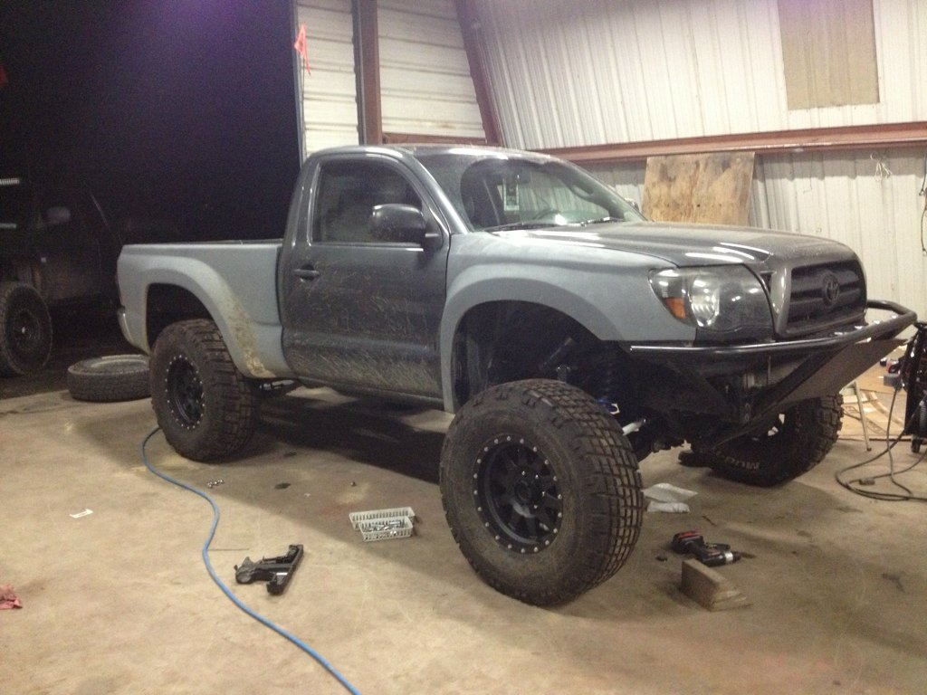

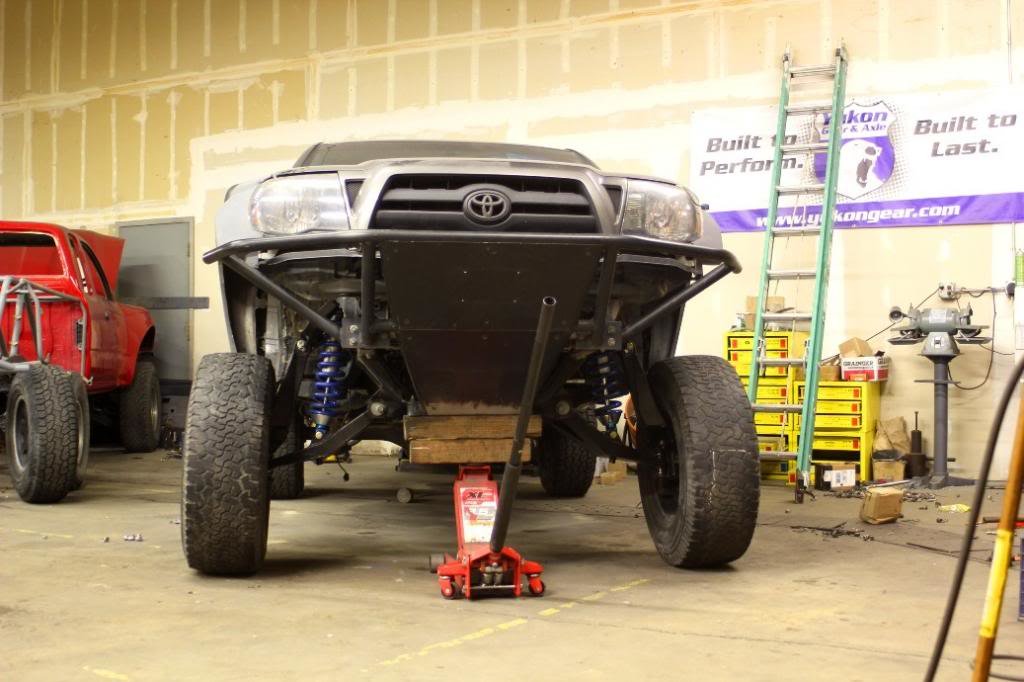

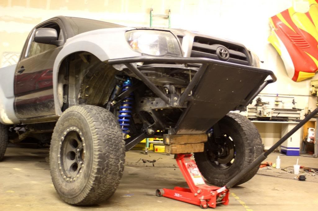

    :eek: Your skid is falling off! :p Jk, nice work though. Looks great.

    yeah only problem is that the rear tires are already wider than the rear glass sooooooooooo i dunno what to do about that one haha
    as for a cage... im thinking if im going to cage it....... i might as well link it. :anonymous:
    hahaha i know! its all secure now. good ol engine hoist as a jack :thumbsup:
