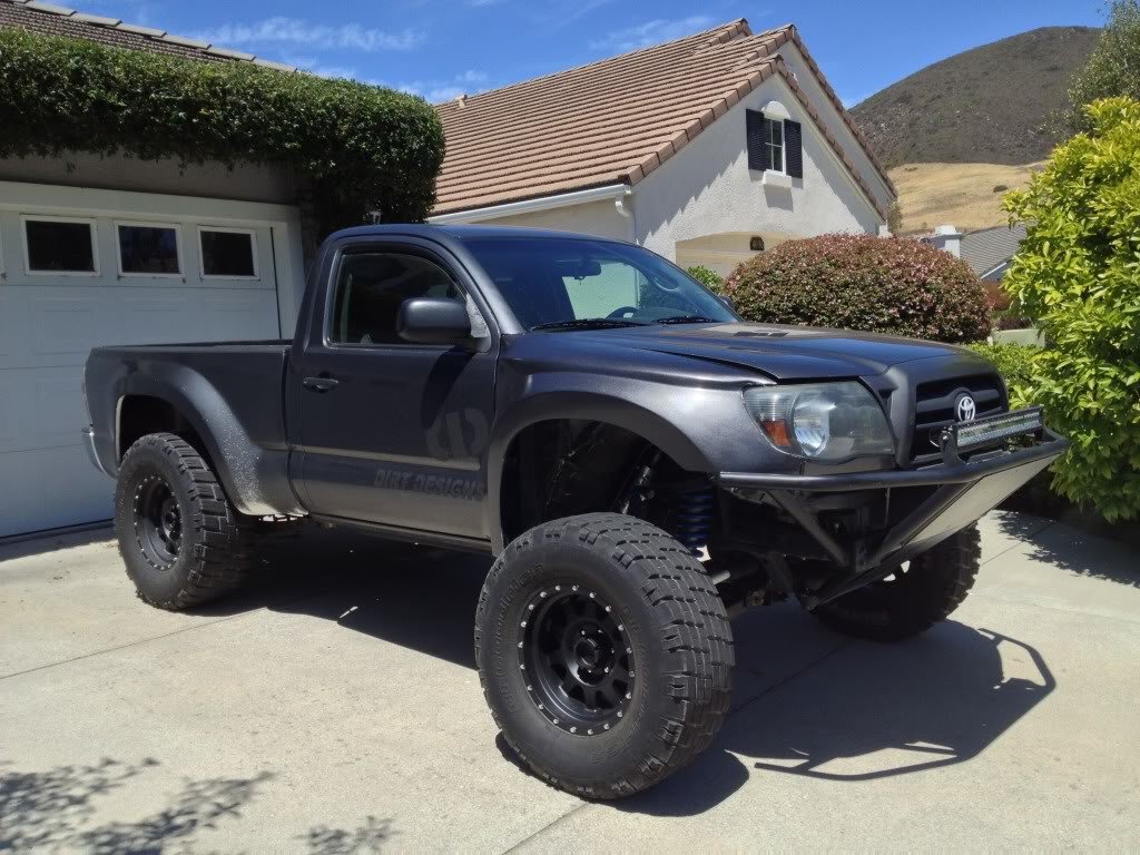

    i dunno if this is me or not, but does this picture make my truck look way bigger than it really is? im thinking its the angle and the fact im at the bottom of the drive way. haha.

    i went and finally got my backspacing on my wheels right. they were originally at 4.75 and now are at 4.50. now that thats fixed, the rubbing on the spindle is completely gone and im hoping that it helps with the tires rubbing on the bypasses. and may of you know that 4th of july is coming up. im gonna try and see if i can replace my front wheel bearings, TC lower cam tabs, rebuild my front shocks, repaint my front kit, and maybe if i have time, do the UCA double sheer.

    guys does my driveway make my truck look fat? yes it does, good thing i like me a fatty.

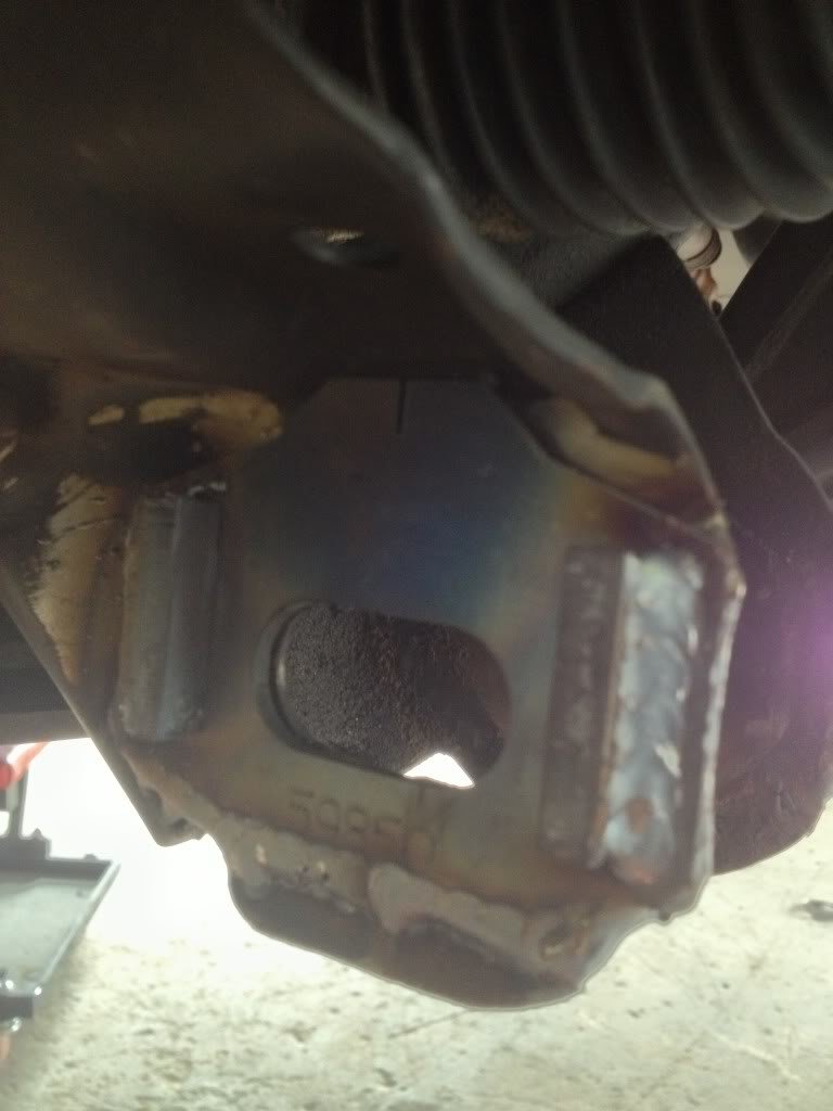

    DTF anthony and i took the front end apart on sunday to put the tc cam tabs in. let me tell you, every second gen should do this.

    And every 1st gen too :)
    Looks good B, a lil more piece of mind.

    now im not so worried pullling the lowers off the frame :p

    It's still possible to bend the LCA mounts and/or rip them off the frame.

    kinda a reason why i threw in the word "so" hahha. before the front mounts were already bowing back and getting pretty sketchy looking. needless to say, piece of mind knowing that those little 1/8in tabs that i used to have, arent there anymore :D

    I'd recommend welding the inside of the LCA Mounts as well as they only come welded on the outside from the factory.

    great suggestion max, thanks.
