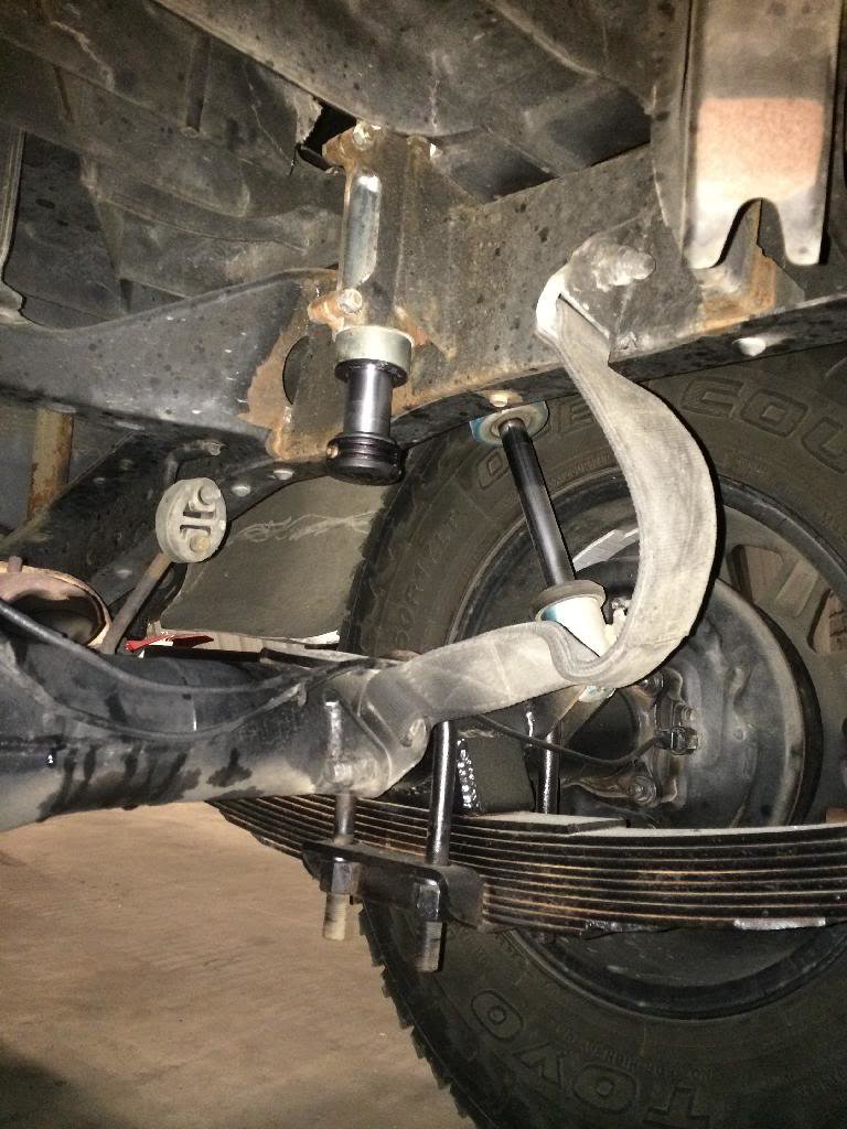

    welp... i shortened up my bumps in the rear. Im really happy with the results as well.
    D9CDFFD2-45F6-4BF4-A0F9-8169BF829130_zps_32e05460508460e880f186bc6a65e2858bb9fca5.jpg

    Curious. Why'd you shorten them?

    So he isn't riding the bumps all the time.

    like kernel said, so im not riding on the bumps all the time. im already limited with up travel (~6in) so i was only 2in from hitting bump. Now theyre shortened to 2", i can mess with the comp tube for once since the bump zone is a lot shorter and not interfering with the compression tube when it cycles. it helps with not hitting bump on little stuff.
    i
    i really need a pack with more arch.. then all my problems of the super bruh lean with not up-travel will be gone. :bananadance:

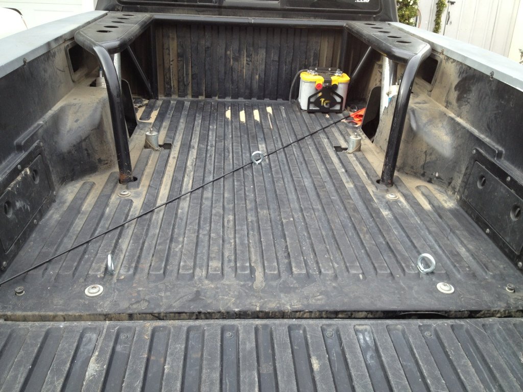

    I can't find the picture of the inside of your bed. You have one of it still?
  17. Feb 27, 2014 at 10:19 AM
    #1457
    tacokid09
    tacokid09 [OP] it's about the off-road miles
    Mar 5, 2011
    #52405
    7,068
    Brian
    San Luis Obispo, CA
    2010 Tundra
    yep!
    unloaded
    534CA86D-ADA4-4423-8CDD-E0877A4F407E-393_c0baef00a9158c2fa36a94bcf13810506475b57b.jpg
    loaded
    A426D2A9-6271-431A-831A-B22CBD5ACAF3_zps_c24f6d23a9f9dadec56817c4ae124e99200868b6.jpg

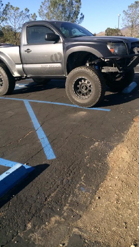

    well im back working as of last week after not being able to since mid december.
    Trucks still goin strong though. Nothing major has happened besides little maintenance here and there. Im also wanting to sell my Rigid 30" if anyone is interested.
    i laugh everytime i see someone staring at my truck in the handicap spot :rofl:
