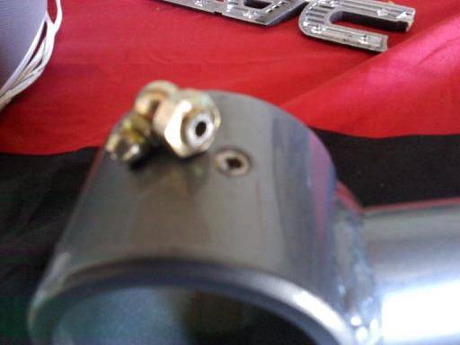

    Do not worry. I had the same problem
    1) Kragen carries them. Just get the 90* bend
    2) Start with very small drill bit and drill through. Use progressively larger bits, but not so big that it drills the threads
    3) Eventually you'll be able to peal the broken part out.

    Bummer man. That isn't too big of a deal tho. Just get those threads out of there and pic up another on from NAPA.

    phew.. no i wish i just never sold me wired drill :cool:

    but really, i cant find the charger for my battery soooooo i have to wait for my friend to get off his work so i can drill away...... maybe ill go get a zerk right now. its just standard size or what?

    Yep. Take one of the other ones with you to match up. They come in a box of 1000 or something, so you'll have a few spares.
