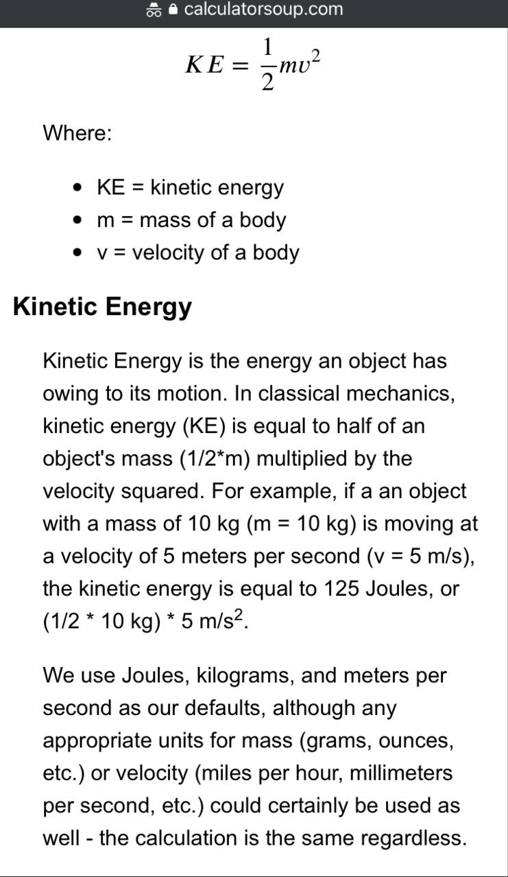

    Apples and oranges there. Two tacos colliding head on with both going 60mph would essentially be equivalent to one taco going 120 mph hitting a stationary taco head on.

    not quite, the relation to speed is not a linear curve 120mph is not twice the energy as 60 mph, its 4 times the energy, because the equation is mass times velocity squared, not just mass times velocity. A 1 pound mass at 60 feet per second has 3600 foot pounds of energy. A 1 pound mass travelling 120 feet per second has 14,400 foot pounds of energy.

    You’re correct. I should have done the math.

    Exactly. Hate to be "that guy", but the underlying discussion with relevant calculations should be using collision (derivations of elastic and inelastic) equations (m1iv1i + m2iv2i = m1fv1f + m2fv2f) to determine usable force dispersal through both vehicles - these would give tangible numbers to show the amount of energy being distributed here and "where" it's going. Kinetic energy is just a marker (like acceleration, velocity, mass, etc.) used to quantify physical objects moving in space - once collisions are involved there are different equations and variables required.
    That being said, it's a very impressive display of engineering here (with the implementation of crumple/crash zones in the Tacoma structure used to mitigate occupant trauma) that with all the forces involved in this accident and the severity (based on pics) of the collision that there is "only" a broken foot and some stitches as the outcome. The engineering and design used to "slow" the negative acceleration (deceleration) for the driver and passenger is something to behold, and something that had we seen this same wreck 10-15 years ago would likely have had a different outcome.

    You are even more correct lol. It’s not a simple matter of calculating kenetic energy as I looked into it more. Conservation of momentum, elastic collisions vs inelastic, energy dissipated in the form of heat and sound all factor into a collision.
