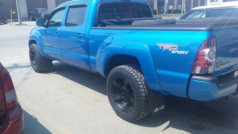

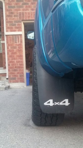

  13. May 10, 2015 at 3:16 PM
    redz80
    redz80 Well-Known Member
    Mar 21, 2010
    #33649
    298
    Brampton, ON
    Tacoma SR5 TRD 4x4 SWB
    265/60R18 0.0 offsetCAM01166-1.jpg CAM01155.jpg
  14. Mar 2, 2016 at 5:17 PM
    Hriggs2
    Hriggs2 Member
    Jan 24, 2016
    #175955
    7
    Hunt
    2015 black Tacoma trd
    Stock
    Truck looks awesome man, I have 2015 taco black as well. What rims are these what size tires and if you don't mind what was the cost. I'm in the same boat I don't want to lift or level but I want a similar look. 3018877475 text if u would like.

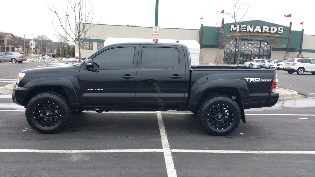

  16. May 5, 2016 at 5:14 PM
    #16
    Hriggs2
    Hriggs2 Member
    Jan 24, 2016
    #175955
    7
    Hunt
    Stock
    I have 18x9 xd grenades on my truck now with nitto Terra grapplers 31" tire, fits nicely I removed all mud flaps and did some trimming, instead of a lift or level
