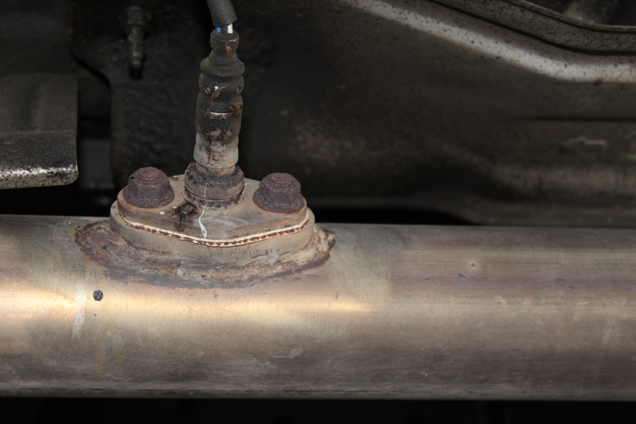

    this is what it looks like if you're curious
    somewhere the plastic bag of parts did not make it on camera

    @vettehigh, here's that pic
    looks like the nuts were re-used, after just one mild winter and new ones should look 'newer' than these do
    i may have sprayed FF on them before winter but if these get roasty that will just burn it right off :notsure:
    so i will say not included with the kit
