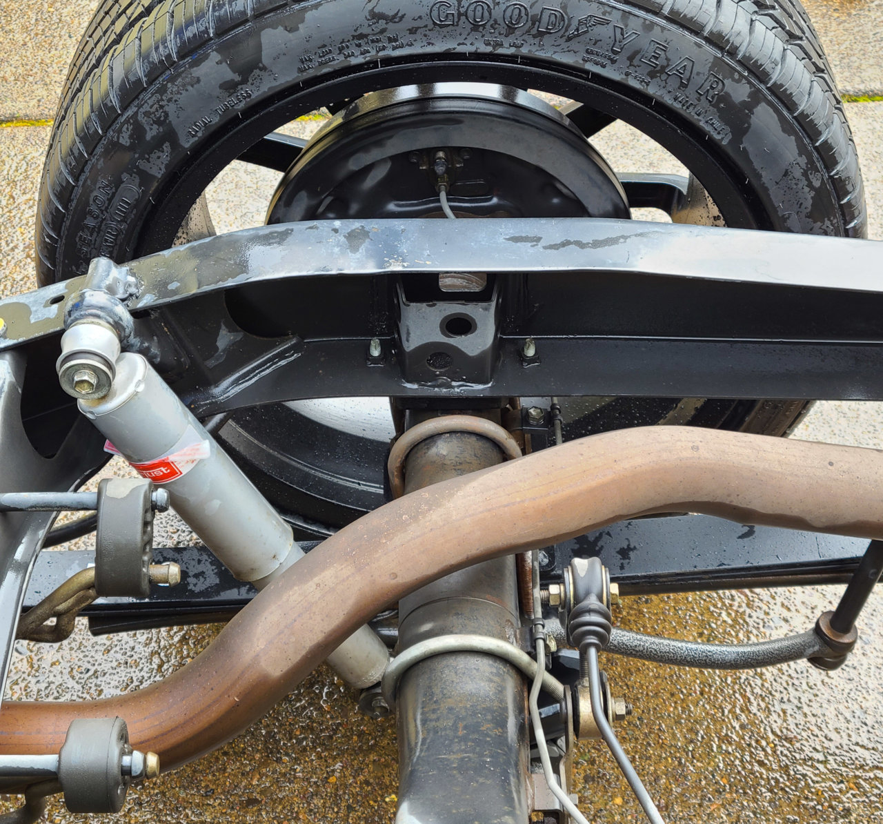

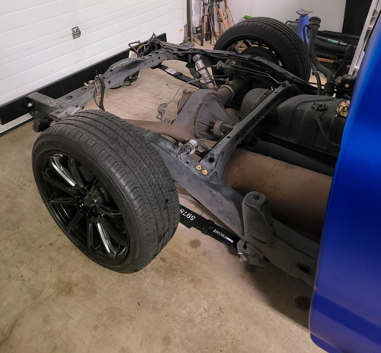

    You can only lower a first gen tacoma a couple inches in the rear before your axle begins hitting your frame.
    I was unhappy with the stance and the tire gap. It was c notch time!

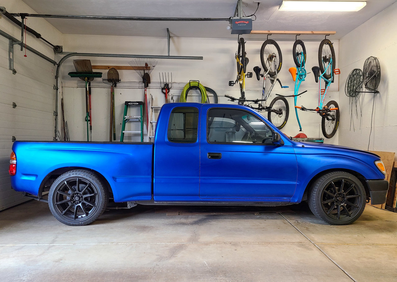

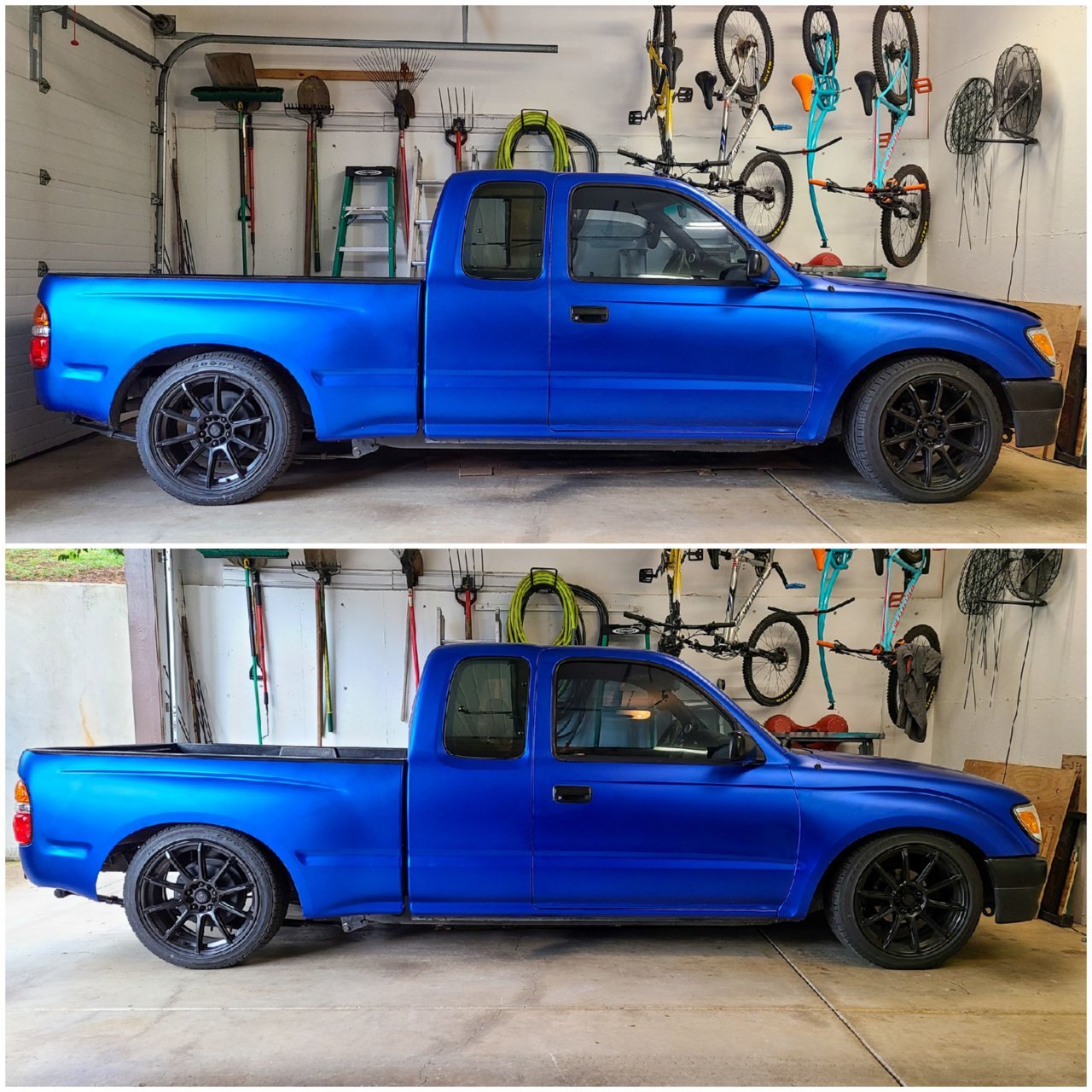

    C notch complete. Tire gap gone.

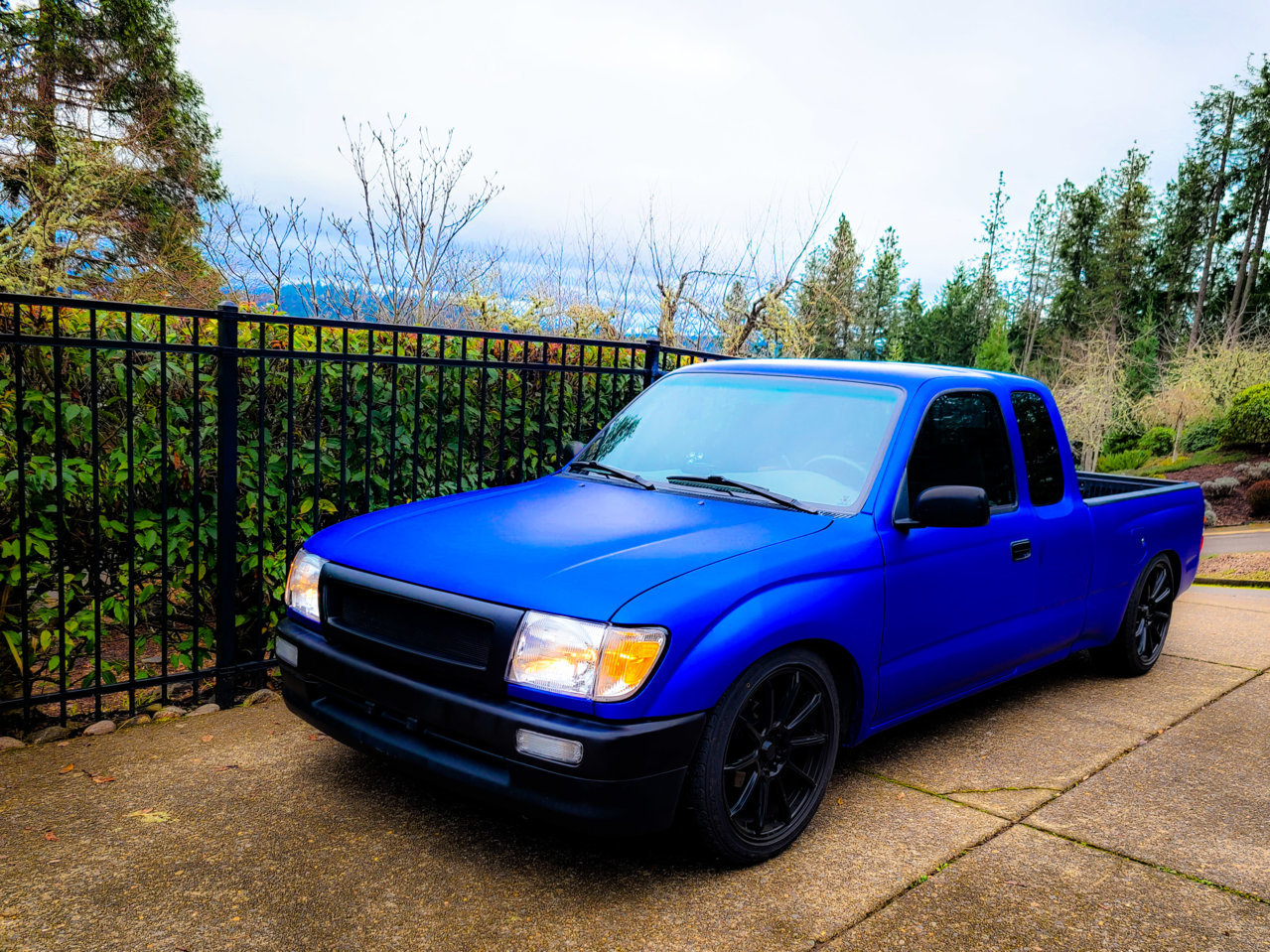

    Is that a wrap or plasti dip?

    Love the new level!!!!!!

    They are belltech 5978
