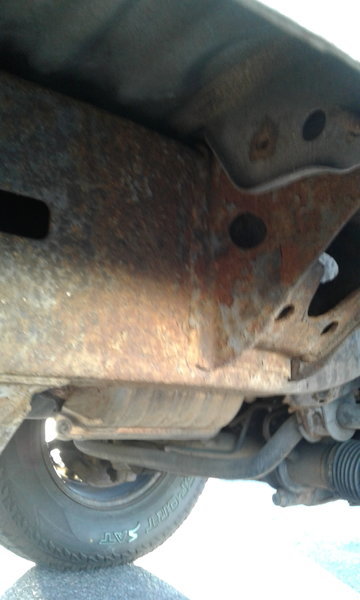

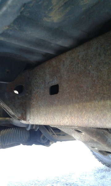

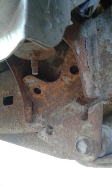

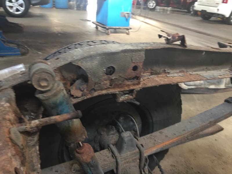

    Ok so yeah it is extended for CA trucks for sure 15 years and Im pretty sure you didnt need to get any undercoating or anything because it wasnt offered. Also they said although its a lot of rust its surface rust. They hit it with a hammer and said no holes so no new frame. Just tons of surface rust.. Called customer service and they wont do anything unless a 10 mm hole is in the frame. So what should i do. I have until August 20 to find a 10 mm hole in the frame to get it replaced. Otherwise im stuck with a severely surface rusted frame. Should i make it rust a 10 mm hole or just let waranty lapse and maybe have problems in the future? These pics are about the average rust that is everywhere on the frame.

    how about you just knock the rust off of it and paint it with por-15, inside and out? I mean it doesn't look bad to me for something that old that was never coated and sits on the bottom of a vehicle exposed to the elements.

    if Toyota will not coat it, sand or blast it and coat it yourself. or get it professionally done. the fact there is no holes means you have a good working canvas to do whatever. it's been over 14 years and no major perforations, I'd say your frame will hold up. mine has been good due to me coating it in used oil every year (which I haven't done since they coated it as part of the TSB)

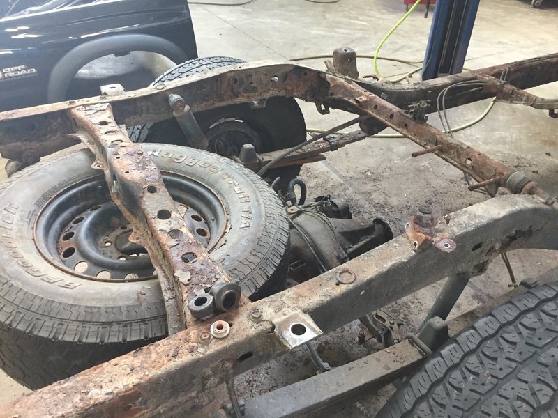

    that frame looks pretty good to me! heres mine during swap and it wasnt that bad, just had a few decent sized holes.IMG_0344.jpgIMG_0345.jpgIMG_0346.jpgIMG_0348.jpgIMG_0349.jpg

    Using a needle scaler is probably the best bet for removing rust. Your frame looks almost exactly like mine.
    Since you've posted on here, I wouldn't make a hole if I were you. Evidence...fraud...blah blah blah.
    We're in the same boat. Remove the rust, coat the frame. If it hasn't succumbed to the cancer yet, theres a good chance it's not happening any time soon
