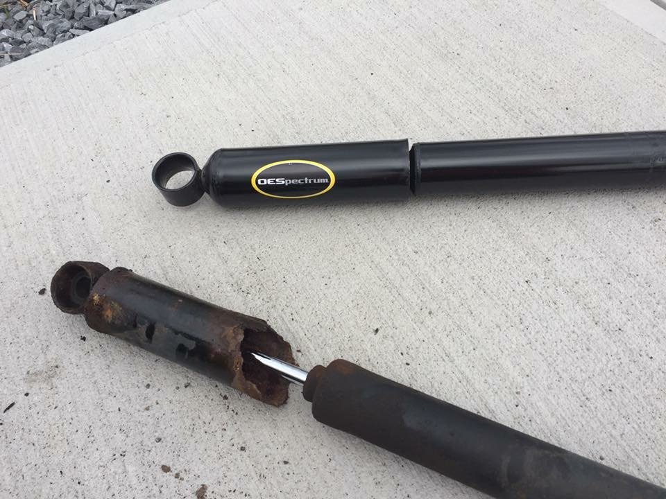

    Crawled under the truck today and found this
    I have the extended 15 year warranty on my frame and booked a frame inspection later today. Not sure if this is enough for a new frame.

    I bet it is. That spring attachment is serious -

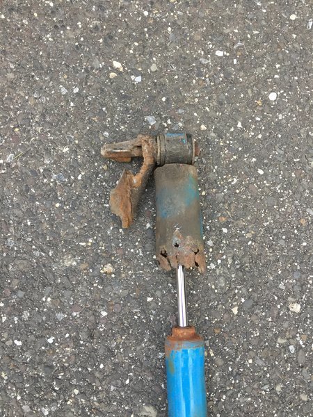

    This is all that happened to mine - heard some clunking and noticed shock was loose at top. Took it off at bottom and when it came down had some frame on it. Waiting on replacement frame now.
    Good luck I hope you get it.

    Wow I got lucky. Dealer let me drive away for now, but are pretty confident that Toyota will approve the new frame. My rear shocks are rusted away like that as well, looks like Ill be ordering parts soon. Dealer said they will put parts on that I bring in so thats a plus.

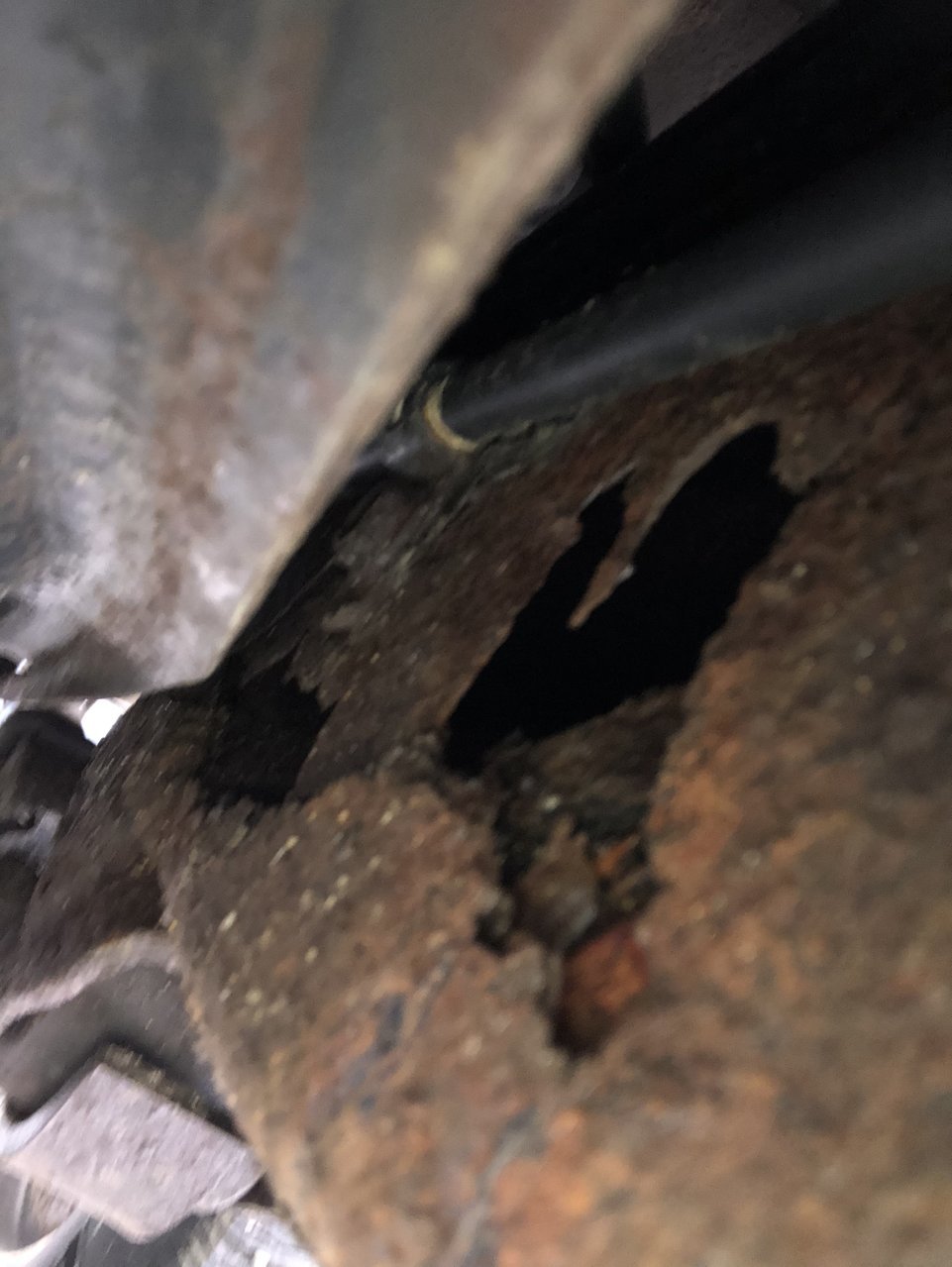

    GREAT DAY,called Toyota AGAIN on Friday about the hole in my frame an my truck is due for inspection an I didn't think it pass and was given a completely different answer: she said after running my VIN it was in that 15Yr recall period an if my local dealership determined the frame was bad they would replace it.....So fast forward to today I took my lunch break at my local Toyota dealership an after a quick look through said they would get me a new frame, apparently some Toyotas that were coated,they're warrenties were extended an some weren't but mine is getting a new frame..They couldn't be sure how long it would take to get the frame, anywhere from a week to a month.. I couldn't be happier..Now I just have to figure what new parts I'm going to buy to have them put on,rear shocks for sure an I'm not sure what else..

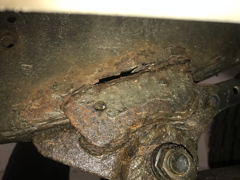

    Just contacted Toyota, I’m the original owner but the original dealership went bye bye years ago and I’ve moved states 3 times but all in the Northeast. Just failed inspection for the first41BB599E-C224-4677-B5CC-CB860E2E3AC4.jpg time. Never it sprayed or any notice fro Toyota. This is a few days ago... just had to take off the rock shield for the gas tank a few months ago and replaced the rear shocks myself, never looked between the frame and tank.

    The plot thickens... went through some paperwork and called the dealership that bought out the Toyo dealer I got it from new. Turns out the dealership I did take it to DID do the inspection... and nothing else. Have been told they should have coated it or replaced it at that time.
    We will see what Corporate says...

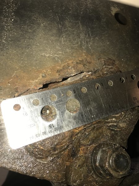

    Ok so here is the story haha..
    I'm looking at buying a 2004 Tacoma SR5 Double Cab, 3.4 V6, Auto, 4x4
    At first glance the frame had surface rust so I had it inspected at a Toyota dealership recently. They replied saying:
    "Although there definitely was some rust on the frame - there were no perforations. We hammered away but nothing actually went through the frame. This frame may just be a good one that won't actually rust through."
    They said if I do purchase it, to feel free to bring it in at any time to re-inspect the frame. They said in the future if it rusts to the point they can puncture it, they might be able to convince Toyota to replace the frame free of charge. Also said that it's hard to believe Toyota refusing the replace a rotten frame but that there's no guarantee that they would since the 04 model doesn't fall into the current replacement campaign. This service manager has helped a lot of Toyota owners get replacements for trucks that technically didn't qualify so I'm hopeful of getting a new frame if it came to that. But for any reason if I can't it would suck if the frame rusted through.
