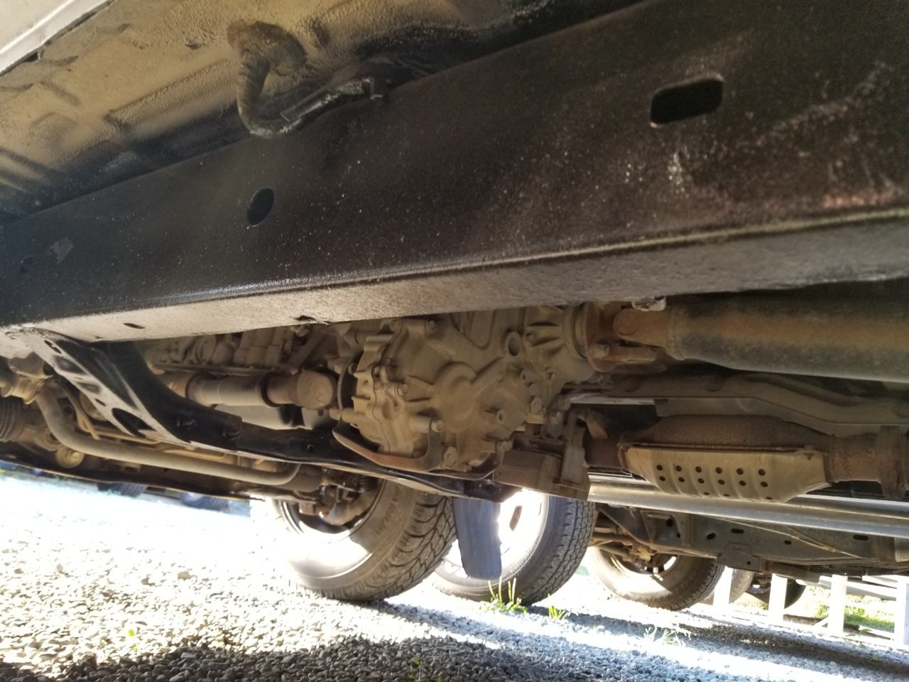

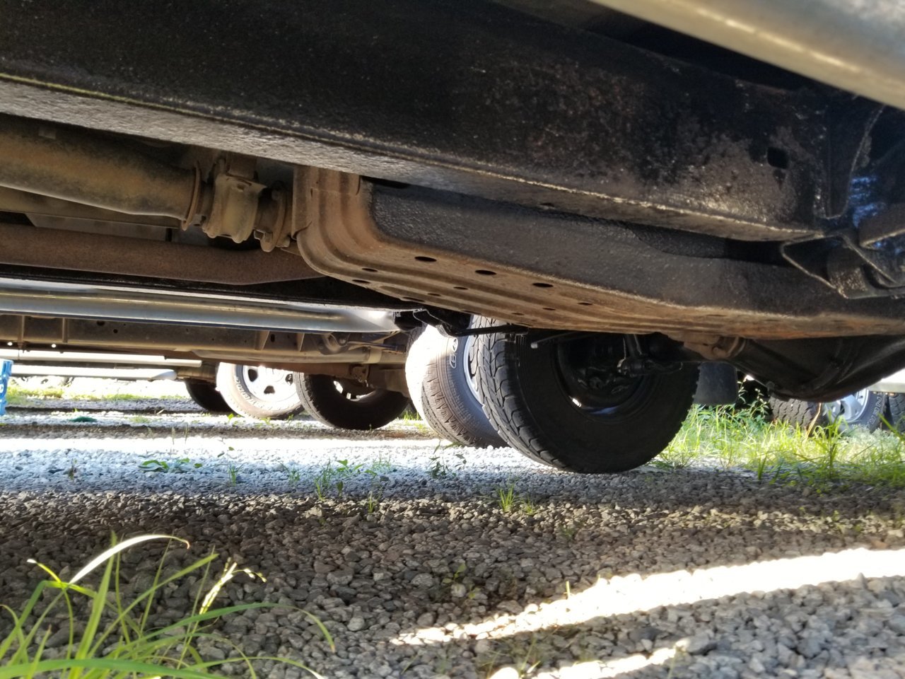

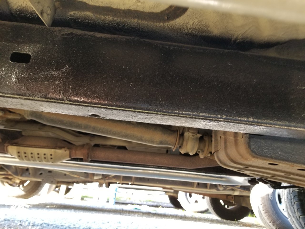

    How does this frame look? Looks solid

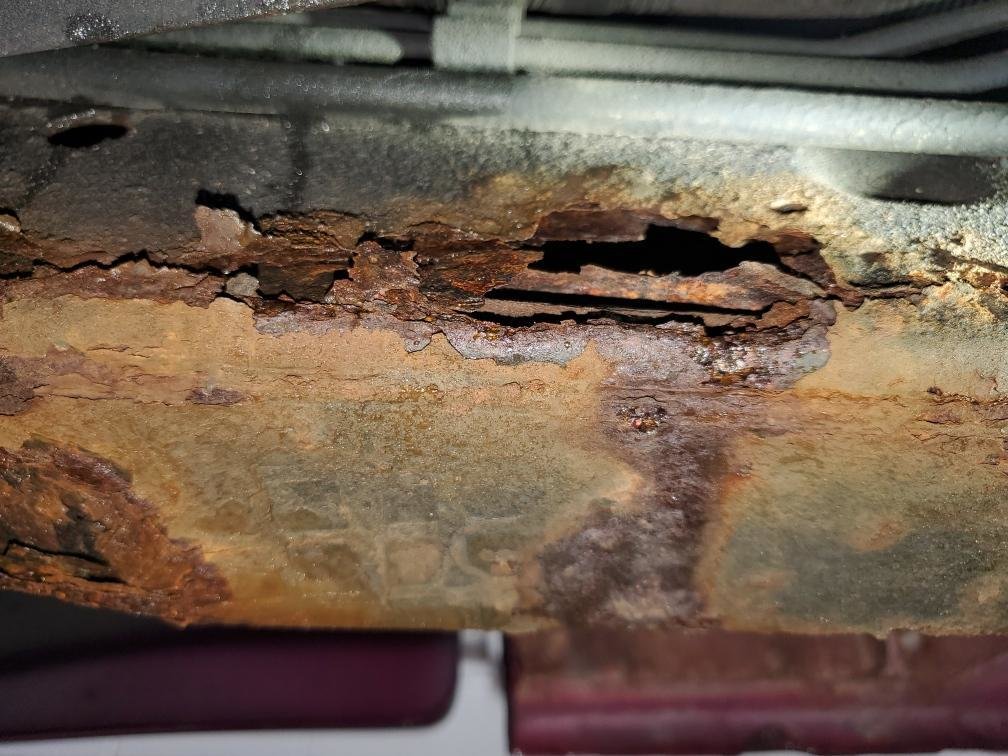

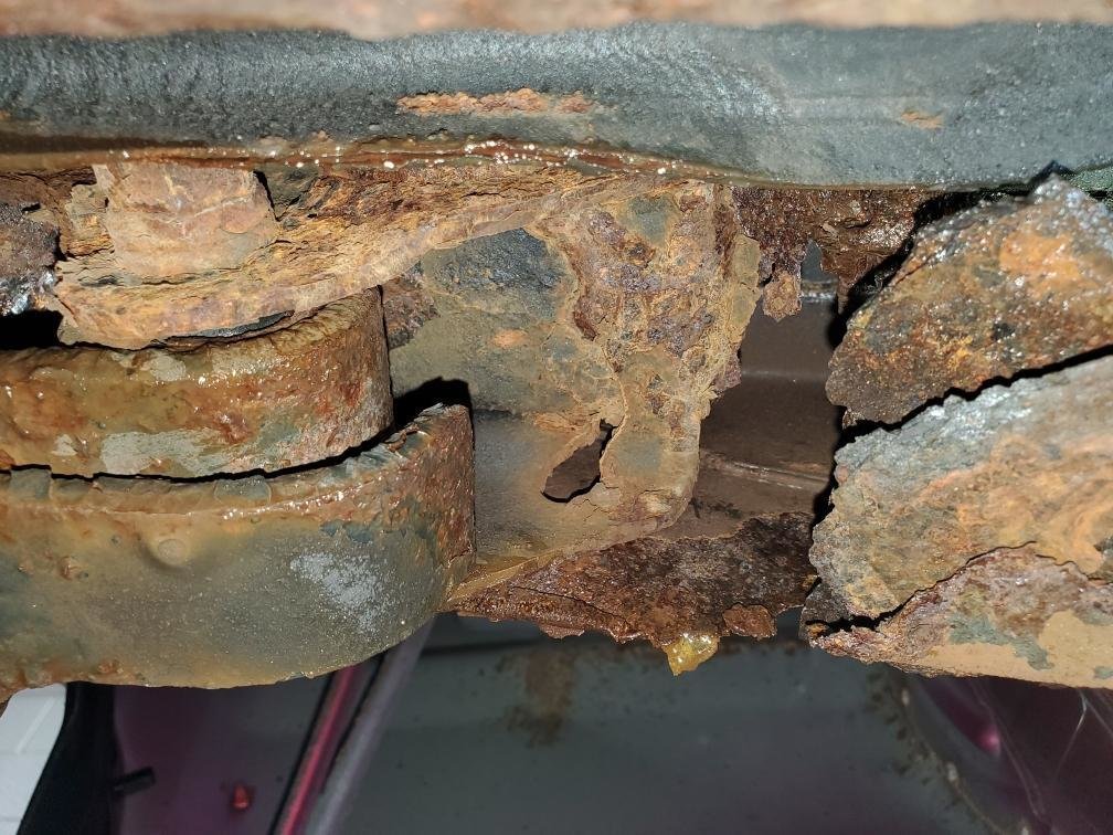

  10. Jan 19, 2020 at 5:52 PM
    #130
    JoeinMaryland
    JoeinMaryland New Member
    Jan 19, 2020
    #316621
    3
    J
    2001 Tacoma frame rusting
    Would anyone from Toyota feel safe driving this? They don't care. This is just 2 pictures of my truck. The recalls were taken care of, but they did a really bad job of the undercoating. The truck (2001) only has 53K miles, never drove in the snow and look at the cheap metal Toyota used. The Service Number 1=800-331-4331 number wasn't helpful and the supervisor Maria Puliti was extremely rude and kept trying to interrupt me when I was talking. All she kept saying is "there's nothing we can do." I asked to speak to her supervisor, she said NO, I asked what her supervisors name was and she said NO. This was as far as I was getting and it stopped with her. Speak of someone on a power trip. Is this the service Toyota gives to people? I have 3 Toyota's and by the grace of God, there will never be another Toyota to grace my driveway. My 89 Toyota that I drive in the snow has no issues with the frame that I bought new.

    Cruiserguy, pictures don't lie and I resent your smartass comment. Do you work for Toyota? I don't normally crawl under my truck and do an inspection that I deem not necessary because I trusted Toyota to have quality products. So for the last 4 years, I've been working long hours from 0 dark thirty to 0 dark thirty. Maybe you can lend me some batteries for a flashlight after I get home in the dark so I can inspect my truck. Next question...............

    Ultimately its up to the owner of the truck as to how their truck meets its demise. Does no one ever take a peek under their truck and see that its rotting away? Or ten years ago look under and fix the minor surface rust that ended up evolving into the rot? I cant help but feel unsympathetic to the people that this happens to. Take care of your things and it wont happen.

    The frame rot that these trucks experience would come from the inside out, without any outward appearance. My frame looked really good, until I poked my thumb through a soft spot. For the most part, Toyota went above and beyond what other manufacturers would have done.
    JoeinMaryland and Blue92[QUOTED] like this.

    Either way, if its rusting on the inside its got to be doing some rusting on the outside. Whats in that pic above didnt happen over night, or on a few months even. That took time.

    Yes, that is at the extreme end of the rust scale. I'll say you would have been hard pressed to find any rust on the exterior of my old frame, and the breakthrough area wasn't more than about two inches by a half inch, in the usual spot at the spring hanger.

    from the way JoeinMaryland is explaining it, he states that he took it in to get checked and sprayed in that special undercoating stuff they used, maybe twice
    and apparently did not inform him of further preventative maintenance that needed to be done to upkeep it
    it even looks in the one pic that the drain hold was completely overcoated over!!! which would explain the water build on the inside with no place to properly drain :notsure:
    more pics would be helpful
