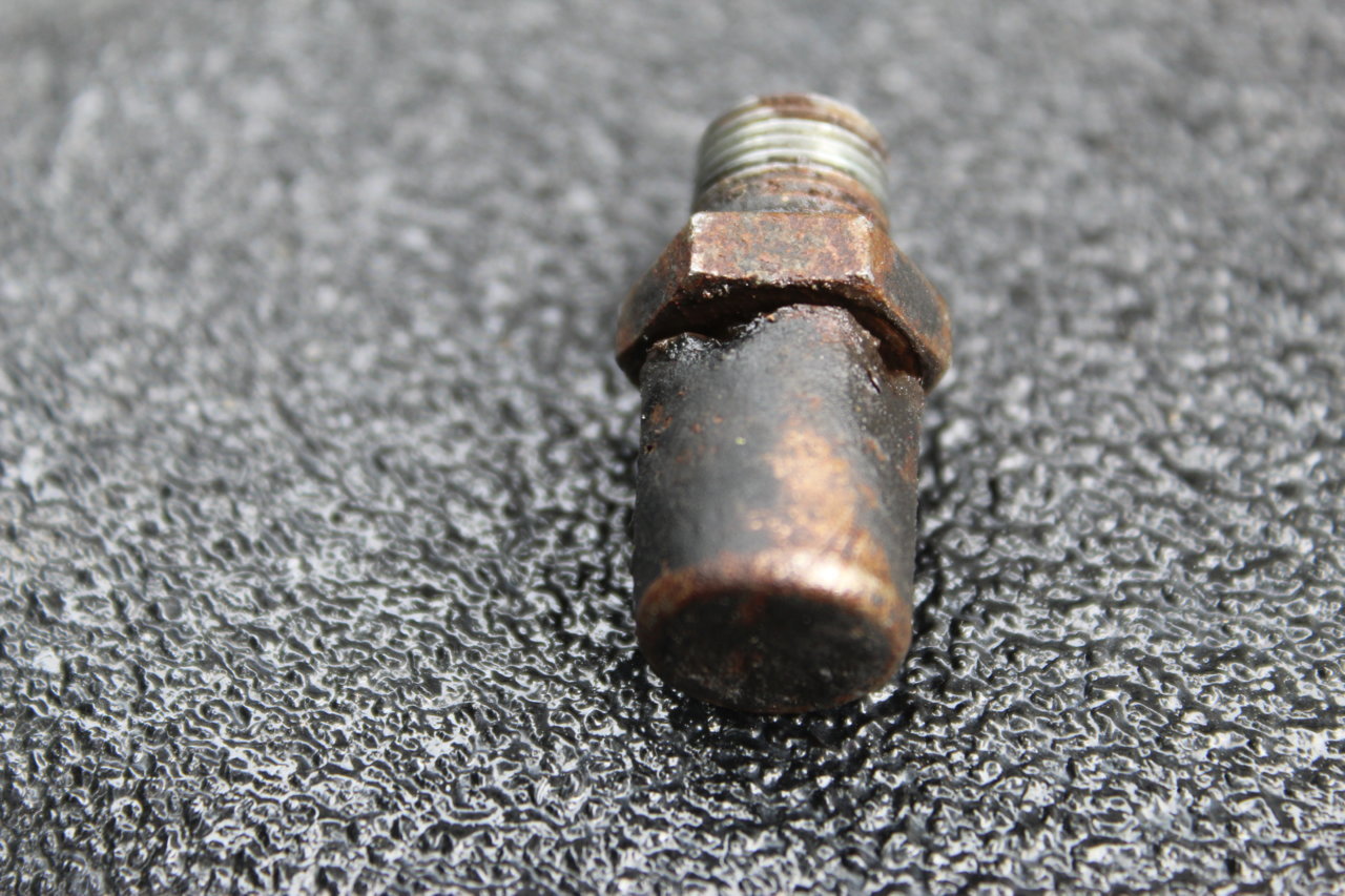

    Something not mentioned yet (or I missed it) is axle seals, look for grease or gear oil on the rear wheels rims and drums.

    change this thing to prevent that?

    Yes but make sure they have not already failed

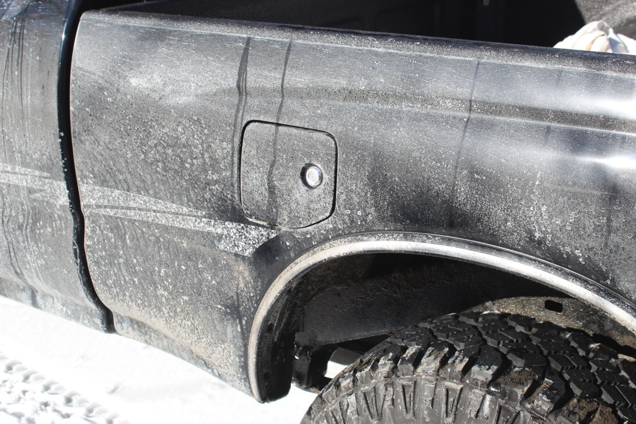

    i was gonna try the woolwax on that splash area in the rear wheel well i had issue with FF not sticking well at all on naked steel
    i must routinely power hose the salty winter slop out of my wheel wells in the winter to prevent body panel rot in the fenders and tailgate area, that is a major issue in my area!
    and i hose it hard, full-blast spot-free rinse
