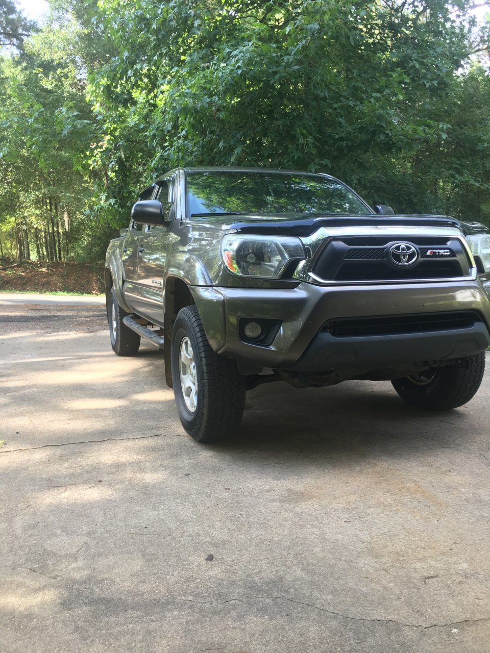

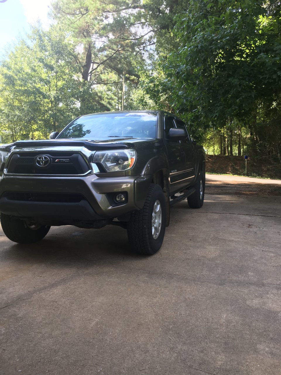

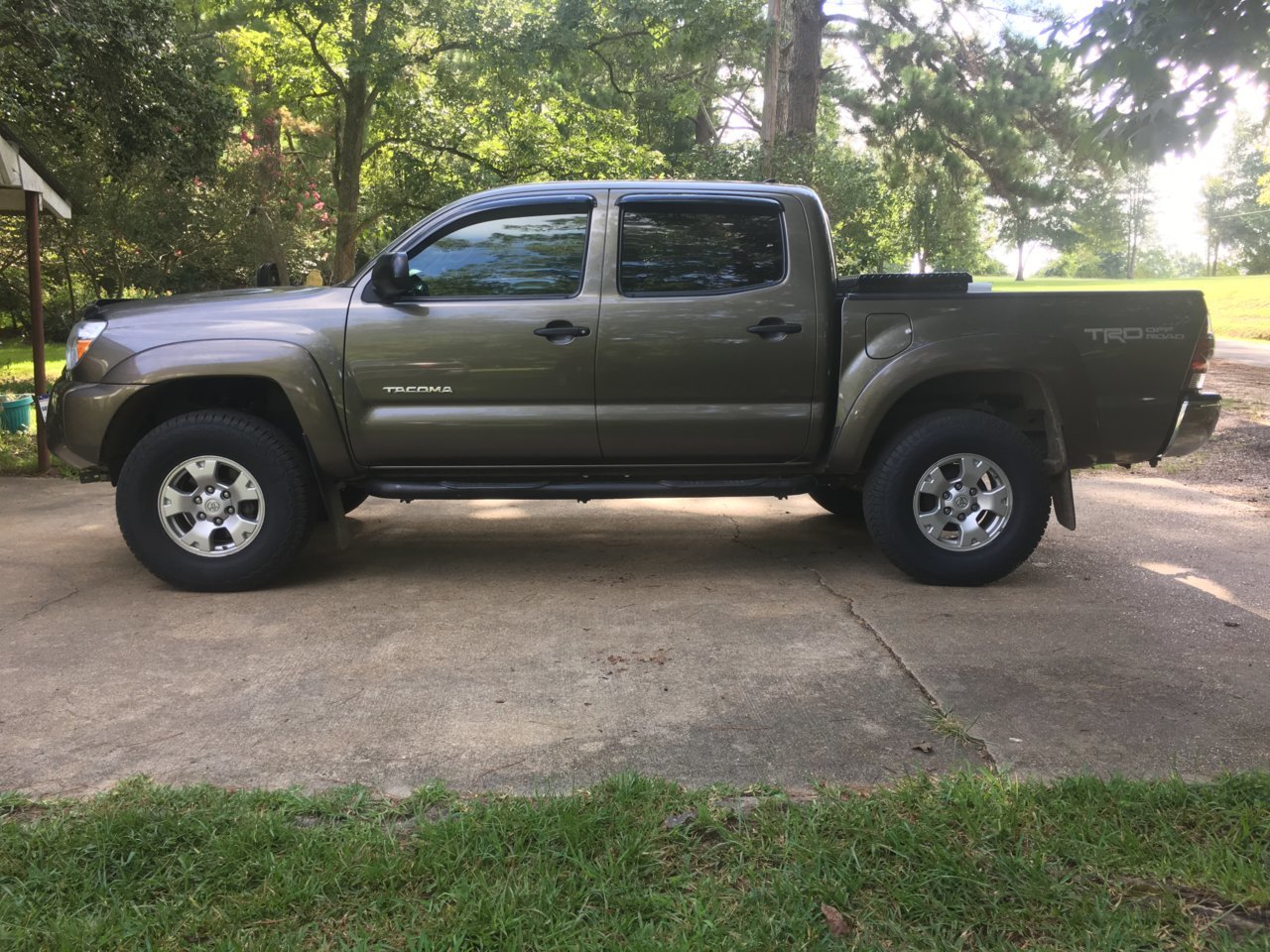

    Alright guys, I’ve gotten a lot of help through reading all of your threads, so I figure it’s my turn. I just finished my lift this morning.. (use the 1/4” top plate spacer to begin with, don’t leave it out like I did before the springs settle, because you DO need it, that’s why I had to retake it apart this morning to install the spacer)
    I wanted a 2” lift all around, because I didn’t want to have to fool with getting new UCA’s, as money was already tight just buying all of these for the lift. Here is a list of what I’ve done
    - General Springs KC Heavy Duty Leaf Springs (3+1) left them as they came
    - Bilstein 5100 shocks all the way around
    -OME 884 coils
    -1/4” top plate spacer for driver side to correct for “taco lean”
    In my opinion of ride quality, it’s great. My truck was at 70,000 miles when I started this lift, and I wasn’t very fond of the spongy ride the stockers gave me. The front end is definitely stiffer, but it will not beat you around the truck. It still has a hair bit of dip when you hit the breaks hard enough, and as for the rear, the ride of these leaf springs is excellent. Also stiffer than stock, as mine had about had it. Overall opinion, I love the ride quality. Sticks to the road much better, takes corners great, and potholes are a breeze. I’ve given it two weeks for all the components to settle, and also rode a few days with a car hauler trailer hooked up to settle the leaf springs. Here are the numbers- (Full tank of gas on both measurements)
    Before Lift Driver Passenger
    Front 20” 20 1/4”
    Rear 21 1/4” 21 1/2”
    After Lift Driver Passenger
    Front 22” 22 1/4”
    Rear 23 1/4” 23 1/2”
    Tires are also P265/75/r16 Hankook Dynapro ATM, no rubbing anywhere, no funny noises, no problems with anything. Smooth driving and smooth sailing. I’m not extremely mechanically inclined either, I work in a pharmacy and am going through Optometry School, not mechanic classes. That being said, I had minimal problems doing any of these modifications. Just a little elbow grease and thinking it through. Here’s some pics for anybody interested! 31146446-324B-4809-9F18-4EB23CCFA35D.jpg44660C89-20F3-4308-927D-219A31ADBB27.jpg68D6B4DD-41A6-45A8-B578-409EB1594415.jpgEEBDEBD8-6754-4C40-A36F-C15404E3FFBF.jpg
