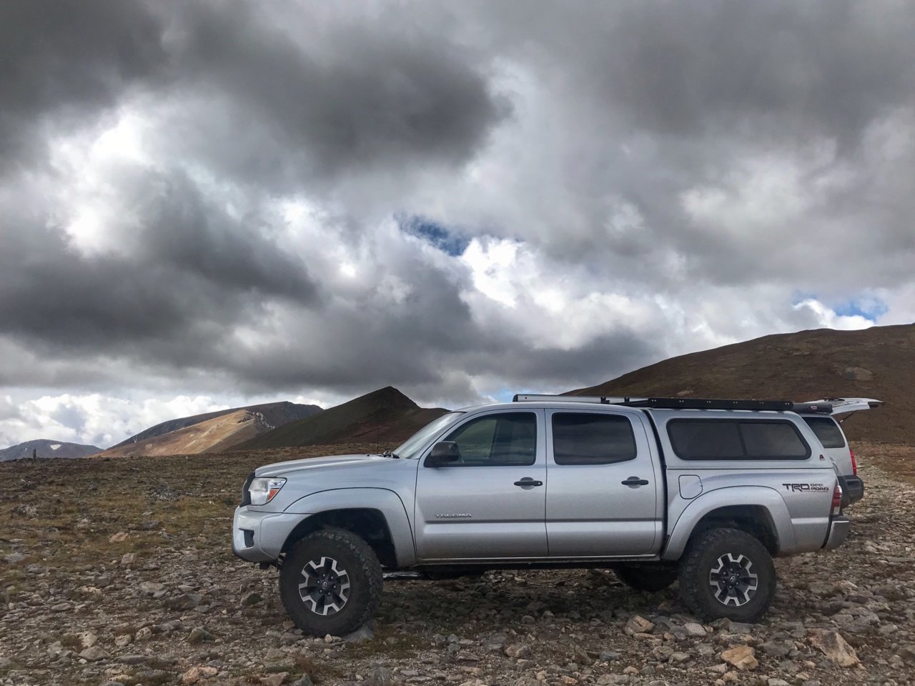

    Does anyone with a double cab long bed with a camper top on the back have pictures with this set up

    I put on the exact same lift about a year ago. It has been fantastic and rides better than stock. I never hit the bump stops anymore, even with a load of rocks in the back. I don’t have any vibs, it really hasn’t settled at all, and alignment is good. They do squeak, though I haven’t tried greasing them. I only really notice it offroad.
    I have considered trying to bump the front up a bit more. Even tossed around the idea of a 1/2” top spacer on the driver side, and move the 1/4” spacer to the passenger side. Wouldn’t gain a ton from it, but I still like some rake.

    Nice looking truck. My truck is same color but long bed with topper. You used the 884 coils up front?

    Yup, 884s, 5100s set time 0, and 1/4” trim packer on the drivers side.
    Another thing to note, my eccentrics were seized in and I needed to cut them off and replace the lower control arms before I could get it aligned. Apparently this is not uncommon for the Tacomas, so it is a potential extra cost to be aware of.
