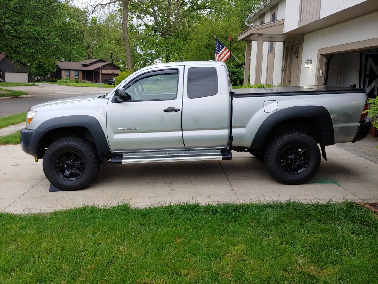

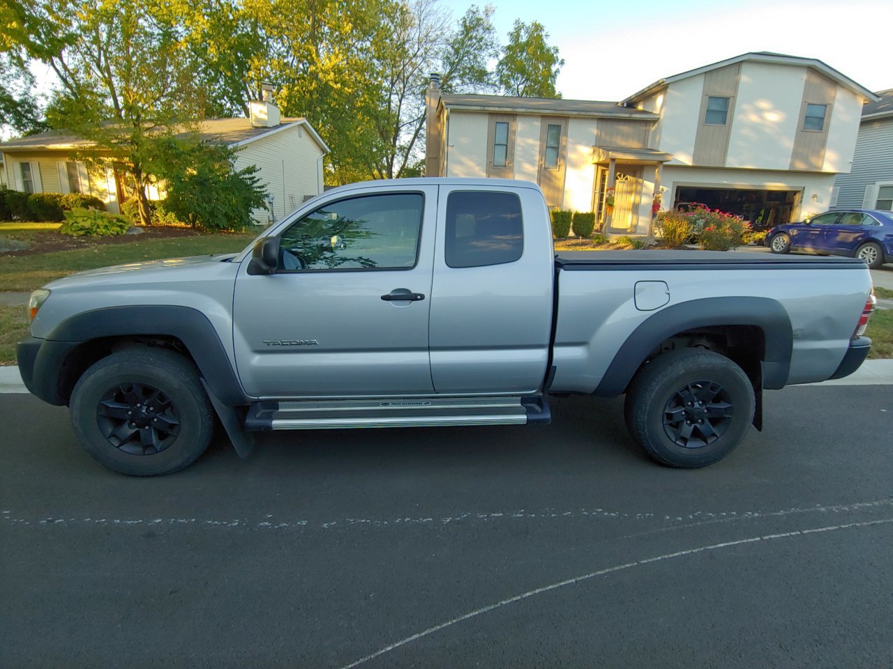

    Well, I have Bilstein 5100s all the way around, OME 884s, diff drop kit, General Spring HDs on mine, have for a week, no shudder, no noticeable issues except that the ride is completely different, in the best way.
    Before
    After

    How much lift do you get from the 884s? 2-2.5?
  3. May 22, 2020 at 5:13 PM
    #63
    elricfate
    elricfate Well-Known Member
    Nov 26, 2019
    #311771
    872
    2009 Tacoma AC Silver Mica
    Right around two inches, 2 and 1/8 when I measured it, might settle a little.
