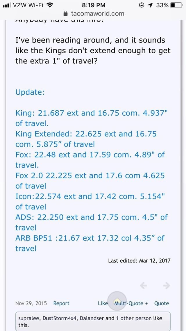

    Interesting read on the Fox vs King. I'd like to see a comparison on the other manufacturers as well.

    I highly doubt ADS or Radflo are any better or even as good as Fox build quality. I don't know if it is still true, but Fox Factory series 2.5 had a stainless 17-4 shaft, which for me was a big deal.

    ADS supposedly has a slick valving set up that is better than the others. Until there is an actual tear down and comparison hard to tell.

    One of the obvious reasons I’d choose king over fox front mid travel coilovers is the King’s have longer extended measurements. Then that means I’m not going to run Fox rear relocation shocks because I’m NOT ABOUT to mix two shock brands like that on my truck. My OCD would be :bananadead:

    What's the difference in extended length King vs. FOX 2.5 extended coilovers? What's that mean in the difference of travel between the two?
