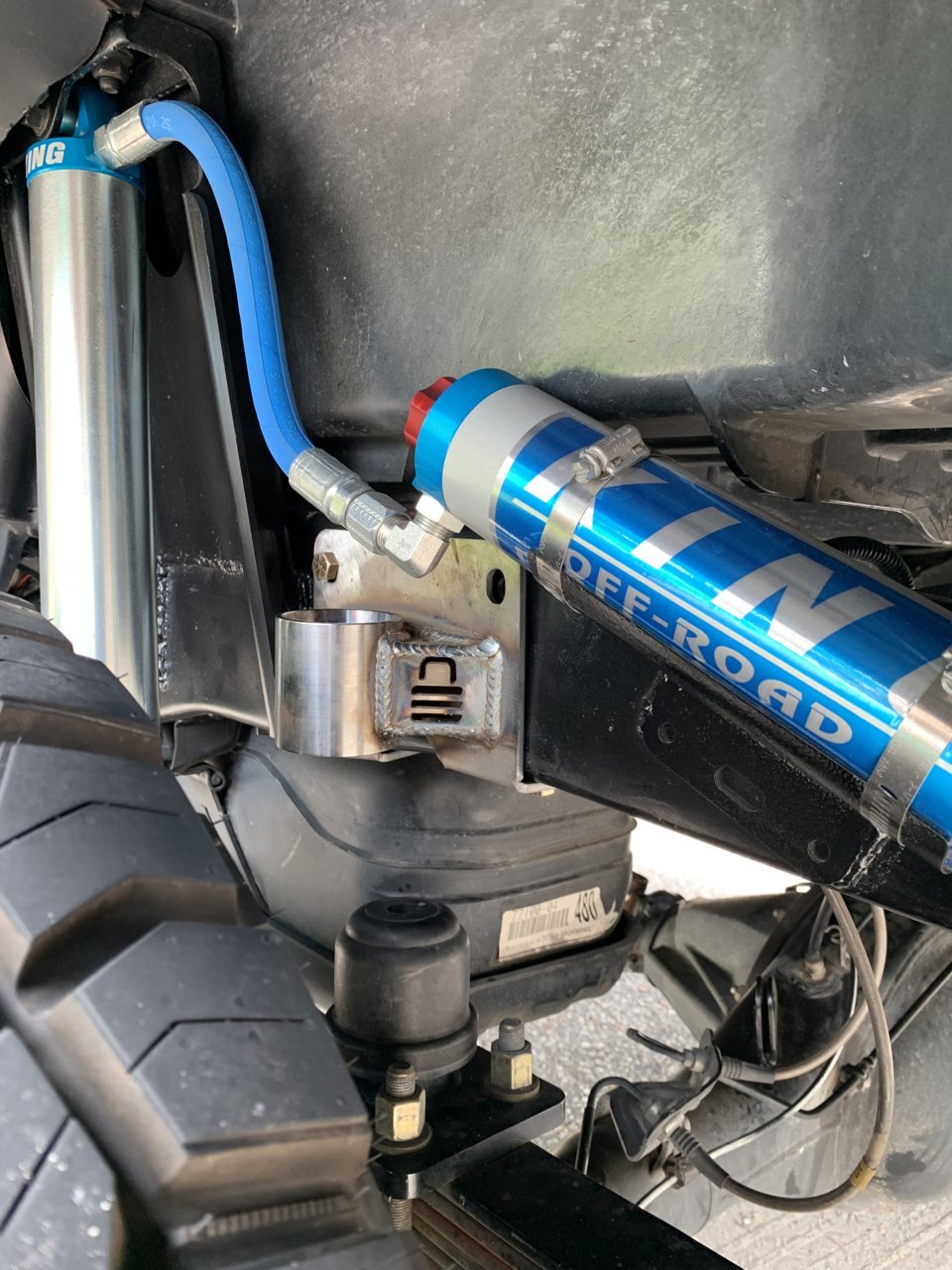

    First pics of the Archive 1st gen Tundra shock relocation that fits under the bed. There is no where near the room on Tundra because the frame is wider and leaf springs are right next to the tires.
    These shocks are custom valved by AccuTune, Fox Factory 2.0x12 (19.1" comp), and axle tabs are set for installation of Archive Overland springs in about a month. (stock mounting only allows a 2.0x10)

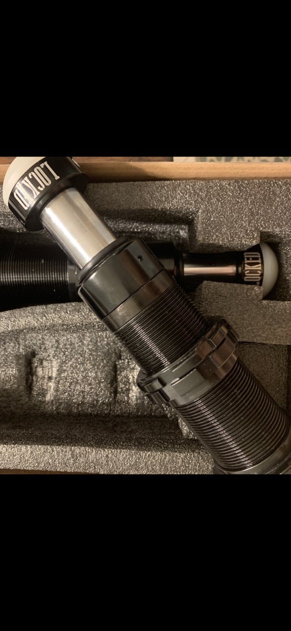

    Looks like good quality. Especially for the price point. Thanks for the prompt answer! :thumbsup: I’m more curious how the bumps come. Yours appear to be the threaded body and lock ring style bump. Does it require bump cans or a sleeve? Frame mounts aside, I like the design Locked is going for. So I’ll probably opt’d for them.
    Bray1197[QUOTED] likes this.
  20. Aug 5, 2019 at 11:06 PM
    #320
    Bray1197
    Bray1197 Well-Known Member
    Mar 10, 2016
    #180827
    617
    Bobby
    Myrtle Beach, SC
    2017 Tacoma Trd Pro
    A lot of stuff, just ask and I'd be happy to tell you. Or we could wheeling/camping
    Well they are threaded, but with the new design the sleeve doesn’t need to be. It can all be adjusted on the bump itself not the mount.
