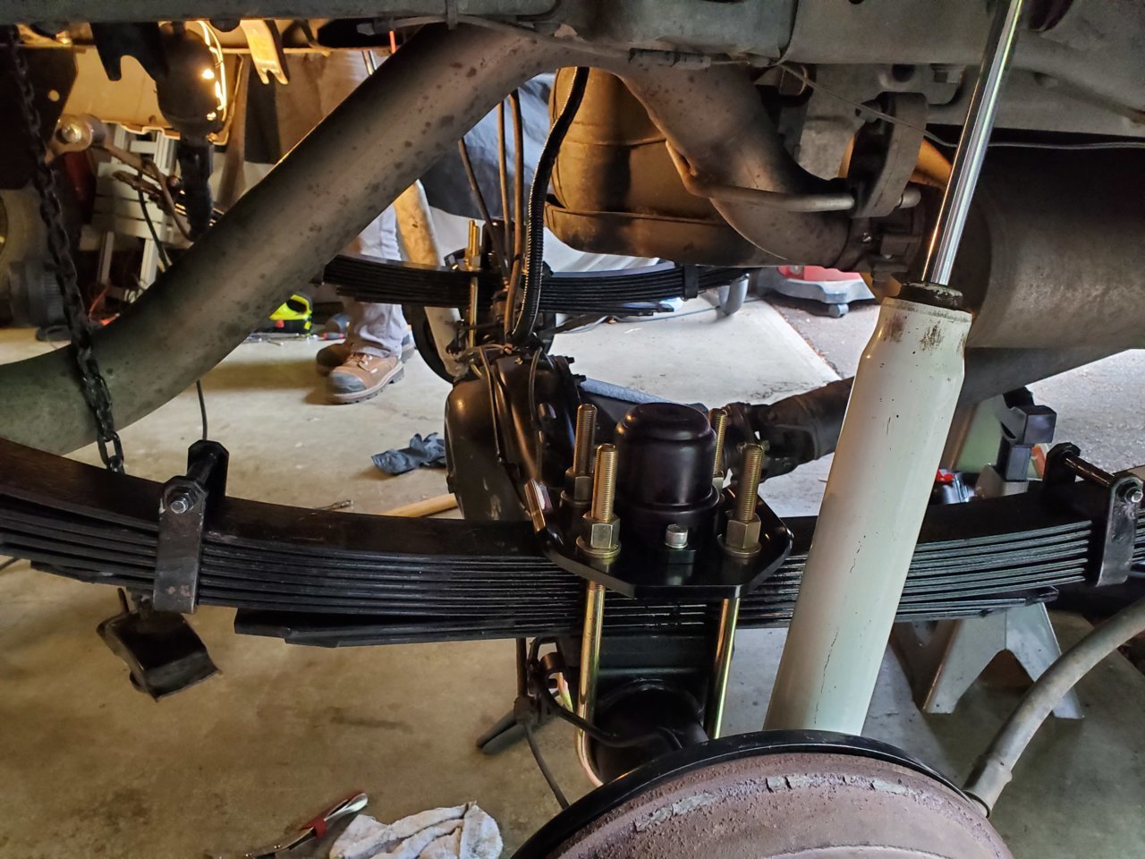

    I have seen some stupid shit. Just make sure with the spacers you get at least 7 full turns with the lugs to attach them to the truck. If not you may have to do what I did and bore the hole out a bit and get some ET lug nuts for them so you get enough thread engagement.

    another priceless tip. I think I would drill it. unless I'm local to a tire shop that has them on hand. probably best to do a test fit in advance of the welding day so I'm not stranded.

    I really need to get these spacers right for sure. this truck is wildly modified with hp goodies. my custom made camshafts are in production now. when installed I'll be over 400hp at the tires.

    Glad Eric was so thorough with communication. I did need a 1" block to get this height. 20190811_145257.jpg 20190811_120743.jpg

    Just an observation and recommendation.....
    I don’t think that bump start is going to work very well with how long those U bolts are. Maybe it’s the angle, but it looks like you’ll slam into your bolts just as soon as u hit the bump.

    they're cut off short. it was just a progress pic. yes, they would do some frame work.

    Also may need to adjust their height once you get the longer shocks on.

    yes. that is wait and see.
