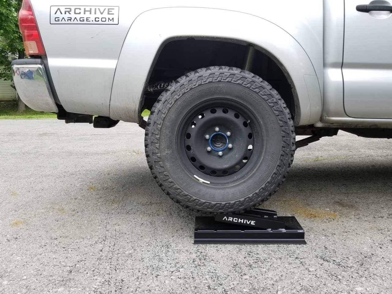

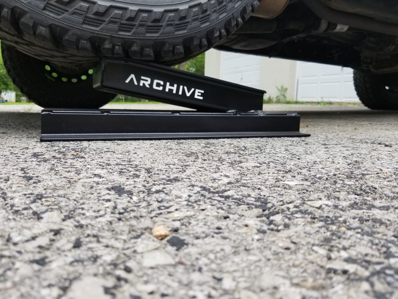

    Testing side load on the Archive Tacoma shock relocation towers. Estimated load is ~1,200 lbs (rear axle weighs about 2,000 lbs level) which I estimate would require about 10,000 lbs of shock force vertically to achieve when mounted, something that will likely never get close to happening
    Eric

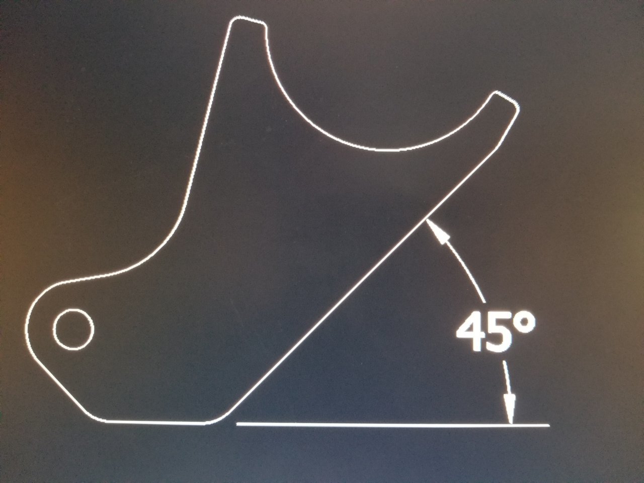

    Thank you Mark. I estimate the lower tabs would be rotated down about 45 degrees as shown in pic

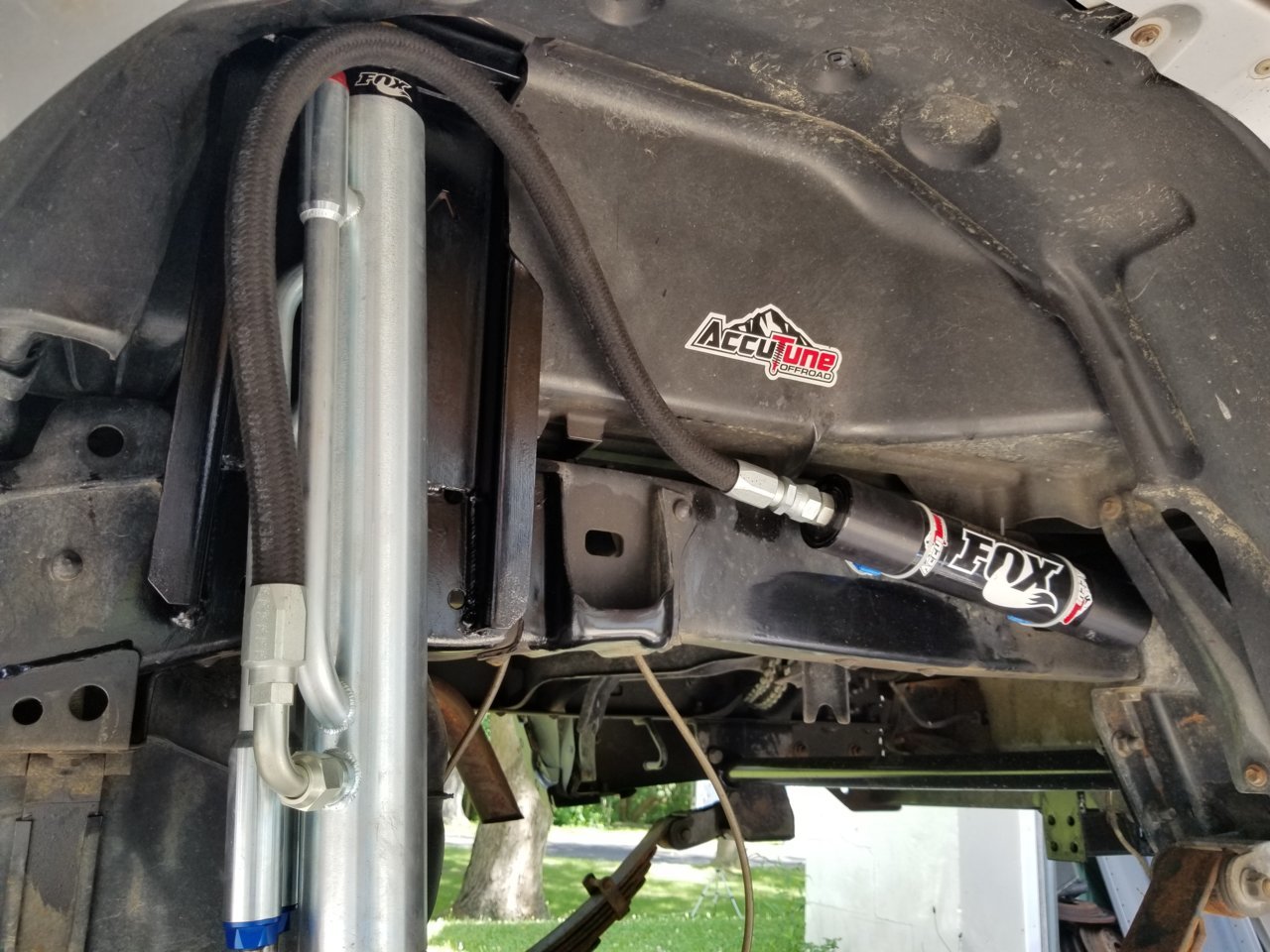

    Here is a test fit at the worst case scenario of spring under at full droop, as this Deaver U539/540 spring is the farthest forward the axle will get of any spring on the market that will fit in stock front hanger.
    Shock is Fox 2.5"Ă—14" triple bypass hose remote reservoir in standard layout. You can see the hose elbow is not in a great spot, it would be much better rotating it about 135deg to rear quadrant toward rear bumper, which as I mentioned I confirmed with Accutune as possible.
    The longer compression tube (middle tube) elbow gets to about 1/2" from tower.

    Good to know about Fox layouts, thanks. I've priced out the fox setup and king setup setup with the bypass tubes forward and even after custom fittings and anodizing they end up being cheaper than what Fox asks before any custom work. So I'm thinking I'll probably be going with King unless I can find something cheaper with a tube layout that will work. No custom layouts were available for the SAWs?
    That fitment looks pretty good with the rebound tube positioned outward. For best shock clearance, having the tubes face outward away from the frame looks like it would be best, but then clearance with the wheel and tire becomes a problem, correct?
