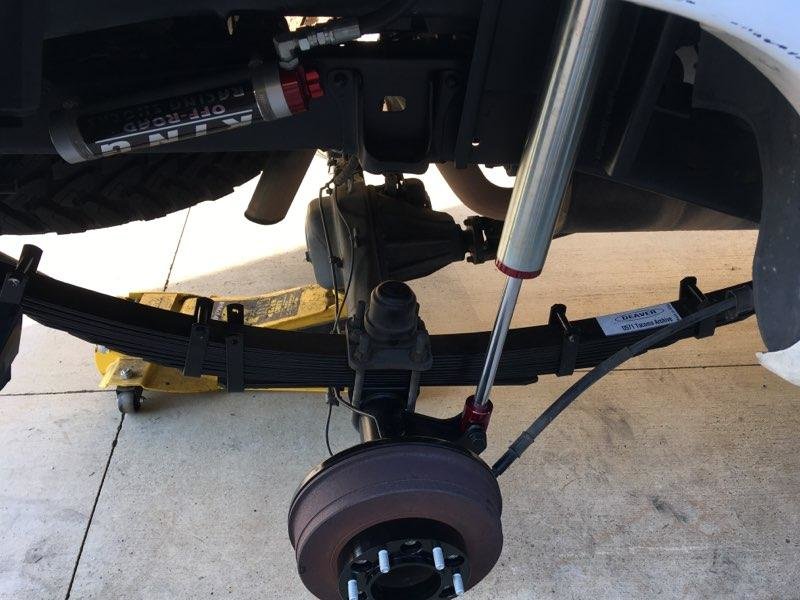

    this pic makes it look easy. this rivet removal is very physically demanding and time taxing. the switch to 410s is a perfect upgrade for me as my truck is multipurpose. freeway banshee to low speed work tool hauler. I really like what it drives like now. smoother ride with garbage shocks is very impressive. to those considering major suspension changes please consider archive garage. great parts, even better service.

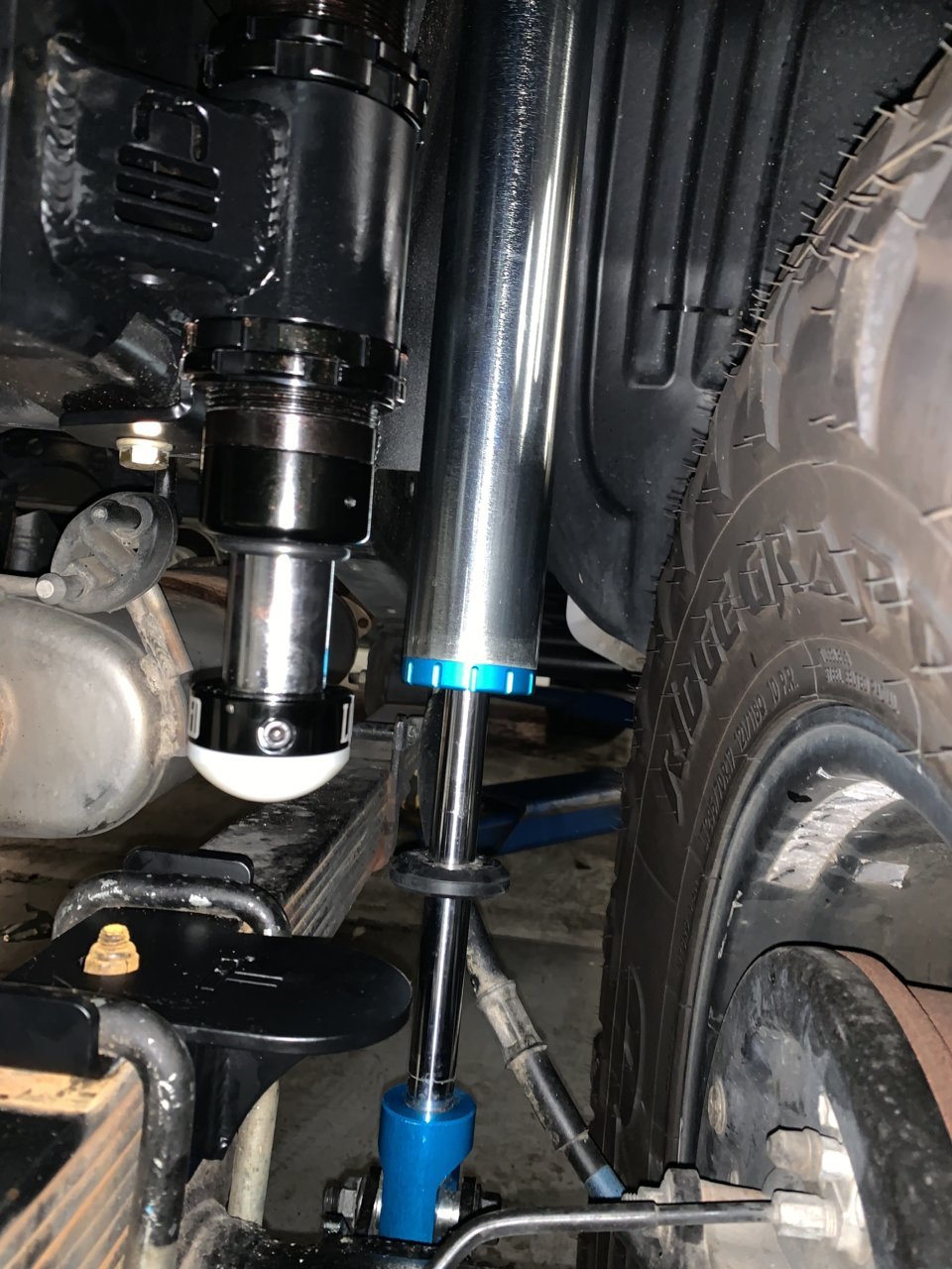

    Got in contact with Locked on instagram, got a few more questions answered and got a set of these awesome bumps ordered! Goodbye stock rubber bumps, and hello high-speed hyrdros. I can't wait to tune and see them and my @ARCHIVE 14" relocate towers and hammer hangers all working together to get that smooth travel. :thumbsup:

    I can say things already are much better with archive goods despite my current pathetic shocks. later this month the final goodness happens.

    The increase in ride quality and driveability with the hammer hangers cannot be understated. That coupled with the relocation towers to fit longer shocks, giving the axle more travel to work within, you can get very good performance with proper installation and tuning. It's no bed cage, but I love how robust the system is. My limitation right now is my cheap dakar leafs, which currently aren't setting my ride height as needed and aren't cycling as cleanly as I'd like.
    ...I think I've finally decided that spring under axle is in my future. I like to go fast too much and I already have extended shackles anyway.

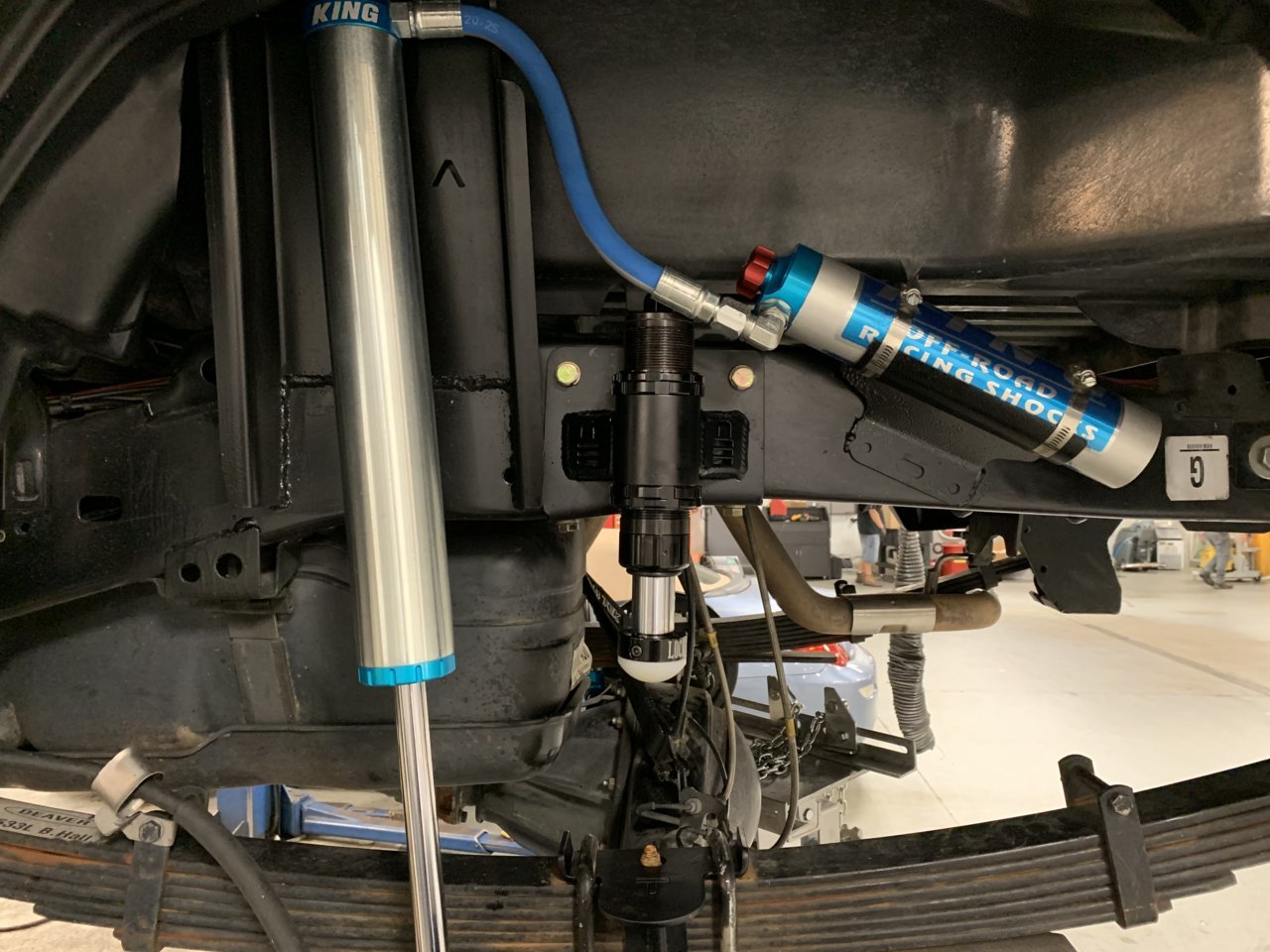

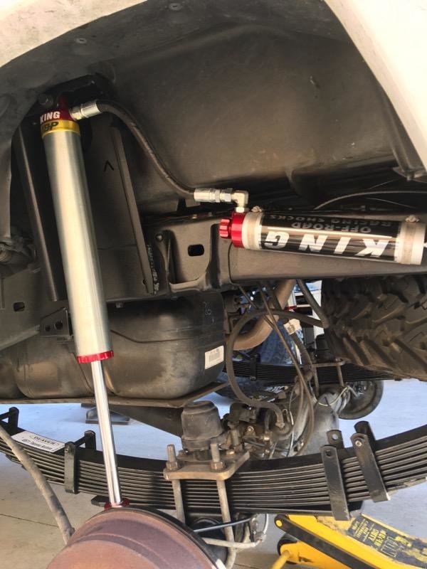

    So this happened yesterday.
    AG shock relocation with King 12x2.5, Deaver AG U571 leaf packs. AG Hammer hangers with 3.6 shackles. 1.25 wheel spacers.

    Awesome, looks rad. Hit em with the AG and IBP. thanks for putting the resi elbow up and posting the pics

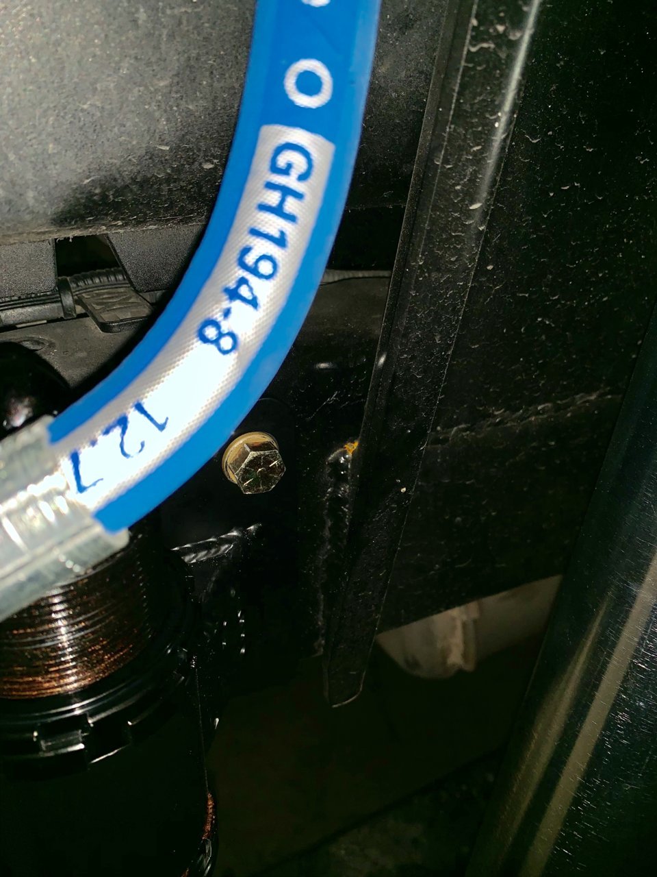

    Yes, I read thru this entire thread and learned about the resi fitting orientation. I had to loosen the fittings and rotated them. Now the stickers are upside down :(
