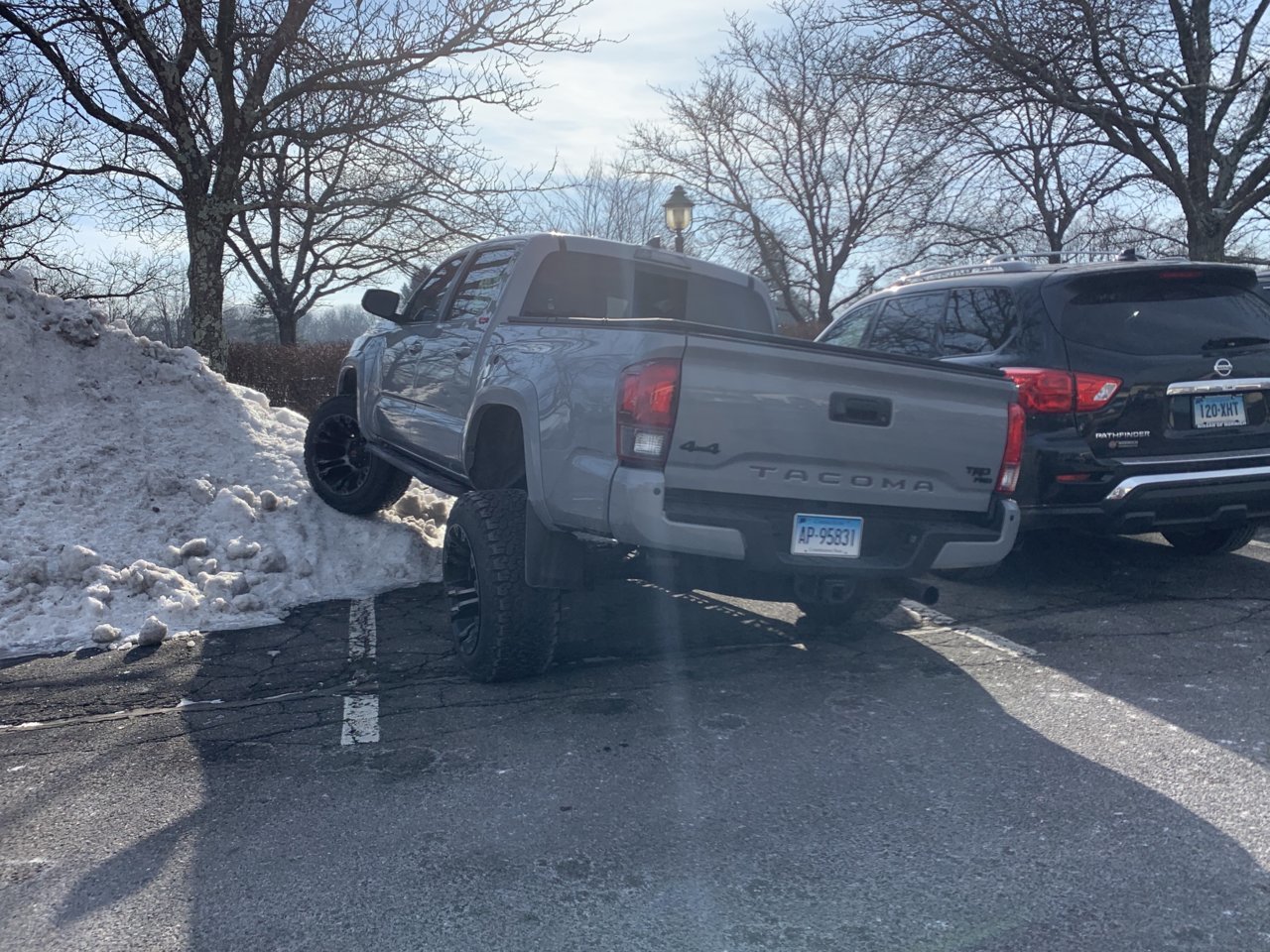

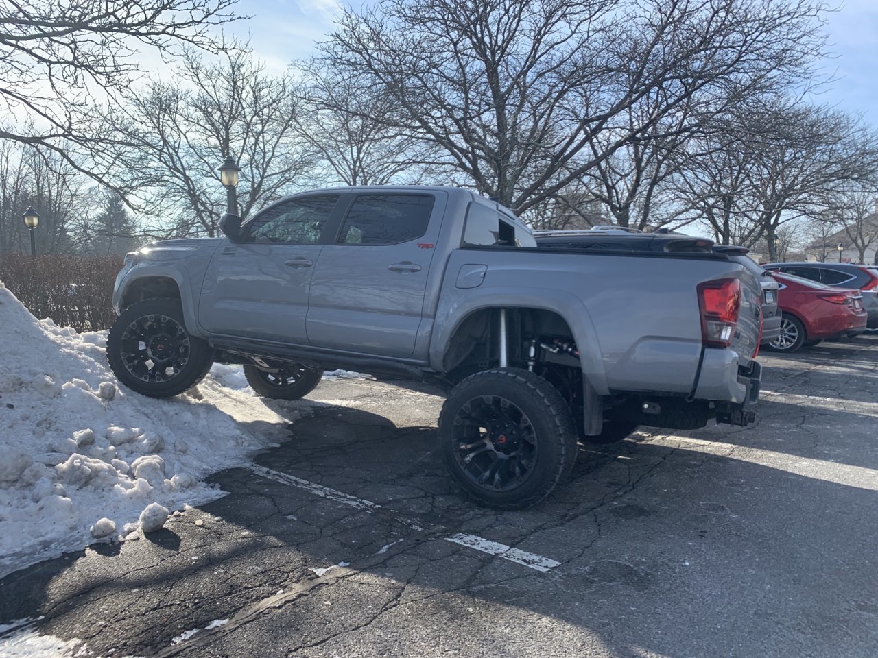

    This is how mine came out two months ago

    Jrgymie
    Jrgymie Tuf MuddR
    Jul 29, 2018
    #260922
    448
    Jeff
    Glastonbury, CT
    18 DCSB CEMENT TRD SPORT 4x4
    AG shock relocation kit with Fox 2.5 x 12" smoothies
    AG HH and shackles
    TC bump stop kit with Fox 2" bump stops
    Definitely feel like the rear end is more solid, less shimmies over hard bumps. Happy with the increased flex off road.
    Looking to add the AG HH cross bar once I get my spare tire mounted up on my new HC bumper/tire carrier. Definitely recommend this set up. Next best set up aside from doing lots of fabrication with bed cage.

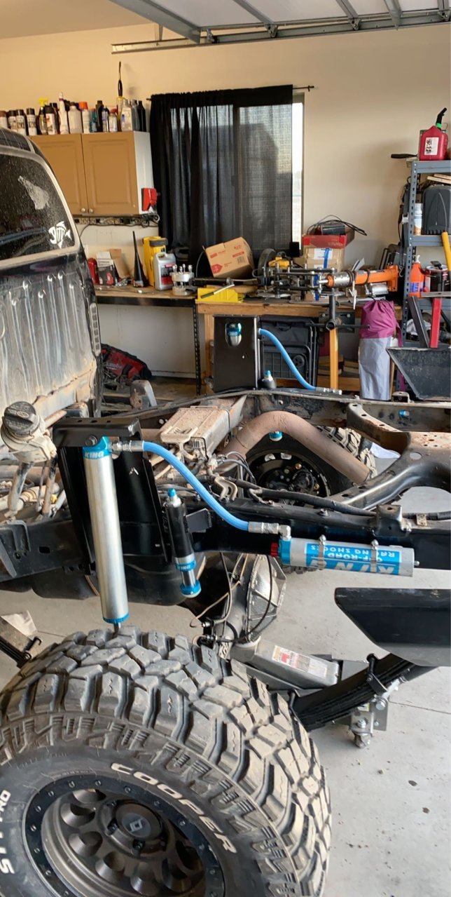

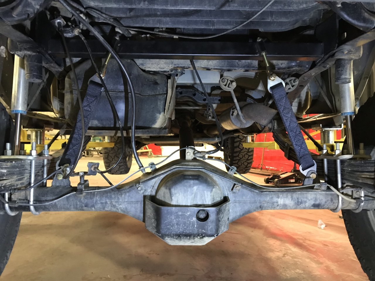

    Have you seen my limit strap solution? You’ll want an adjustable top on them. Some people just plate the inside of the frame and mount it to that but I used 2” square tubing to make a crossmember and mount them to that.

    most people don’t run limit straps in the rear. Not really “necessary” unless you’re planning on bombing big desert terrain

    So many people should be though. Cheap insurance for expensive shocks

    No problem. Used cardboard to make the template for the frame rails and cut it out of 1/4”. The tubing is 1/8” wall. Got the mounts from TMR customs. They’re really solid

    All depends on application. Not disagreeing with you about insurance, but the amount of load required to damage one of these is not created on the rear of these trucks without severe abuse that most will not achieve.
    I’d argue that they are needed on the fronts more than the rear.
