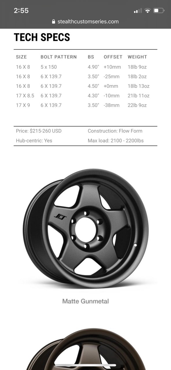

    I’m exploring the option of going w/ an Accutune stage 5 kit which includes shock relocation in the rear.
    Looking over specs, the one thing that concerned me was the wheel spacers.
    What wheel, if any, can be used without spacers? Currently running SCS Ray 10. They are 16x8 w/ 4” bs and -12 offset.
    ARCHIVE[OP] and whatstcp like this.
  8. Mar 2, 2020 at 2:26 PM

    Thanks for choosing Archive. If you could get by without a spacer, it would be a 3.5" BS wheel and probably only a 285. 315s would probably rub

    SCS I think makes some pretty aggressive wheels that are offset enough but it may just be in the F5s.

    I second what Eric said. I had 3.6” BS and 295s and still rubbed. Had to add spacers to 3” BS to stop rubbing. Then went 315s and I rub again. Now I accept it. And that’s with a 2.0 body shock

    Looks like SCS has 3.5 BS on this model w/ an aggressive negative offset too. My only worries is that this wheel is wider than mine (9” instead of 8”)
    I guess spacers aren’t the end of the world, although I would like to avoid them.
