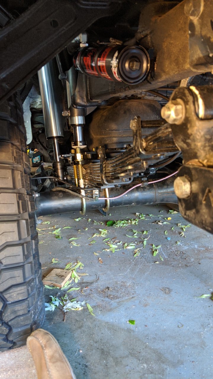

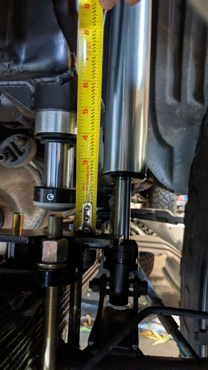

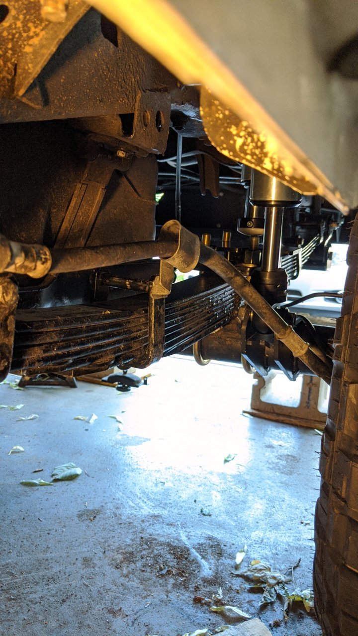

    Looking for some insight. I buttoned up the rear of the truck today and I was all excited to get it off jack stands finally annnnddd, I have 3 inches of up travel. I think i should be getting more like 4-4.5.
    I'm thinking I set the bump height (and by extension, the lower shock mount) too low. When you set your bump height were you taking the main leaf to full negative arch? I took mine to 3" of negative arch thinking there was no way the leaves would go more negative than that and thats what I ended up with as up travel...
    At ride height are your springs relatively flat with a deaver u402 pack or similar? Trying to figure out of I i set the bump height too low, the pack is too light of a spring rate or both.
    Jared8907 likes this.
  12. Jun 7, 2020 at 8:55 PM
    #472

    WalkinTaco
    WalkinTaco Well-Known Member
    Sep 1, 2018
    #264802
    116
    2018 TRD OR M/T
    this might be the wrong location for this question.
    I did cycle it. There is a half inch of shock shaft at full bump. I'm thinking that i set the bump height wrong.
    I didn't take the spring to its absolute negative potential thinking it would never go that far but that must be how its suppose to be done. I ordered a new set of lower shock mounts from archive (and new bump sleeves). I'm going to redo it once they arrive. Hoping there is another inch of up travel.
    This time i'll tack it in, rebuild the pack and set it back on its weight to make sure it looks right. You live and you learn.

    This is not to beat up on you, but I want to make sure others do not follow this. I would have done the install much differently, you have no bump travel, and that is critical for the Tacoma.
    The bump stop mount is too low (but also limited by bed overhang), the old Archive bump plate is too high, and the shock axle tab is rotated up way too high. The axle tab should be rotated down, you also want to take into account articulation which requires extra shock bump travel vs the bumpstop at full compression.
    I will send you a pair of the current Archive U-bolt plates which would instantly give you another 1" of clearance to the bump stop. You spent a lot of money on all these parts, I will help you get it setup for the most benefit.
    Eric

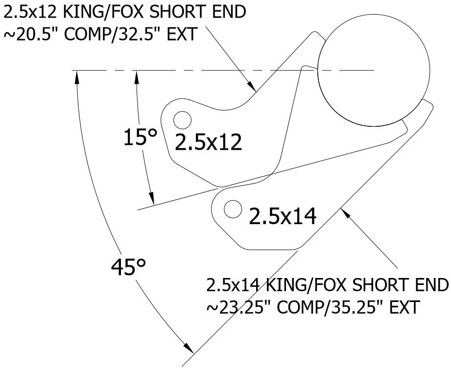

    I know its prolly been ask before, but what is the proper angle for the axle tab should be?
    ARCHIVE[QUOTED][OP] likes this.

    West Valley, AZ
    2017 4Runner
    It changes truck to truck so it's impossible to give a number that's one size fits all, but it's roughly 35-45 degrees.
    madsand[QUOTED] and ARCHIVE[OP] like this.
  19. Jun 8, 2020 at 8:13 AM

    Thank you. I will make up a sketch with approximate angles measured the straight edge on the bottom of the axle tabs. A 2.5x12 with Spring Over setting is generally about 15 degrees below horizontal
    Correct, but 35-45 degrees is for a 2.5x14, A 2.5x12 with Spring Over setting is generally about 15 degrees below horizontal
    Please note folks: these are APPROXIMATE angles, it depends on many variables such as:
    1. Thickness of spring pack (Some are 3" thick packs)
    2. Height of your bumpstops/U-bolt flip (Current Archive offerings are best in class)
    3. Shock brand and length of rod end
    4. Potentially fender clearance
