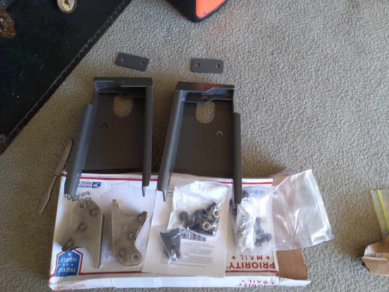

    found these on the doorstep this AM
    These are going on in next weekend . So nice - looks good Archive

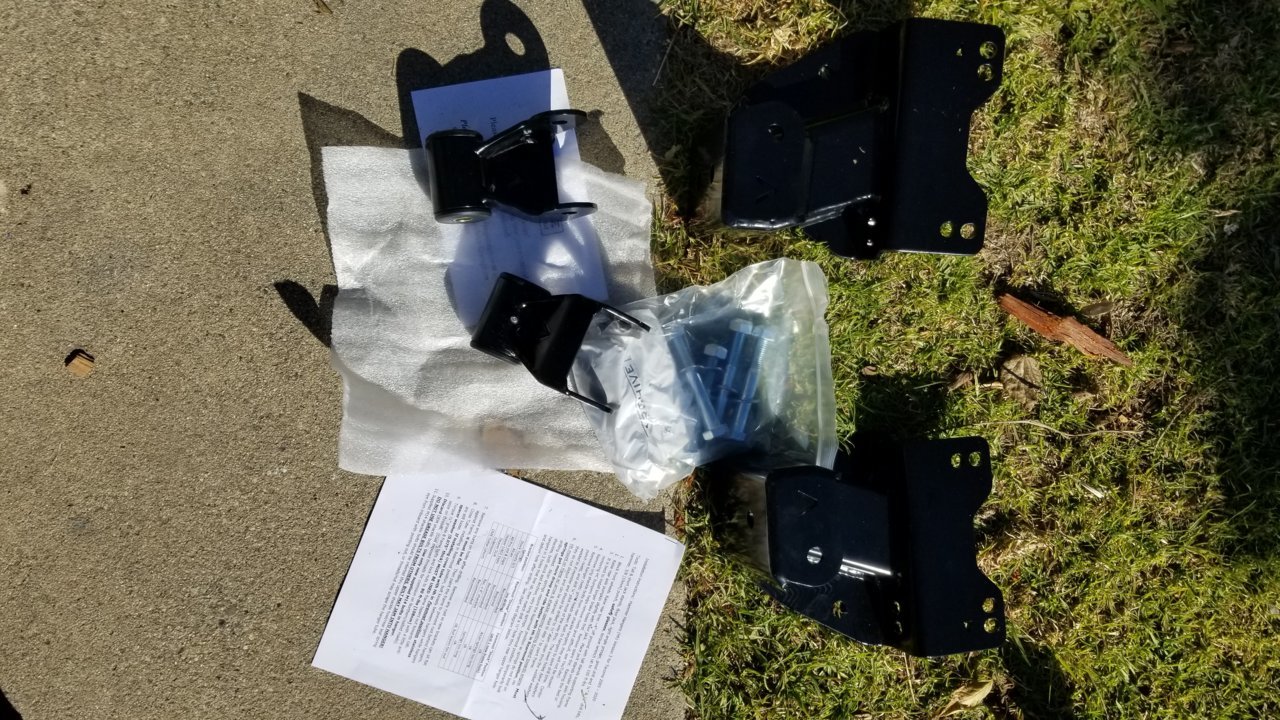

    Got all the parts- thanks Archive :cheers::muscleflexing:20201128_111846.jpg
