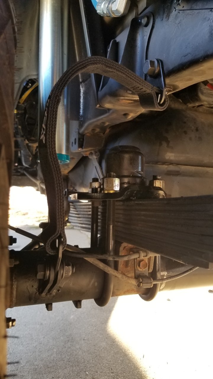

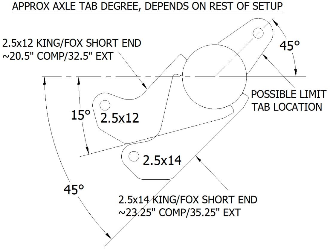

    gm- installation is going well and I am just about done- I do wonder did you or have you had a chance to get any pics or designs for the limit strap solution you mentioned that goes to the frame? and where about did you say the limit tabs should go on the axle/ frame? Is that outboard towards the wheel side of the ubolts?

    No, I didn't get it done on my truck yet, been too busy with orders. Here is the image in the instructions
    I would run a strap up to the frame rail a few inches behind the bump bracket on the frame, drill a 1/2" hole in the frame about 1" from the bottom flange. Using this method for a 12" shock should be about right for a ~18" strap

    That all sounds good Brent, but I think ADS standard rod end is longer than King's standard, I would request a short rod end for gound clearance, keeps the axle tab up higher.
    I recommend the same for Fox 2.5s

    About 1.25 of shaft left inside shock at limit droop to account for strech with 18" strap

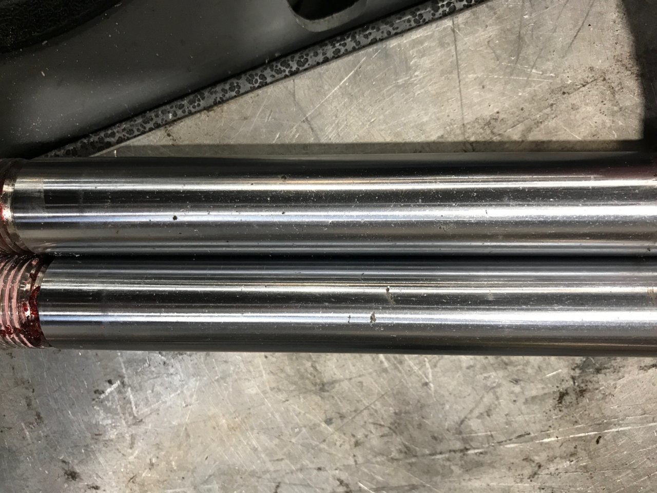

    Anyone running this kit figured out a roost shield/rock guard for a 2.5 to protect the shock shafts from flying debris?

    Upon further research, King, Falcon and ORI make versions that fit their products but Fox doesn’t make one for a 2.5

    For Kings they are a good idea, because their shafts ding easy and may need to be replaced during a rebuild
    Fox have durable shafts, but a shield is a good idea. I bought a used pair of 2nd gen Raptor shocks for a project, and the plastic shaft guards were rashed pretty good, previous owner must have driven them hard in the desert. So I see the benefit

    These are my shafts after being installed the middle of September.
    My driving style and setup obviously throws a lot of debris at them and I’d like to avoid having to tear them down this regularly. It’s compounded by living on the beach and seeing things start to corrode immediately.

    That's eye opening, thanks for explaining why you needed guards.

    Apparently the rocks in AZ where I've been playing are sharp and hard.
