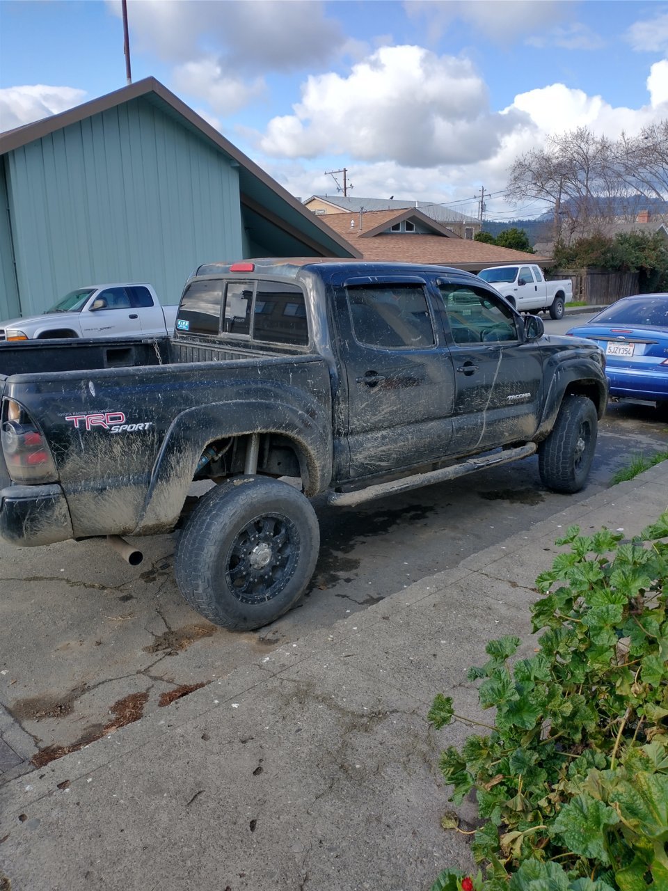

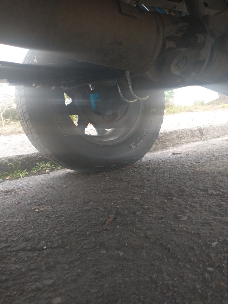

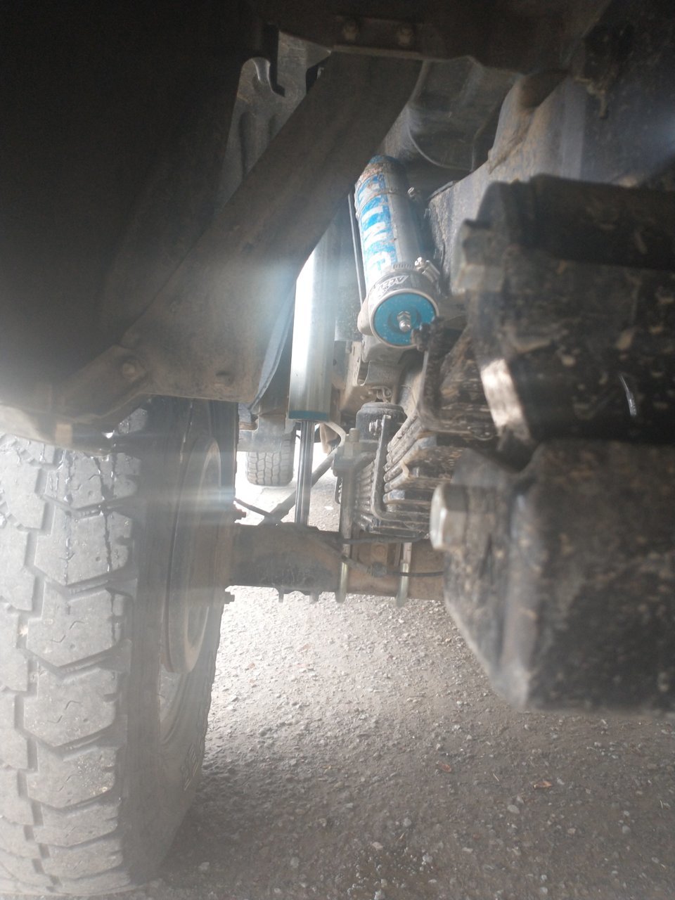

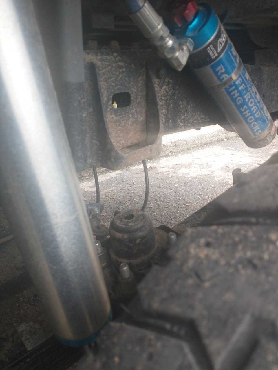

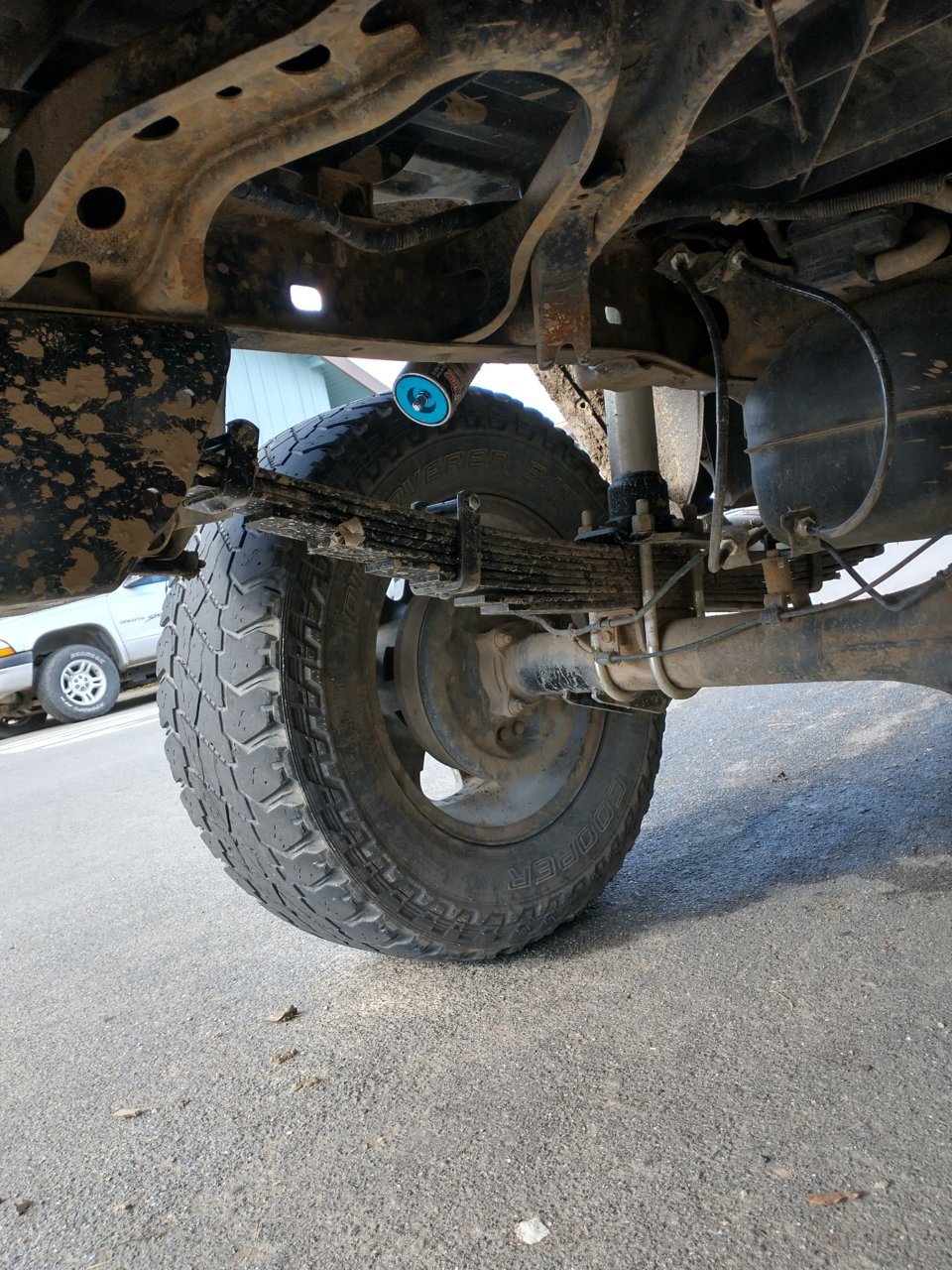

    I got the 2.5 x14s not sure if everything looks correct but it seems to ride great wondering if I would have had more uptravel with the 12s, with the deaver u402 stage 1,hammer hangers and shackles,archive u bolt flip,archive relocate. I am aware I need to flip the shackle bolts and u bolt plates around still waiting on the front 2.5 extended travel and icon uppers hope it will level out

    Sorry for late comment, I didn't put together the 14" and where your axle tabs are, they are too high for 14". They need to rotated down like instructions say, so that bottom edge of axle tab is closer to 45deg from horizontal.
    (14" collapsed length is 3" longer than 12" shock)
    Once fixed, you will have full bump travel.
    Also, your reservoir is hanging too low, spring will come up and hit it. I recommend the reservoir be rotated 180deg around the hose, just like the Kings pictured in post #1.
