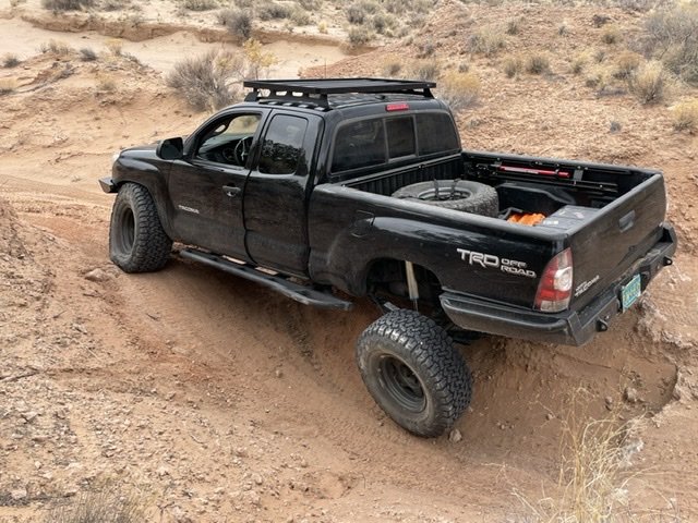

    Got my shock relocate burned in recently. Love that flex!
    Man am I happy with my rear set up! hammer hangers with cross bar, deaver u402 stage iii, king 2.5 12” smooth bodies. Still need to get a limit strap though.
    I do see that I possibly could squeeze more flex out of the stock shackles if I added poly bushings, but not with these deavers and 12” shocks. The shocks are maxed out at this shackle angle. Guess I should have ordered and 14” short bodies.
    With my 3.5” BS -25mm offset SCS wheels with 295/75r16 BFG KO2s the off set is damn near perfect. At full unstrapped articulation, they do not rub. I will need a spacer when I jump to 35s for sure

    Seeing your setup is making me want to hurry up and get my relocate done. I’m running the stage 3’s as well so it’s good to see they’ll still flex out really well despite their weight rating. First picture with 3.5” BS I’ve seen as well which I’m glad to see since mine are the same. Gives me a good idea of what size spacer I’ll probably need with 315/75/16’s, which I’m guessing is a 1” spacer. So wide... Haha
