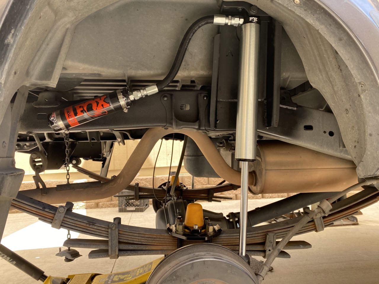

    JoseyWells
    JoseyWells Well-Known Member
    Dec 27, 2011
    #69448
    365
    Joe
    Corona, CA
    12 prerunner
    Demello sliders, Icon ext coilovers, icon rear shocks, icons UCAs, 17" Konig Countersteer Type X, 285/70/17 Nitto Trail Grapplers
  3. May 25, 2021 at 6:25 PM
    #723
    EatSleepTacos
    Mar 24, 2015
    #151688
    59,844
    Randy
    West Valley, AZ
    2017 4Runner
    Looks like your leafs are resting on your exhaust.

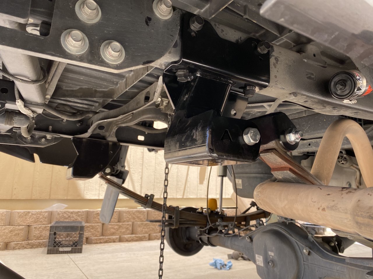

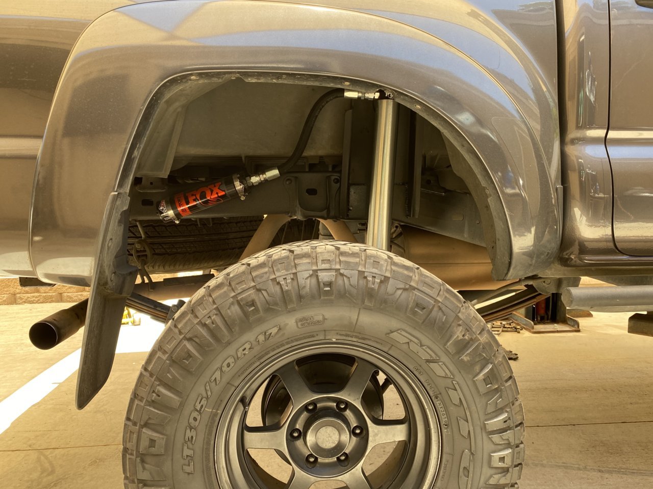

  5. May 25, 2021 at 6:29 PM
    #725
    JoseyWells
    Dec 27, 2011
    #69448
    365
    Joe
    Corona, CA
    12 prerunner
    Had my friend who does installs for me get it all done. These are the pictures he sent. I don’t have my truck yet lol
    EatSleepTacos[QUOTED] likes this.
  6. May 26, 2021 at 6:12 AM
    #726
    ARCHIVE
    ARCHIVE [OP] Well-Known Member Vendor
    Oct 29, 2015
    #168099
    2,259
    Eric
    Orchard Park, NY (Buffalo)
    '05 Taco, '22 Tundra, '91 Cummins
    2.5" Fox relocation * Hammer hanger * Archive MD springs
    This is fine since you don't have your leaves constantly resting on tailpipe,
    and that's way better than people shooting hot exhaust at hangers and shackles, while driving 70mph on the highway.
    I wish people would stop chopping the tailpipe super high up, unless you really need to and properly aim the exhaust
    whatstcp and JoseyWells like this.
  7. May 26, 2021 at 9:35 AM
    #727
    EatSleepTacos
    Mar 24, 2015
    #151688
    59,844
    Randy
    West Valley, AZ
    2017 4Runner
    What’s your concern with that? You think it’ll be hot enough to cook the bushing? From the tip of the exhaust being minimum 12” away, not aimed directly at the hanger? I have my doubts lol
    singletrack_ftw likes this.
  8. May 26, 2021 at 10:23 AM
    #728
    ARCHIVE
    Oct 29, 2015
    #168099
    2,259
    Eric
    Happens a lot, poly bushings only can stand 160-180 degrees. People melt them, I have to rush them out.
    For some people, trimming exhaust is completely unnecessary
  9. May 26, 2021 at 10:34 AM
    #729
    EatSleepTacos
    Mar 24, 2015
    #151688
    59,844
    Randy
    West Valley, AZ
    2017 4Runner
    Wow, that's surprising, I've never heard of that happening.
  10. May 26, 2021 at 11:13 AM
    #730
    JoseyWells
    Dec 27, 2011
    #69448
    365
    Joe
    Corona, CA
    12 prerunner
    I just got my truck back. I think the picture was misleading. My leafs barely touch the exhaust. Will post pictures in a bit
  11. May 26, 2021 at 11:27 AM
    #731
    ARCHIVE
    Oct 29, 2015
    #168099
    2,259
    Eric
    People don't realize the exhaust is 5-600 degrees, and a large volume of gas.
    Did you know in an hour of driving, a 4.0 v6 might ingest 40,000 gallons of air on the highway.
    2,500 revolutions per minute x 60 mins = 150,000 revolutions per hour.
    4.0L(1 gal) every 2 revs at full throttle is approaching 75,000 gals
    Even if engine is only filling 1/2 of each cylinder to, that's still 37,000 gals of air we could breathe. For an NA engine.
    Times 1 billion vehicles for regd for road use
    Plus planes, cargo ships, race cars, boats, lawn mowers in the world, that is a lot of heat. Think about your impact
    In 1 hour, a person might breathe 100 gallons
    Key-Rei likes this.

  13. May 26, 2021 at 11:33 AM
    #733
    AccuTune Offroad
    AccuTune Offroad Well-Known Member Vendor
    Jan 28, 2019
    #281012
    1,657
    El Cajon, CA
    Thats only at full droop
  14. May 26, 2021 at 11:44 AM
    #734
    Brian422
    Brian422 I fell into the pit that is TW
    Jun 8, 2011
    #57958
    15,688
    Brian
    Birmingham, AL
    2012 DBCSB F/R Locked, 35's ,Long travel, 23 Tundra 4x4 limited
    Not Stock
    Are those poly bushings? His shackle doesnt look flat, but could be the pic angle. My shackle looks to get more droop?
