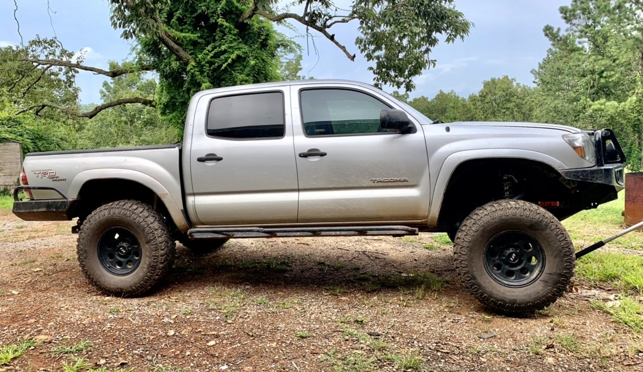

  15. Aug 22, 2021 at 5:17 AM
    #755
    Dayman Karate
    Dayman Karate Well-Known Member
    Dec 18, 2017
    #238838
    4,720
    Clay
    Central Alabama
    JKU Rubicon
    https://www.tacomaworld.com/threads/daymans-karate-class-but-you-wont-learn-nothin-4-link-lt-and-previous-iterations.755134/
    I’m going from 1.25” to 1.5” spacers. 4.5” backspacing on 35x12.5” and they just barely touch the shock body at full tilt. 2.5x12” smooth bodies.
    ARCHIVE[OP] likes this.

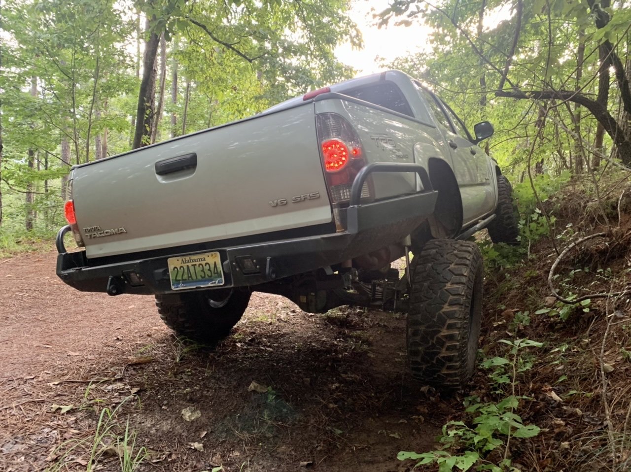

  20. Aug 23, 2021 at 6:12 PM
    #760
    Dayman Karate
    Dec 18, 2017
    #238838
    4,720
    Clay
    Central Alabama
    JKU Rubicon
    Even with crummy Dakars, the ride/droop has never been better.
    I think it pairs well with the LT front, too
