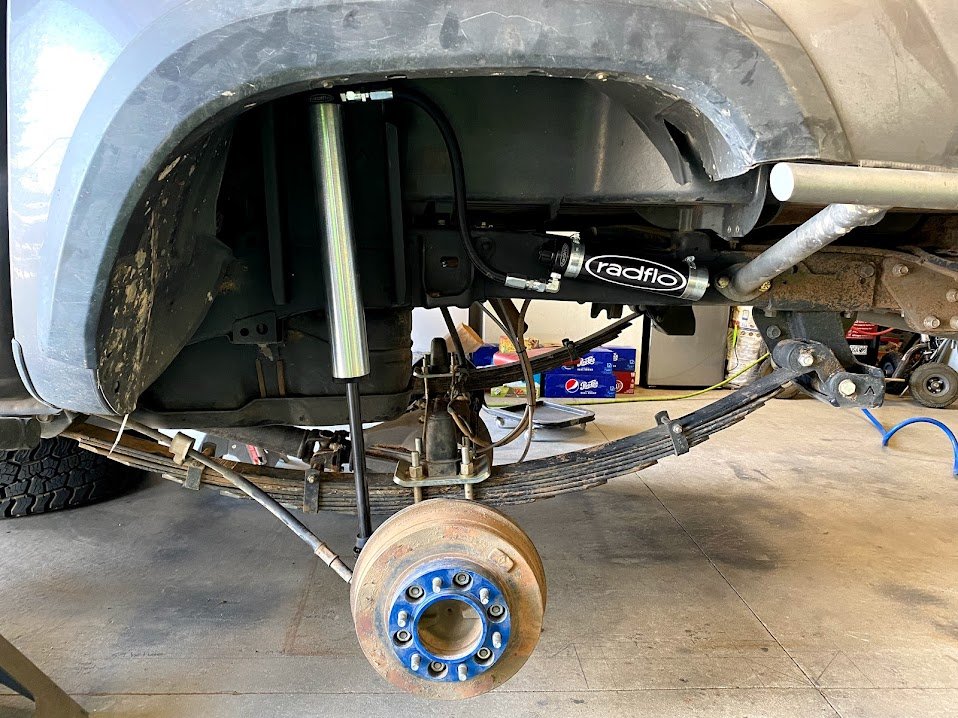

    So, today Snowsk8air was working on the rear for the shock relocation.
    We found with the All Dogs Performance springs. They become the limiting factor on droop. With the rear shackles still just above horizontal. By about 15* I'd say. We didnt measure it.
    So, I use Durobumps the 4.25" tall ones. After setting bump, at full droop of springs pulls the Radflo shocks to full 12".
    @snowsk8air2 can probably explain it better. Seems to work out pretty good. Figure'd you'd want the info.

    All the parts paired up perfectly. Bumped as high as it can with the bump stops and really wouldn’t want to go higher because the leafs going negative a bit. And the leafs limit droop to right before the shocks are fully extended. 14” shocks would do you no good. These 12’s are perfect

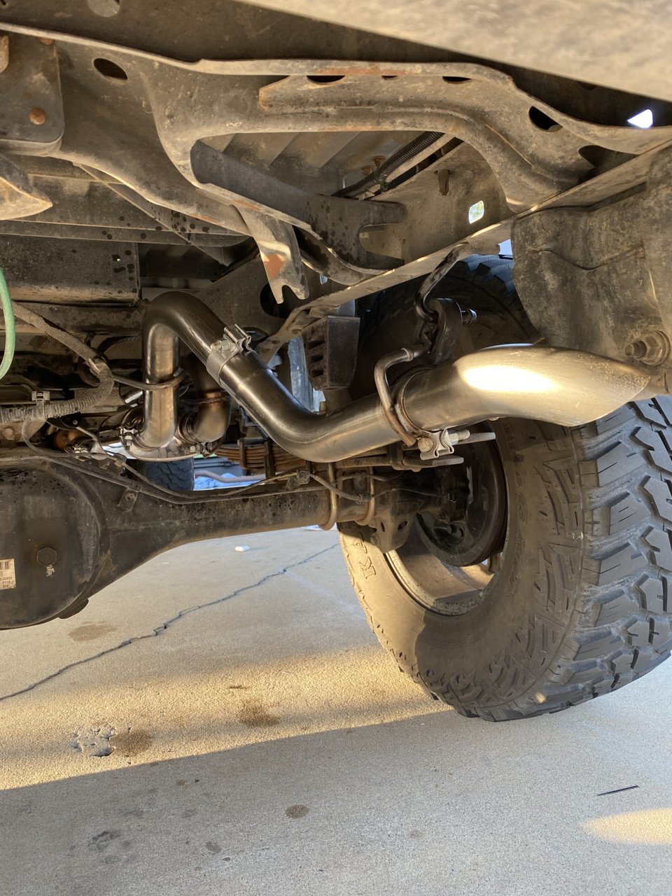

    Seeing this has worried me about my exhaust. It’s the magnaflow catback. The hanger is pretty black from the exhaust soot
