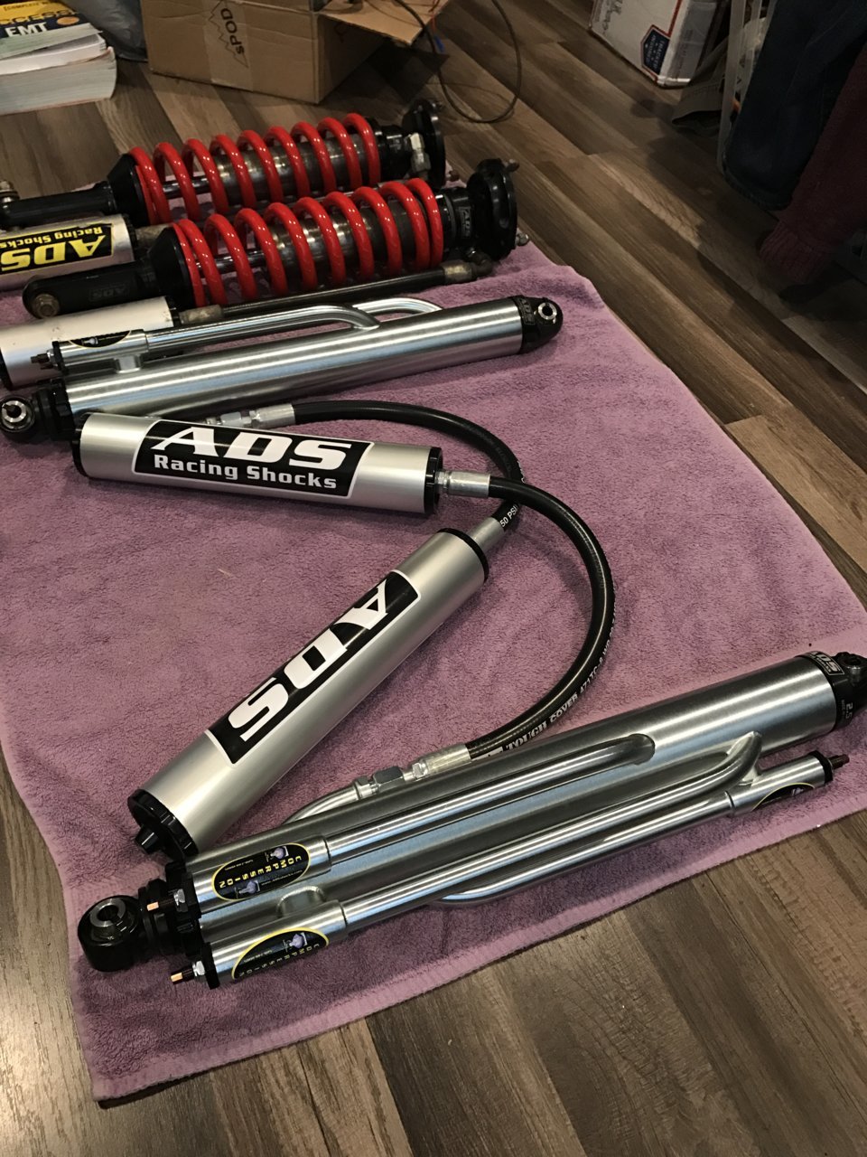

    Got my custom ADS 2.5x14 triple bypasses in as well as the relocation towers and shock mounts. Gotta page DMZ fab locally to see if they'll help me with the install. :thumbsup:

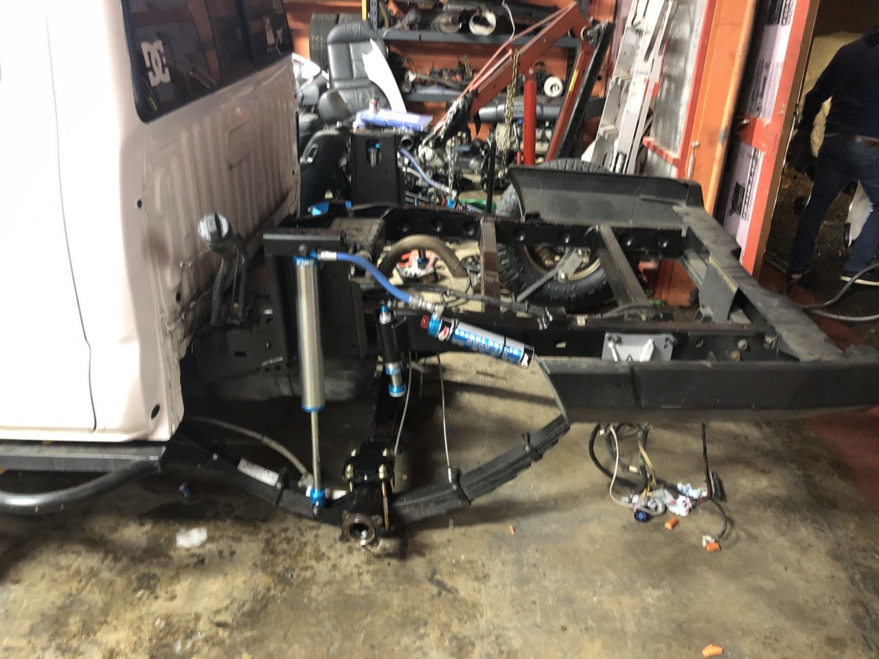

    Nice, the rear shocks look like a good layout
