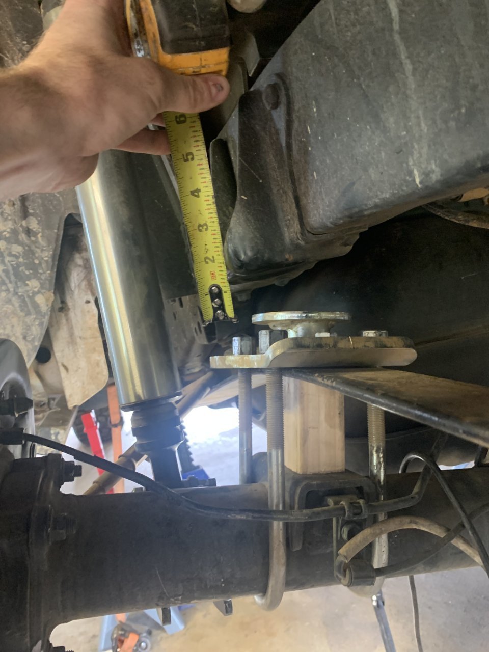

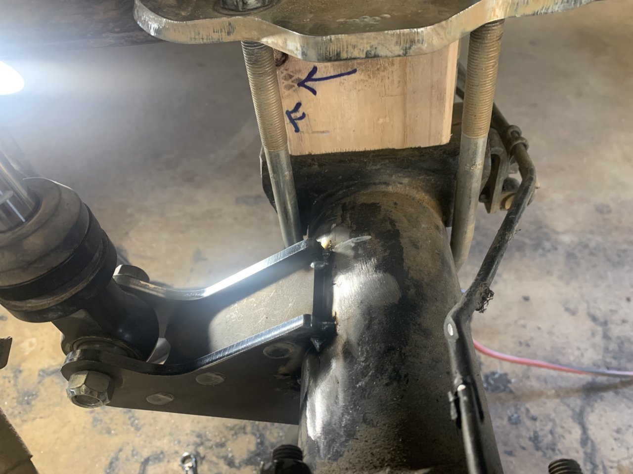

    Could someone with the relocate and 12” shocks do me a huge favor and take a picture from this angle? I went through the trouble of cutting off a mount since I thought I was bumped too high and came out at the same spot…
    if I clock it any more down I will lose droop but won’t fully compress the bump at full tilt if I leave it where it is.

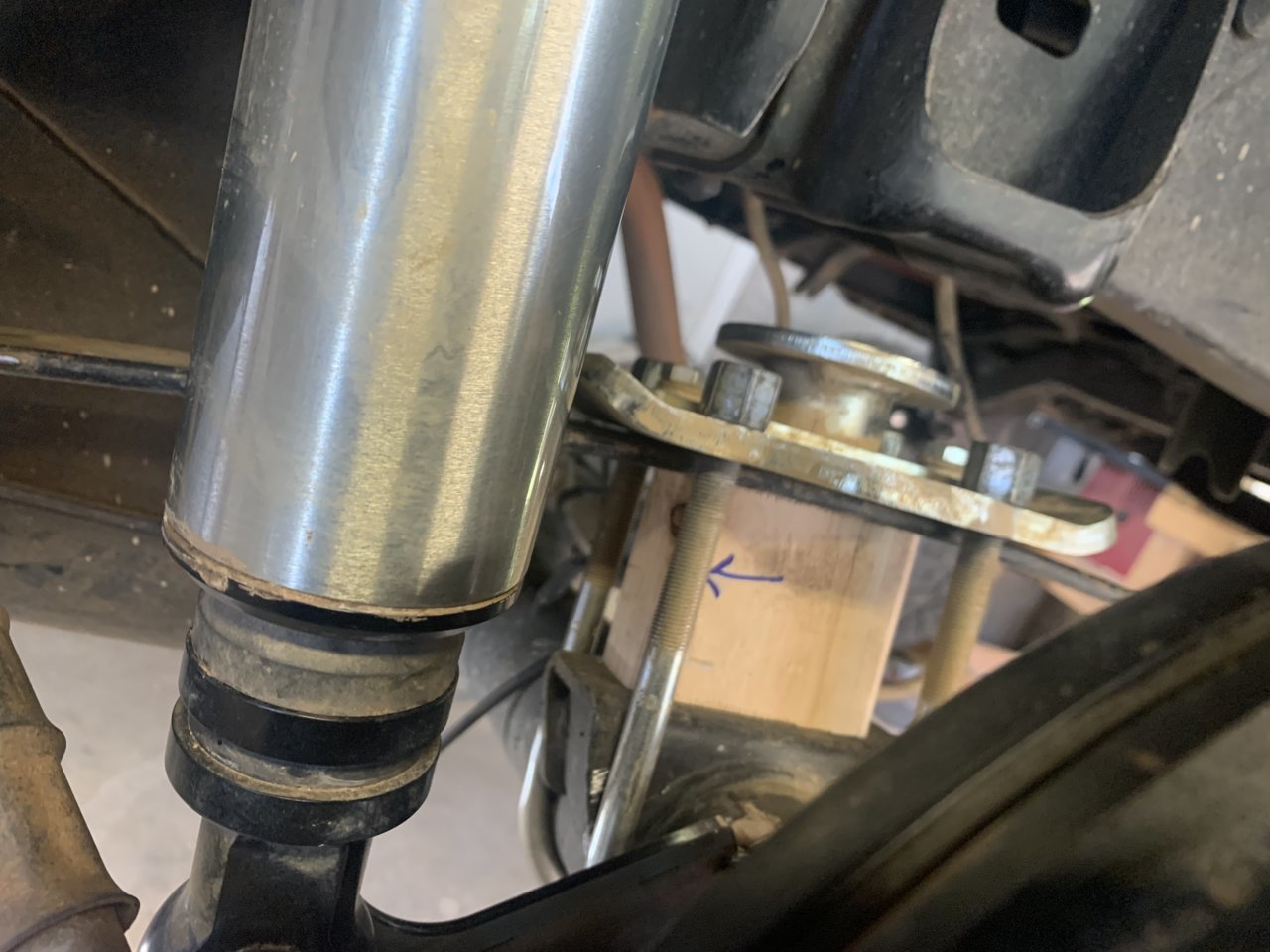

    I’m about 1.5” from the bump stop mounting plate at full tilt

    Scratch that. It’s clocked forward another 6 degrees from the first try which will give me another inch or so of bump.

    looks okay. Your block of wood looks a bit tall and you could just put the bump stops in there while cycling to get an idea how much they'll compress, those are more concerning looking at the pics
  8. Oct 16, 2021 at 11:28 AM

    maybe give your shock another .5 -1 in showing just in case too. Wouldn't want to rely on the little shaft bumps or shock internals too much. Even if you lose a little droop over it, it's better than losing money

    I was able to get the bump to lift the truck and be almost right at the end of the shaft. I still have about 0.5” of droop left in the shock so if another pack flexes better than the Dakars I’m good there too. I didn’t realize how little rotation around the axle it took to make a change. I thought I was welding the new one back in the same exact spot haha definitely don’t want to do this a third time.

    Just wanted to point out that you have the long lower rod end on the Foxes which adds another inch to the collapsed length. Looks pretty good though, you do have that tall Wheeler's bump stop stand which limits bump travel. Like @not_nick said, the wood black looks tall, and if the block of wood is taller than the actual leaf pack, that would give you a false reading that you have more protection against bottoming shock than you actually do with pack assembled.
    But you are doing it right, glad to see you articulated it for real world picture.
    You have this better setup that a lot of people with other brand relocations.

    I probably could have (and did for a while) got away with it how it was. I slid the rubber shaft bumps up to see exactly how much bump I was using and I never maxed out when both wheels bumped at speed. But if I stuffed one wheel crawling, I would ride the Fox bump and only compress the wheeler bump an inch or so. Hard to go fast and fully stuff only one wheel, but I didn’t feel right riding it crawling. I set the bump at full tilt this time. Gained an inch of bump and didn’t lose any down travel. Totally worth it.
    Looks tall, but that block is the same thickness and taper as the Dakar heavies and a 2.5 degree shim believe it or not haha. When I ordered the shocks from Accutune I told them it was for your kit. I’m surprised they sent a longer rod end and I didn’t know the difference when I got it. Is it worth swapping out?
