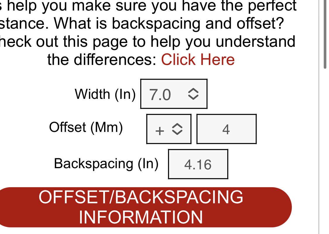

    T4R Pro SEMA wheel is 17x7 +4mm which puts them around 3.65BS, I believe. I could be wrong in my calculations.

    It would be 4.16

    Interesting, I thought backspacing was equal to 1/2 wheel width +/- offset.

    I can never remember the correct way to calculate it so I always use a calculator. Something to do with adding 1/2" to account for the lip or something.

    I didn’t think of that, thanks for setting me straight.

    I was never sure about the half inch thing. I’ll just add that in from now on.
