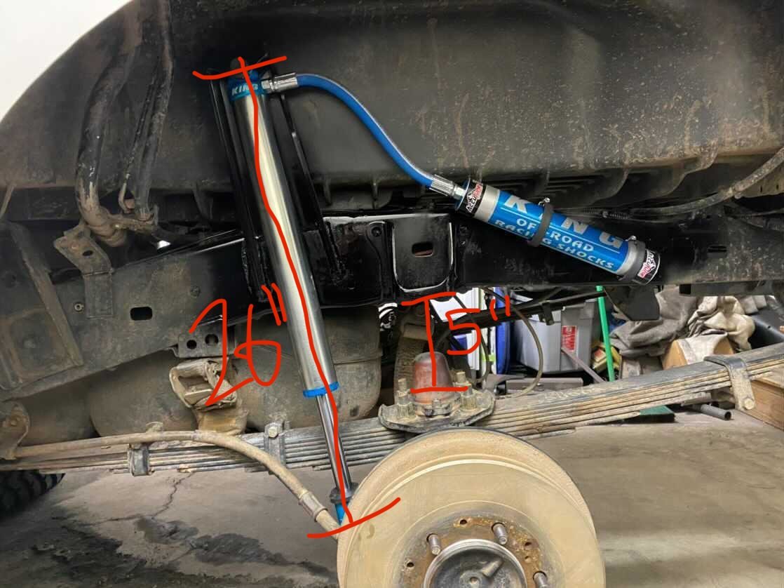

    That would be the best way, and I did do that on my truck but don’t bother on other trucks because it’s not totally necessary. First, I’ll set the axle on jack stands so the truck is sitting at ride height. Then I’ll measure from the strike pad on the frame to the point on the bump stop where I think it’ll compress to. I’m pretty liberal with this measurement and go fairly low on the bump stop to give an extra safety net. Then I add 1” on top of that measurement.
    So let’s say your shocks collapsed length is 20”.
    Let’s also say that your distance between frame strike pad and compressed bump stop is 5”.
    20” + 5” + 1” = 26”
    I’ll set the upper and lower mounts 26” apart.
    These numbers are made up and not applicable to any truck, but hopefully they help you conceptualize what I’m saying.

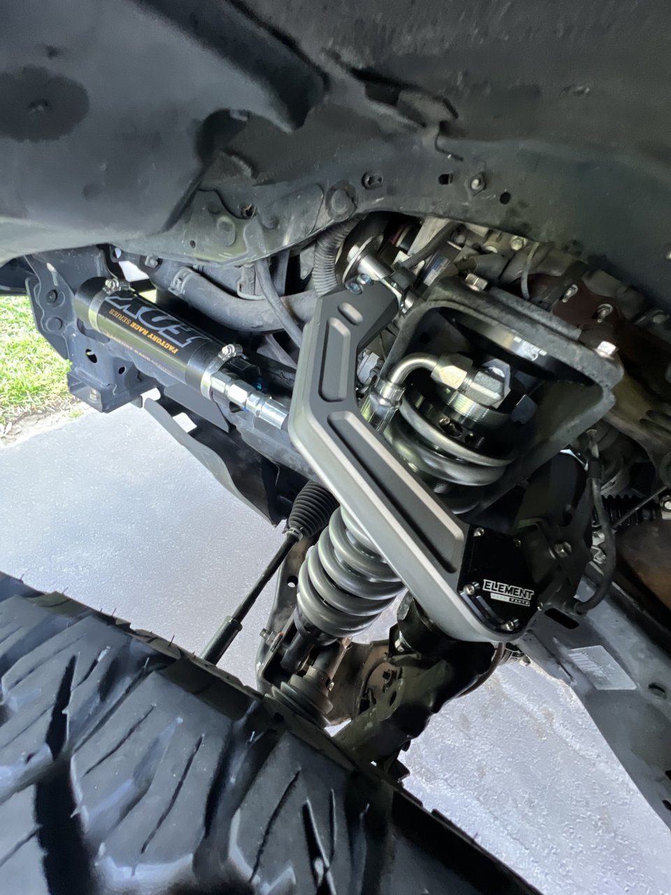

    00E837D1-3735-40CF-A386-A07FBD5EBAEC.jpg F96E8613-7287-4725-AAF6-C6CBEE796CC1.jpg 3CA85083-EE41-4740-8642-FBC69BA51C55.jpg 6BF0CFDA-4C4D-47E9-B4BA-E25F9A00D19B.jpg
    While I was busting my hump at SXSW the suspension gods paid me a visit. Haven’t picked her up yet…but damn she’s gonna be fun.
    (Note the spacers are an unintended consequence that will be remedied when we go from metric to inches on the tires. How, you ask? With new wheels…thank god my wife doesn’t read these threads)

    I see you have a clevis there on your frame. Is it for a limit strap? If so, what size you running?
  13. Apr 5, 2022 at 2:03 PM
    #853
    LastMohican
    LastMohican Well-Known Member
    Oct 20, 2013
    #114865
    180
    Mo
    Sin City
    TRD Sport DCLB 4x4
    They wound up to be 14” straps. Shout out to Battle Born Offroad for their excellent fabrication work. They actually mounted everything up, then ordered the straps. I went with Deaver Stage 2’s and Accutune 12” Remote Reservoirs. We haven’t put the cross member in that connects the hammer hangers. All-in-all, its a totally different truck. It was tired, loose, and had crappy components on it. Now, it feels incredibly capable…but underpowered. I’m now scheming for ways to re-gear and supercharge. FUN.

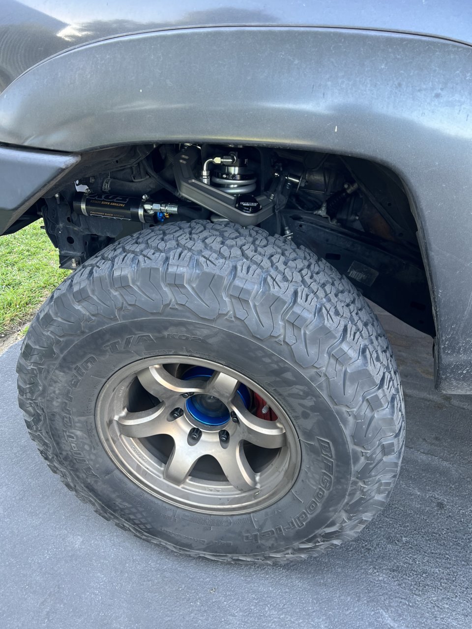

    After some flex testing I definitely need to pick up some wheel spacers, as expected. I’m running 315/75/16’s on 16x8 wheels with 4.00” BS and -12mm offset. After reading through what everyone else has said about wheel spacers I’m assuming 1.25” spacers would be enough. I’m shooting for as small of a spacer as I can get away with but also don’t want to end up buying twice. Any opinions?

    4.00" BS has been somewhat rare in the past and so it hasn't been talked about a lot and what spacer works for 315s. A 1.25" spacer may be enough, but can't say for sure.
    3.5" BS is common, and several have ran 285s without a spacer with 3.5" BS and this 2.5" relocation, but with 315s people need a 1.25" spacer with 3.5" BS.

    That sounds about right. I was running the KO2 315x75x16s with 4.5" BS and needed 1.5s to clear.

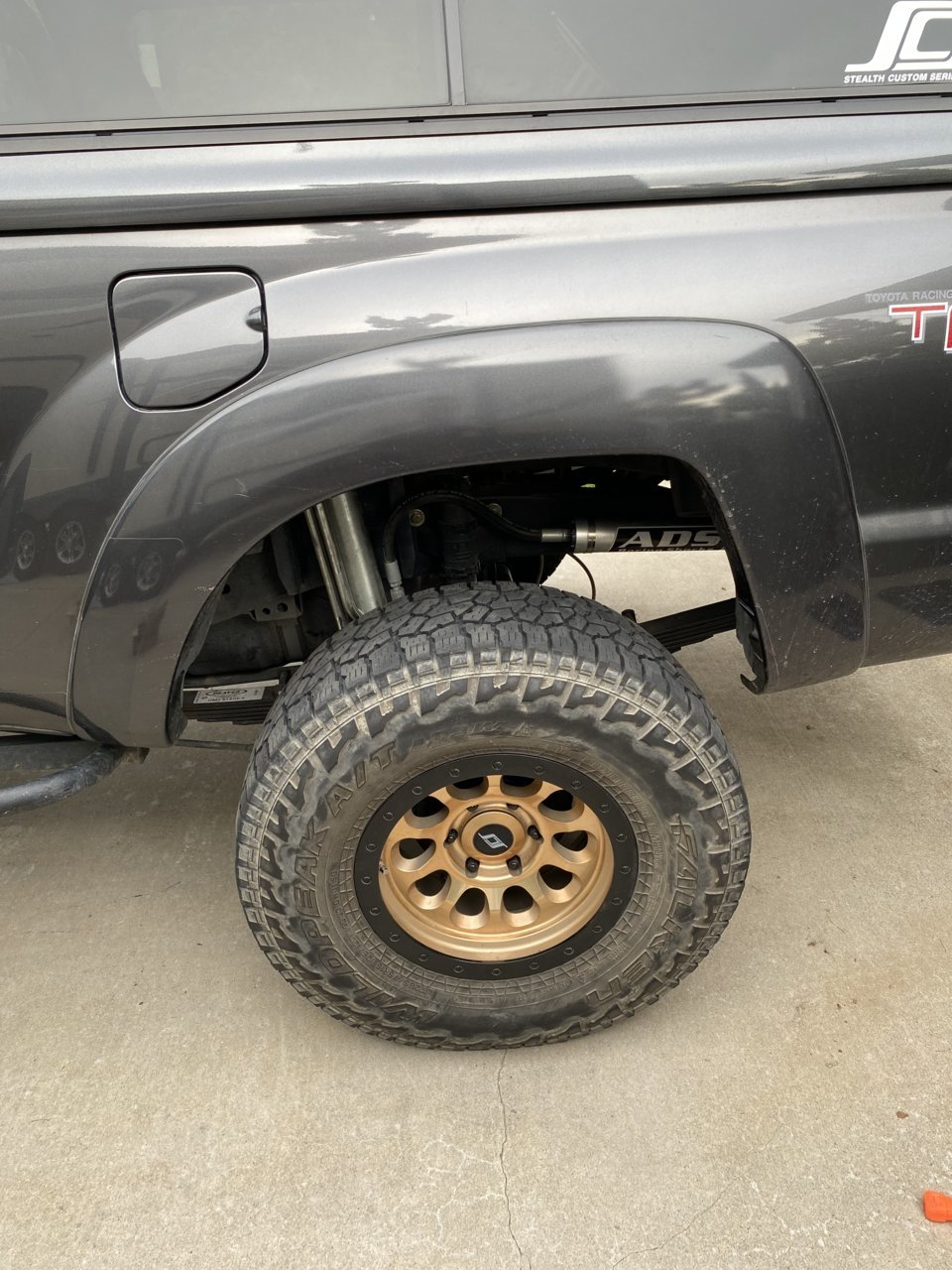

    @hungoverland on IG, King 2.5" EXT Travel w/ Archive Garage shock relocation, Icon RXT leafpack, 285 Nitto M/T's, bronze Raceline Defender wheels, TJM front/rear bumpers, TJM Sliders, Prinsu Cabrac, Katzkin leather, RSI Smartcap EVO topper, OV Tuned, MESO everything, Spyder headlights and tail lights, center mounted infant restraining system (CMIRS) \m/
    My Raceline Defender wheels are 4.5” backspacing w/ 0 offset and am waiting on my 12” x 2.5” Kings to arrive (~June/July) from Accutune for my relocation towers that arrived days after ordering (thanks @ARCHIVE ). Just want to ensure I have everything needed for when the shocks arrive— Icon RXT leaf pack, extended brake lines, and whatever the smallest wheel spacer I can get away with. With 4.5” back spacing do you think a 1” spacer will work? I am running 285’s now, but will most likely make the jump to 34’s or 35’s next.

    I can't speak to wether or not 1" spacers will rub with your 285s, but based on my experienece, you will almost definitely rub with 1" spacers running a 35" tire and 4.5" backspacing.
    I just barely cleared with the 315x75x16s which comes out to like 34.6" tire, so I might even suggest a 1.75" spacer if you jump to a true 35. Just my .02 cents.

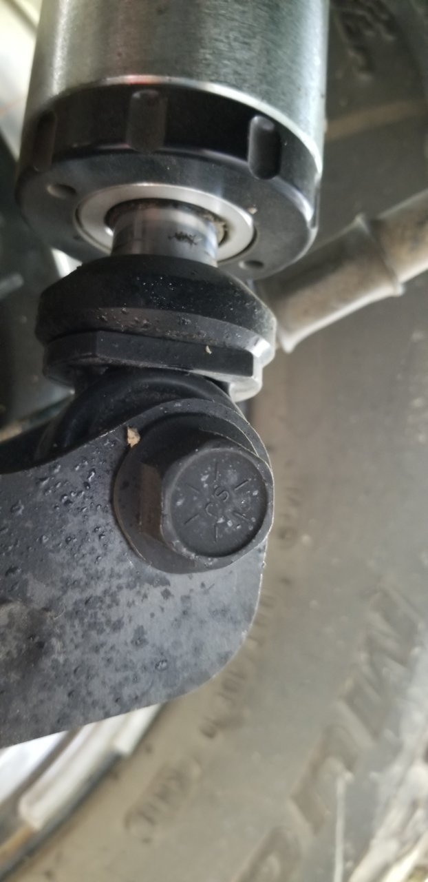

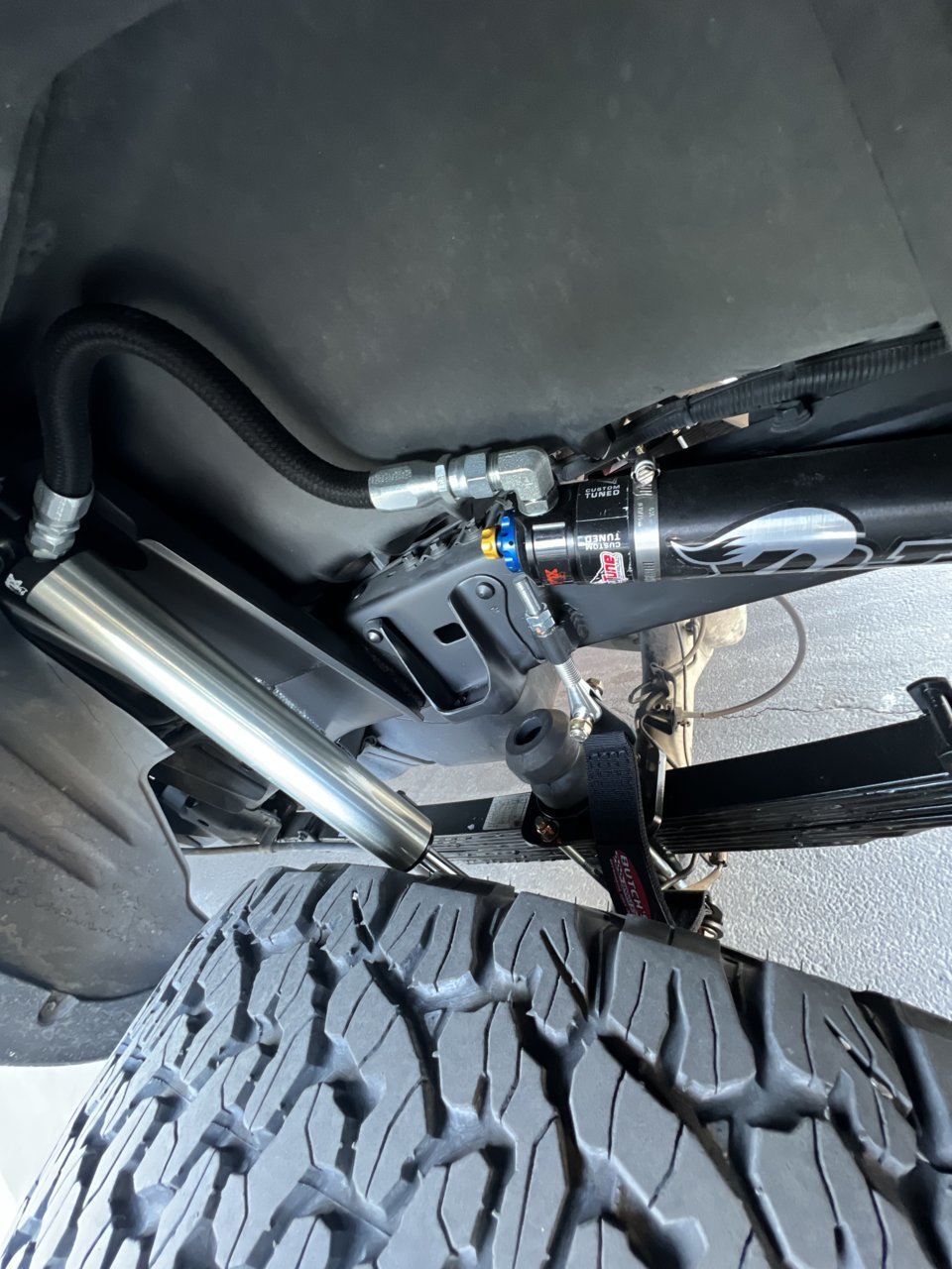

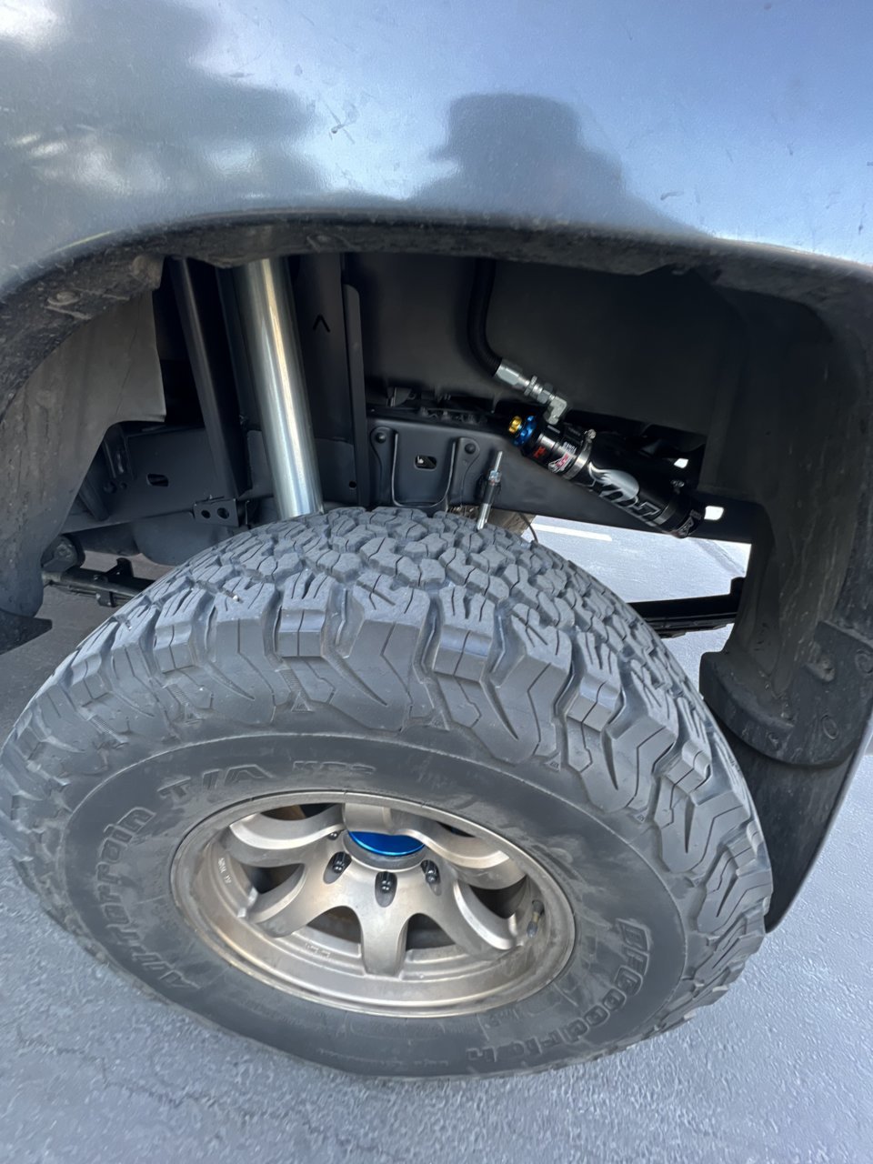

    Just wanted to give a shout out to @EatSleepTacos for this post. I followed these instructions when installing the lower shock mounts and they came out pretty well. At full stuff I have about 1/2" of bump travel left (see first photo below). With 1.25" wheel spacers I'm getting a little tire rub on the shocks (see mud on shock in 3rd pick below), so I'll pick up some 1.5" or 1.75" spacers. For reference, I'm running ADS 13" smoothies, Deaver U402 Stage 1 leaf pack, hammer hangers and Archive U-bolt flip Option 3. Tires are 255/85r16 BFG KM3's on stock rims from my 2020 TRD Pro (7" wide, 4.5" BS). FWIW, the angle of my lower mounts ended up being -4* (in comparison to the diagram in the Archive instructions). As stated in the directions, each setup is different and the diagram is a guide.
