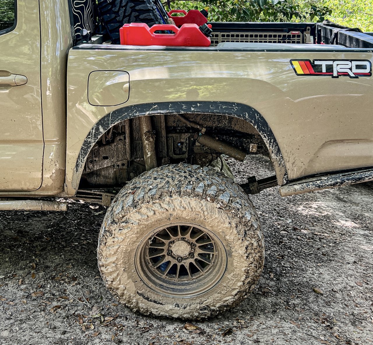

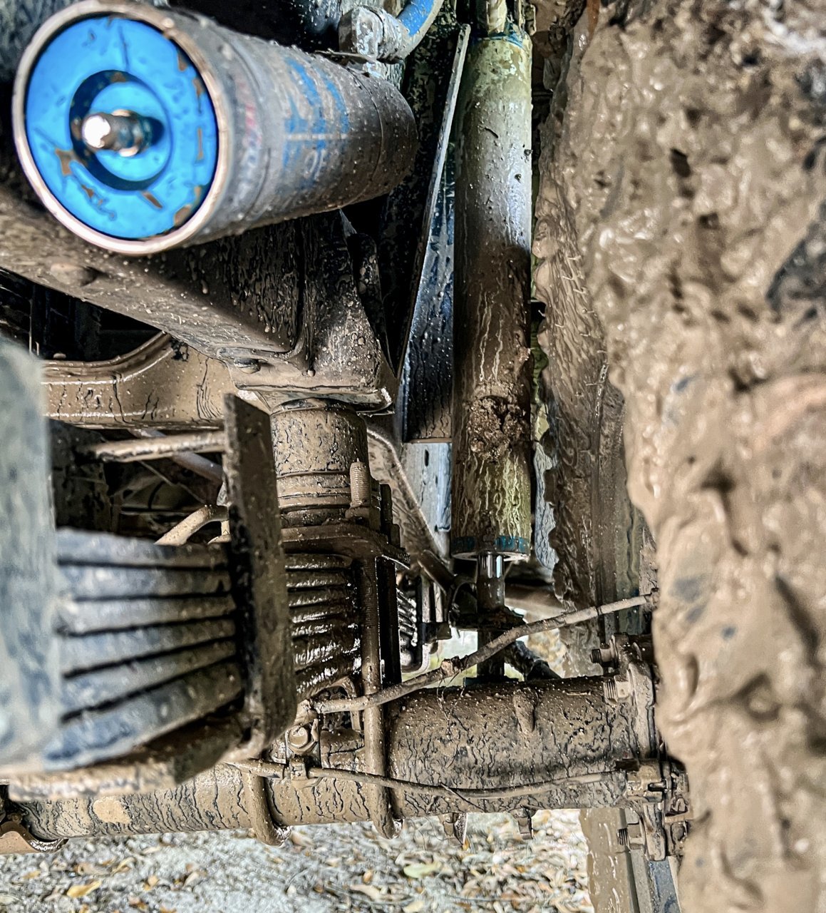

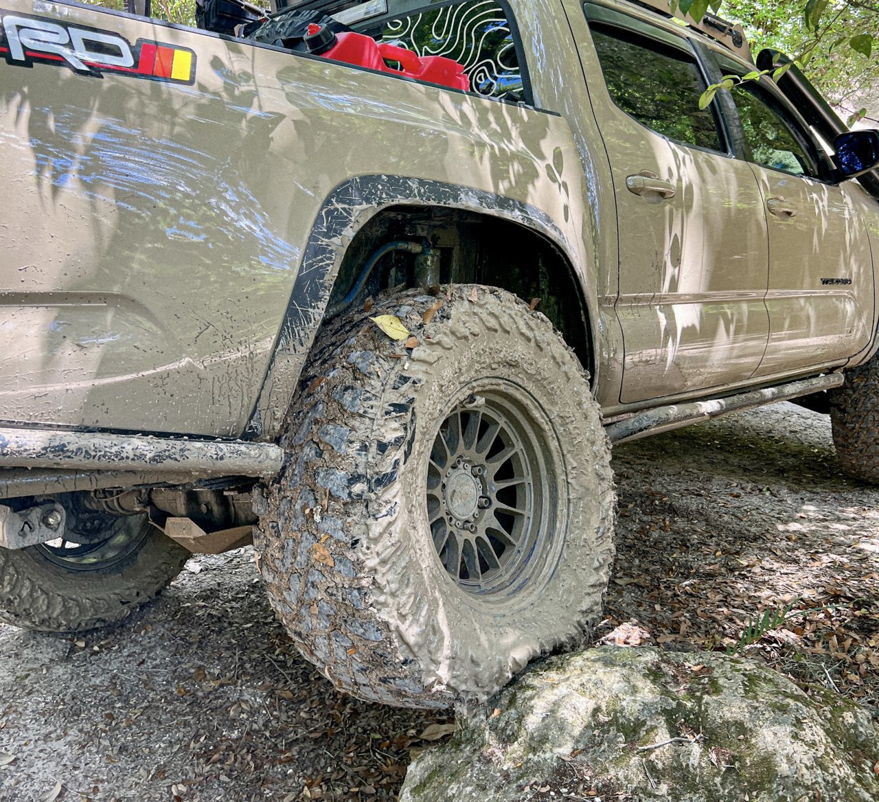

    I could not be happier with this set up, such an improvement. My first trip out with the ext rear was this weekend and I have to say I'm super impressed. if you're on the fence go for it these things are amazing. The amount of flex and control are greatly increased. For the price, quality of the parts and the install time, it's hard to beat what this set up can do. My rear end feels more planted on and off road. It's just an overall great kit.
    For reference --
    I have the hammer hangers with HC cross tube, a generic U Bolt flip kit, OME Dakar Heavy Duty springs, 17x9 with -25 offset and 35s. This combo flexes so much that with my set up the inner tire will make contact with the shock body while flexing. I will need spacers for the rear. It has been discussed before, I'm just agreeing with it and sharing my experience.
    The pics were taken on a test rock mid way through the trail ride aired down to 16psi.
    Here you can see where its just starting to contact the shock body and I still have a little more to go on the bump stop. With the right bump stop set up, brake lines and wheel spacers, there is way more flex. A little over 5 inches of rod showing on the shock. This is where thinner tires or more aggressive offsets will help with the up travel.
    These next 2 pics are to give an idea of the axle in relation to the truck. The pics are a little misleading because I have my fenders cut up super high. With stock fenders the tire would be making contact.
    Here you can see the mud patch where the tire rubbed on the driver side shock body.

    It may just be the caked on mud that's rubbing and not the actual tire. First time I flexed it I had mud smears on the shock but it was super muddy and the tires were caked with mud. Last couple times out it has been dry and I havent noticed any rub marks, so you may want to wait until you can flex it in dry conditions to be sure the tire itself is rubbing.

    Thanks for the heads up, but ya they are rubbing. Once the mud was removed you can see the spots on the shock body.
