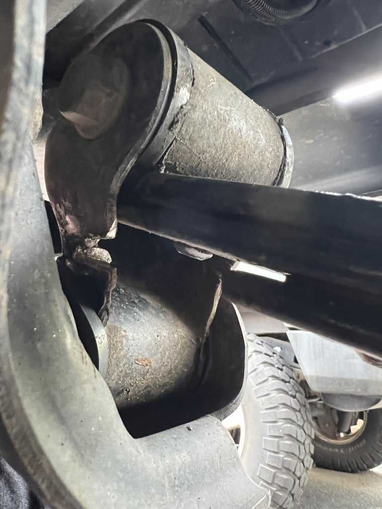

    Dobinsons springs are no longer accepted as good out-of-the-box, they NEED 2nd leaf trimmed where it extends inside shackle cavity. Stubborn Aussies don't understand the Tacoma shackle design, they trudge along with their designs for Hilux shackles even after you explain it to them. See pic
    Deaver is pretty good. We are working towards our spring offerings, and our MD springs should be just right for you.
    Dobinsons 112 cutting up shackles with stock hangers:

    The 3.6 do help, but it's impossible to design around Dobinsons and Dakars, they make 2nd leaf so stupid long, unless you convert to Hilux shackles
    There's a new inexperienced hanger brand, that doesn't have 7 years experience making hangers like Archive, who incorrectly states no trimming is needed with their shackle.
    Key-Rei[QUOTED] likes this.

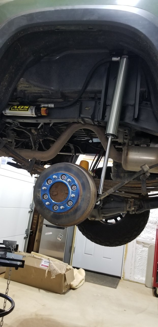

    does the diagonal reservoir mounting bug anyone else... or is it just me. why not order with a longer hose and proper fitting?
  9. Jun 18, 2022 at 8:32 PM
    #889
    Mojo Jojo
    Mojo Jojo Well-Known Member
    Jan 21, 2020
    #316845
    2,591
    Mark
    Harpers Ferry, WV
    2020 Pro AG MT, 1997 Land Cruiser
    Tacoma: mid-travel on 33s LC: 3.5” lift on 35s
    Like ADS does?

    I’d say most would agree a flat resi is visually pleasing. I think most would also agree it’s not worth the extra cost and potential extra wait for the longer hose when it’s purely aesthetic.
    edit: in reference to kings

    My Fox sit flat, longer hoses are a thing
  12. Jun 19, 2022 at 8:11 PM
    #892
    Mojo Jojo
    Jan 21, 2020
    #316845
    2,591
    Mark
    Harpers Ferry, WV
    Ditto, mine came that way standard.
    Edit: I have ADS

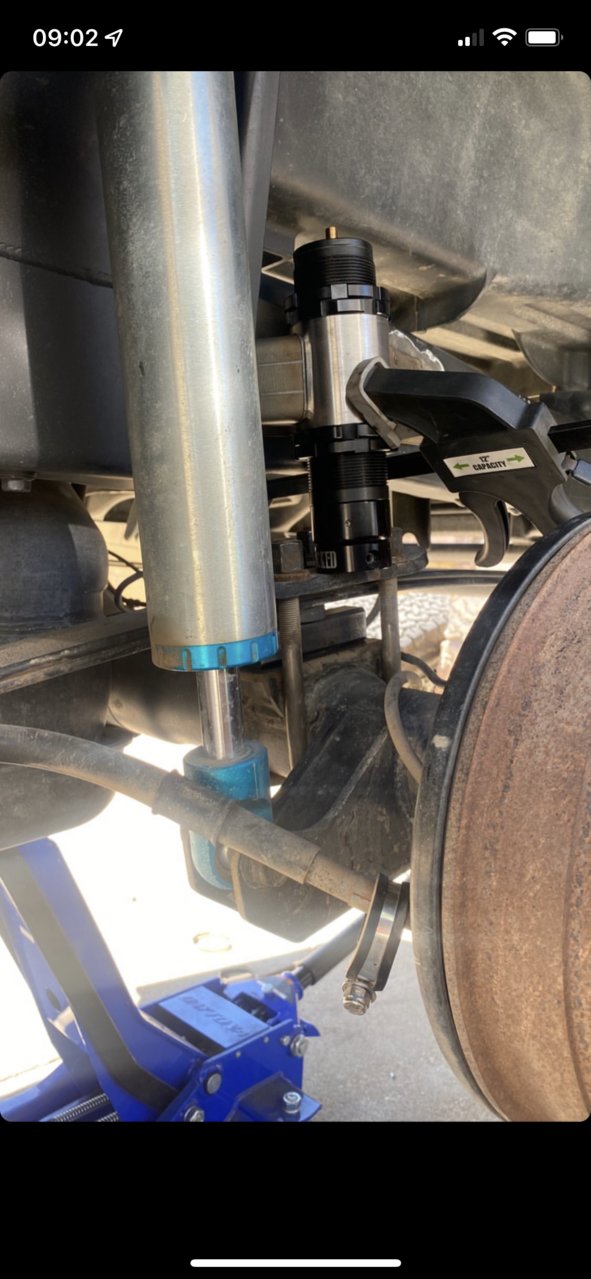

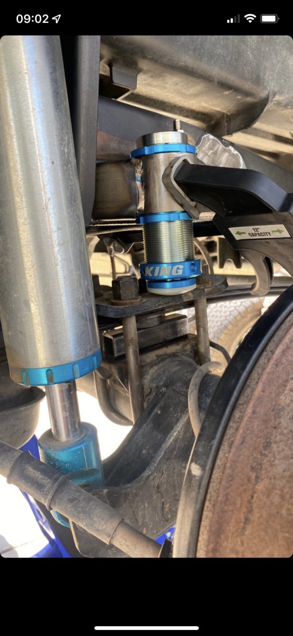

    BurlyJim likes this.
  18. Jul 3, 2022 at 1:41 PM
    #898
    ARCHIVE
    ARCHIVE [OP] Well-Known Member Vendor
    Oct 29, 2015
    #168099
    2,246
    Eric
    Orchard Park, NY (Buffalo)
    '05 Taco, '22 Tundra, '91 Cummins
    2.5" Fox relocation * Hammer hanger * Archive MD springs
    As proved by the pictures, our relocation allows all the bump travel due to our appropriate tall towers.
    First, you can see the axle is horizontal, so the shock needs to have another 1" to allow for articulation of axle while bump is fully compressed (shock is outboard of leaves and bumps).
    Second, whoever is setting that up is limiting the up/bump travel with the air bumps which in the case of the King bumps are adjusted all the way down, BUT in both pics, the bumps can go upward at least 1" more, which means the setup as pictured could be adjusted with bumps to using full up travel for all possible situations of that combo.
    Of course the axle tab we provide could be adjusted up and down as well
    Eric
    Attn competitors who come in and read our information and copy us because they are lazy, go be an accountable adult and figure it out yourself you little baby
