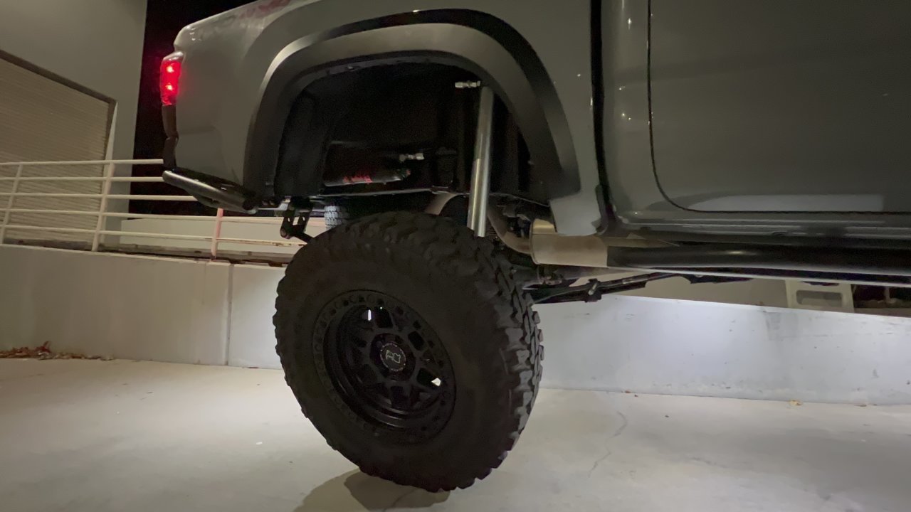

    ADS trips
    N7ekWMVcpUksM4FTTXTPVF0gW5d-idI--BdQ-iQb_66fa2e8c8951f5e21aae969801f0db29251052ec.jpg

    Those are sweet. 13" travel?

    12", springs max at 12". Plus can still manage to use them if I go spring under

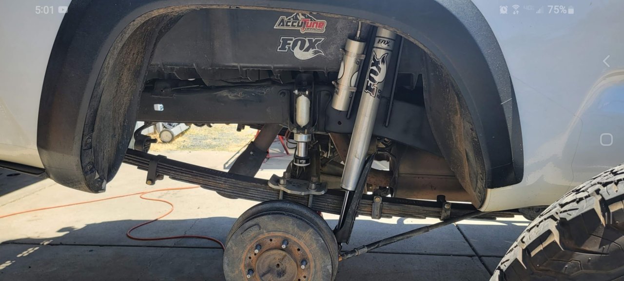

    I added fox air bumps. Had superbumps and they would send my ass end to the moon. The air bumps make some noise but completely solved the pogo feel of the rearScreenshot_20220206-170153_Photos.jpg
