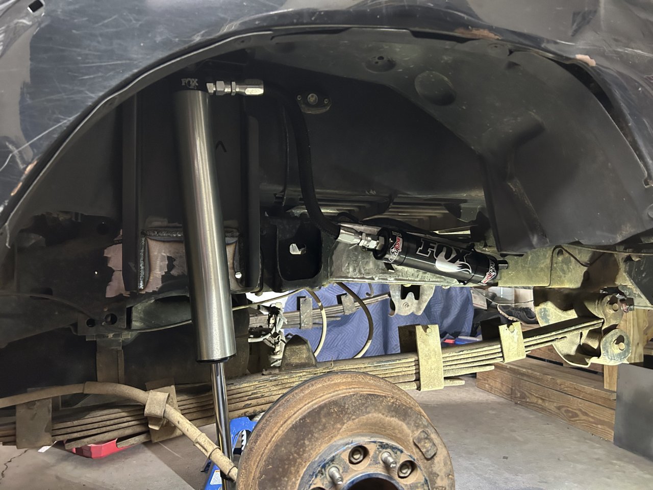

    If there's a remote resi, depending on the length of the hose, it might need to mount where the old shock mount is.

    All of them.
    I don't have a pic of the driver side on hand but with the Fox setup the resi mounts to the shock tower. I'm not sure how the kings go Screenshot_20220206-170153_Photos.jpg

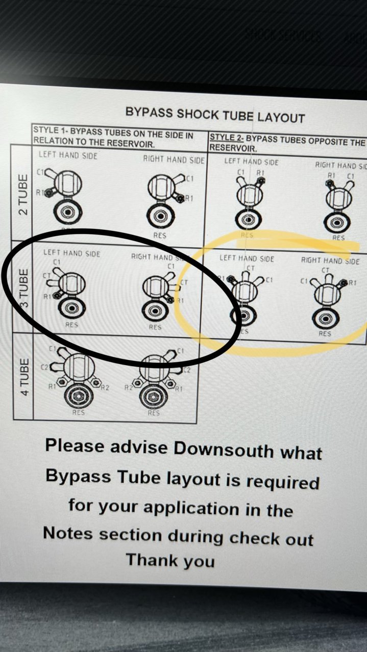

    out of curiosity:
    @ARCHIVE Is Style 1 Possible (king 2.5 12" Triple Bypass) with -38 offset wheel and a 35x12.5
    planed on ordering 12" 2.5 King triples in style 1 will run an adjustable King Bump Stop
    Wheel: 17x9 -38

    Can you post the diagram of King triple style #'s, that comment was 4 years ago, and I don't remember which layout number works

    sure thing @ARCHIVE
    King shock #KRS-PR2512-BP3H (remote resi)
    Black circle would be style 1, yellow style 2

    Style 2 triples is the best way and our recommendation, pics on our site of style 2 in our tower. Otherwise tubes in style 1 will be much farther out requiring much more wheel spacer.
    I think a 35x12.5 on 3.5" BS wheel and style 2 bypasses would likely require at least 1.25" spacer.
    As a point of reference, A 285 tire on 3.5" BS wheel with smooth bodies has not needed a spacer for several customers
