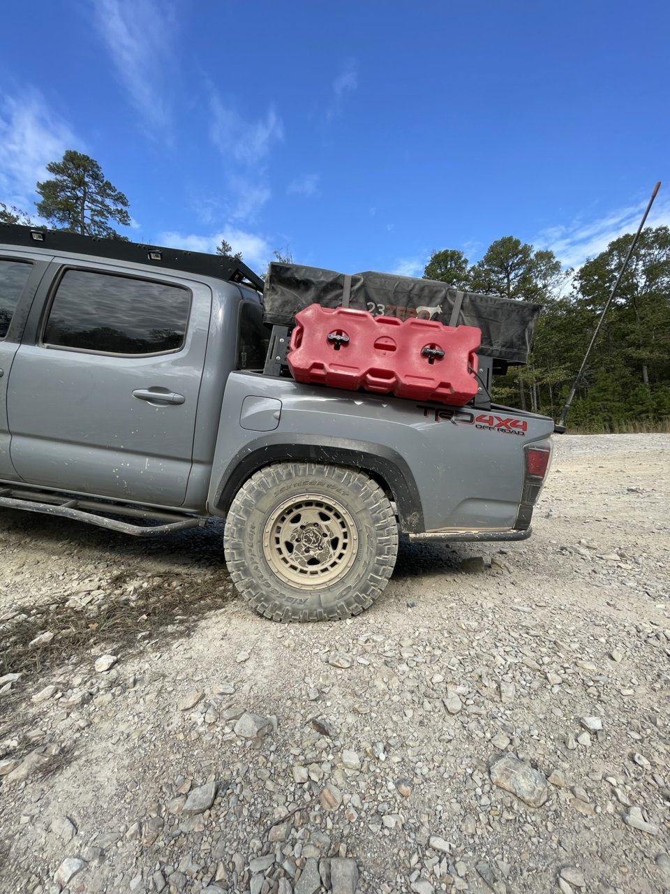

    She’s a thing of beauty.

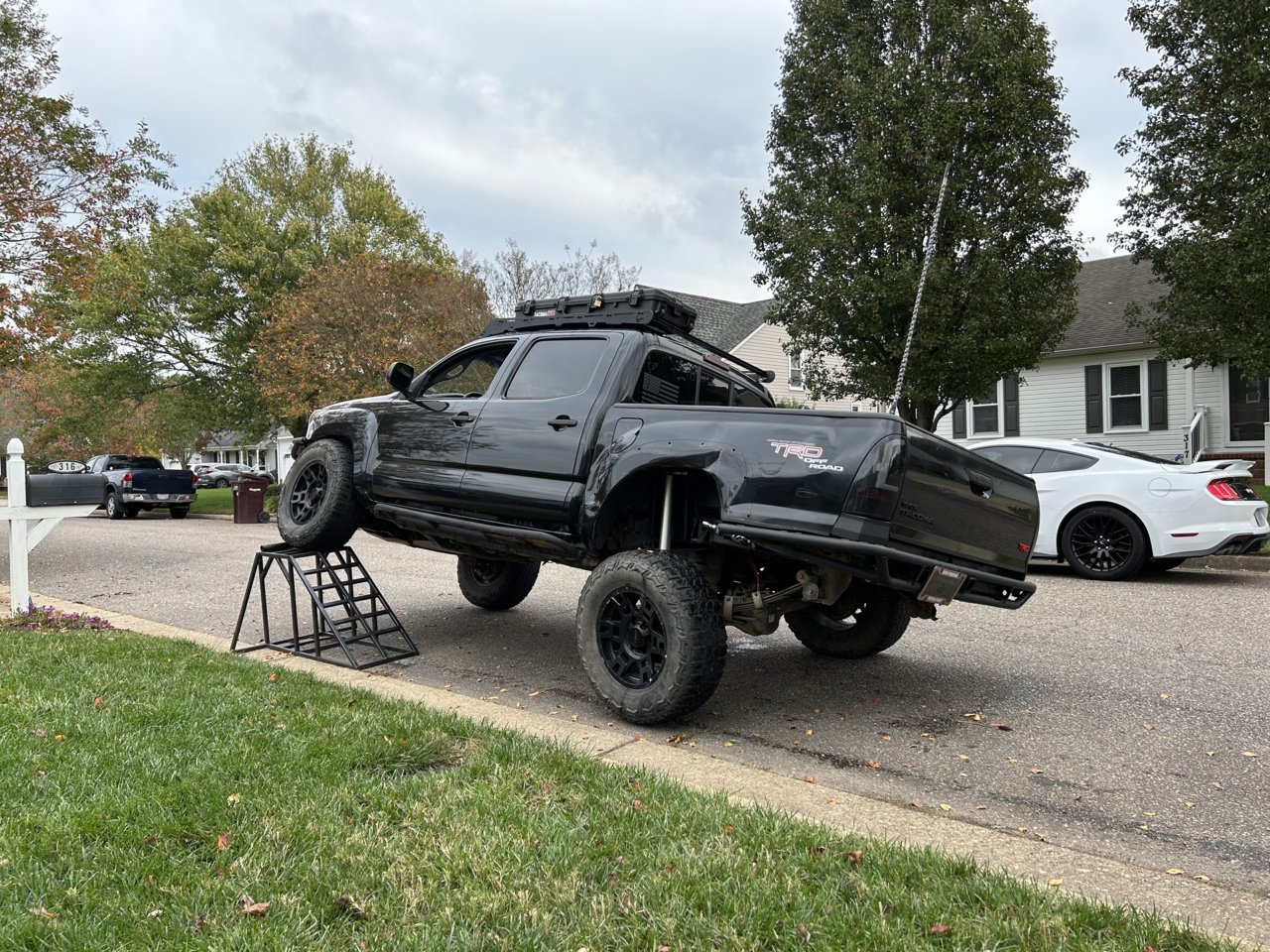

    I know this is an old post but seeing the stock steel wheel in the picture... I would like to know if those stock wheels clear the shock? I hear the relocation kit pushes out the shock out a bit which would or can come in contact with the tire. I am only asking as I am running FJ Cruiser steel wheels with spidertrax spacers on 315/70/17 (35s) and am considering this kit.

    Those steelies look good. The pic is my Tacoma running FJ steelies ~4.75" backspace, with 255/80-17 and 1.25" Spidertrax spacers.
    With 315s on same wheels, you'll need 2" spacers
    Its_Taconie[QUOTED] likes this.

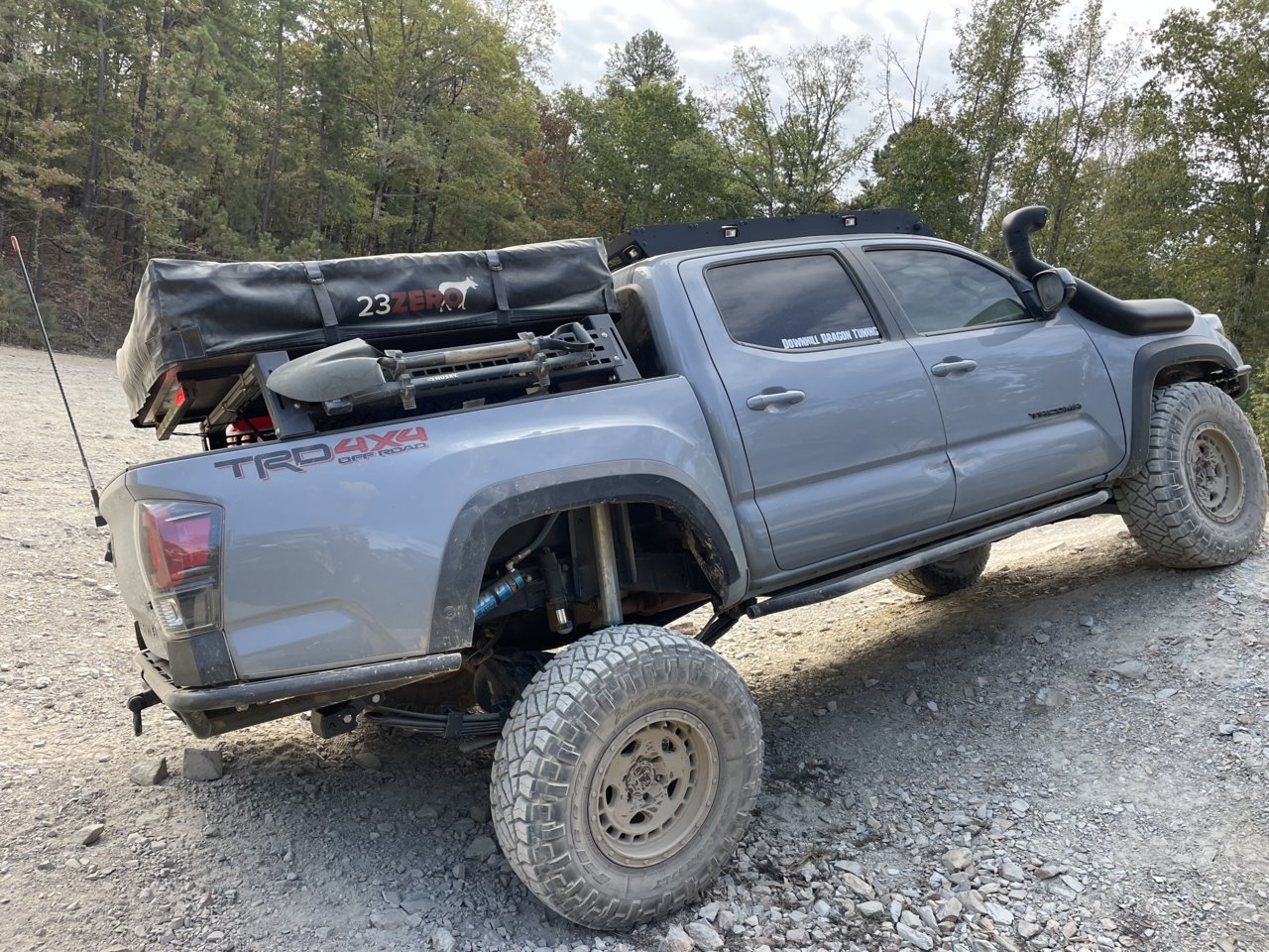

    I'm running 35/11.5/17 on a 4.75" BS wheel with a 1.75" spacer and it clears

    2.5x12. Still need to trim the fenders but nothing rubs

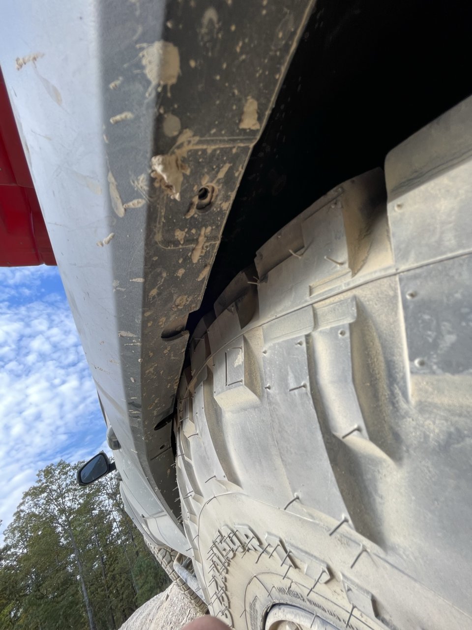

    Appreciate the response. You wouldn't happen to have a pic of the back side of the tire and shock clearance, would you?

    Not flexed out, I need to take one. Only picture I have is the truck sitting level

    Thats plenty of room. Thanks again and thank you Eric @ARCHIVE for answering my questions. I got some researching and thinking to do.

    It looks like a lot of room until the tire is fully stuffed. The tire moves in an arc toward the truck as it articulates up (since it has to stay perpendicular with the axle), so that space gets taken up pretty quickly.

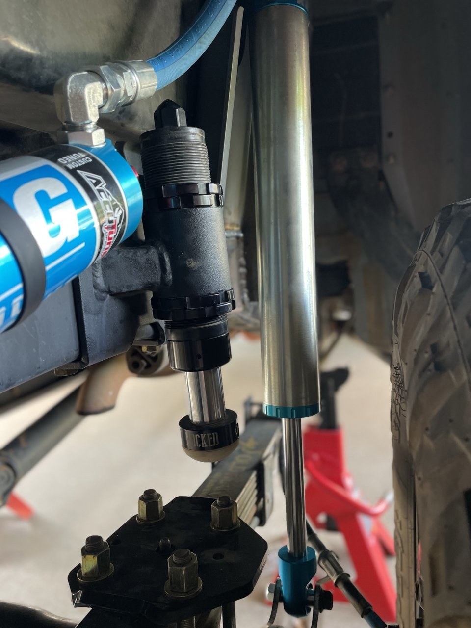

    Got my shock relocation done today. I was very impressed with the quality and fitment of all the archive garage mounts.6533491B-CB51-48BB-9E01-84BCF9BBDF48.jpgD293C096-2BF2-4395-8D9F-702F5AFE20B8.jpg

    Thank you!
