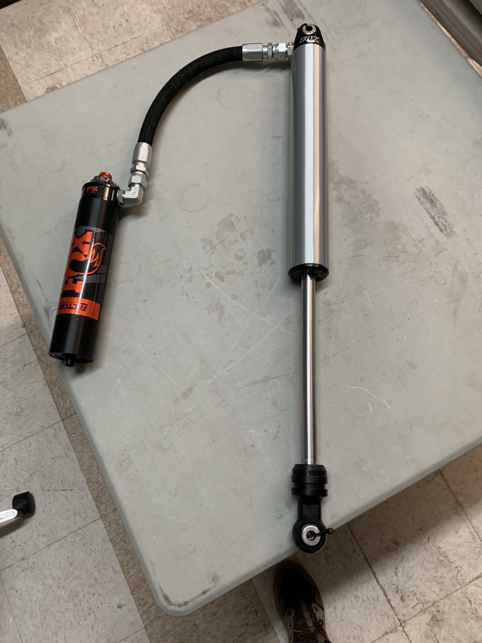

    Pics of shocks por favor

    Sure. Now I just have order the new DSC knobs for my frontsB0AF03D8-F027-434B-A794-6BBFA3E3C556.jpg

    Thanks, they look good. Hey the hose should be rotated 180deg so the elbow is above the resi like the last pic in post #1. This allows the best position on the frame rails
