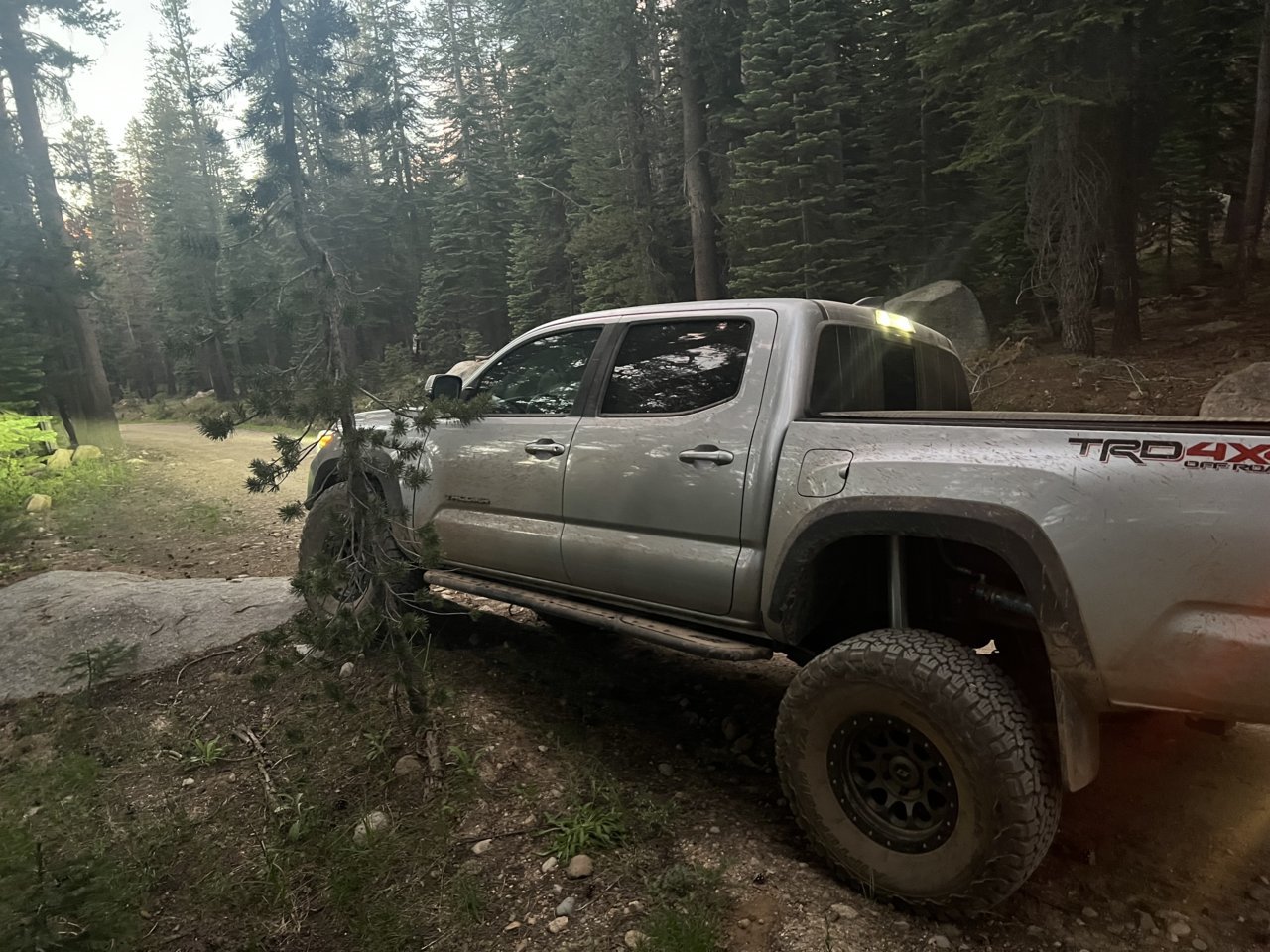

    I’ve been busy but finally found some time to get out and see a sunset. I didn’t have much time because the better half was getting impatient but I found a lil’ bump to stretch. So much room for activities back there now!
