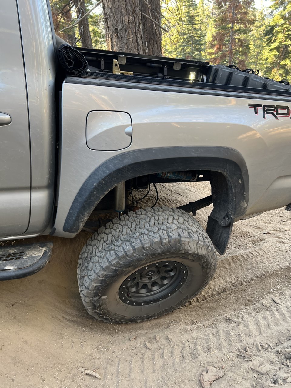

  10. Sep 14, 2023 at 7:15 PM
    #1070
    cowfootball
    cowfootball Well-Known Member
    Jul 4, 2022
    #400664
    806
    South Lake Tahoe, CA
    2022 TRD OR
    Tried my best to find a hole to stretch her legs but ran out of wheel well for my 35s first.
    LOLLY, Jadamjr and ARCHIVE[OP] like this.
