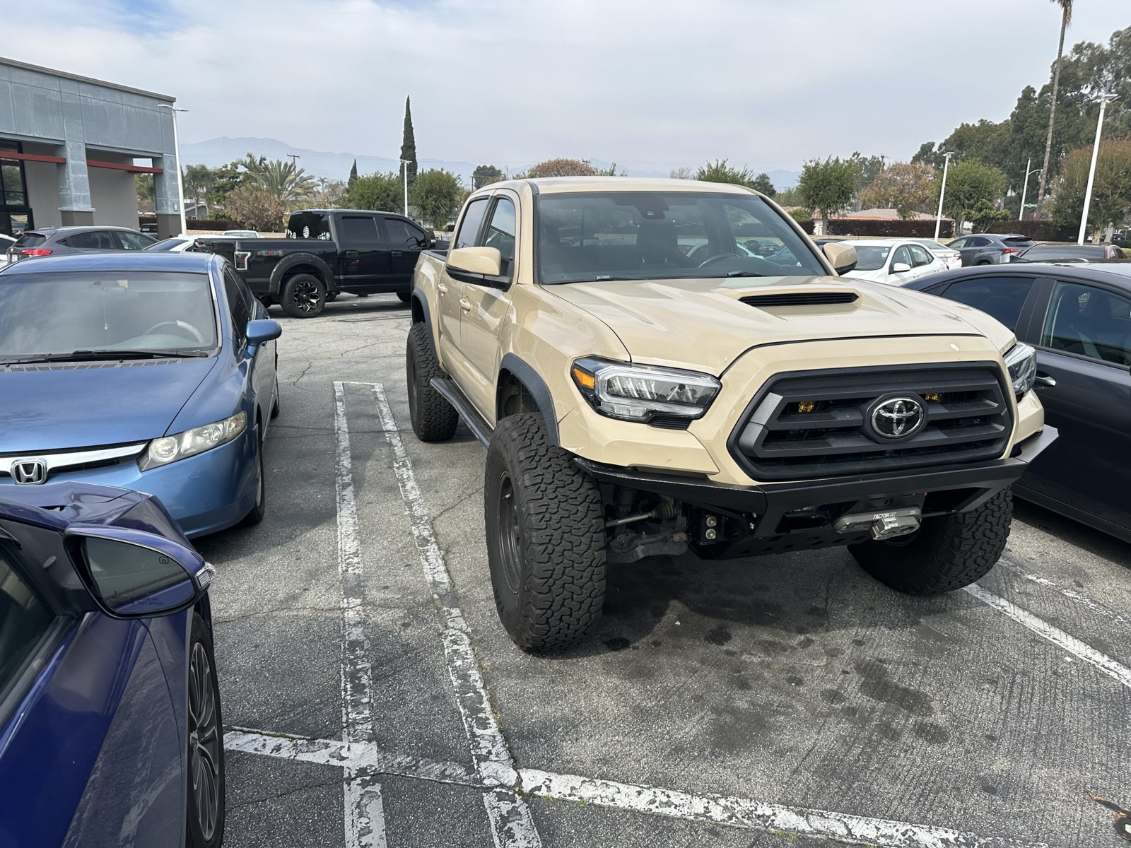

    I saw a third gen the other day with 5160s mounted up. I was hoping I could catch the person on here, but haven’t had luck. If you ever see this truck around, stop them. I was leaning kings, but after seeing the bilsteins, I’m thinking about going that direction. IMG_2045.jpg
    MrTreehorn likes this.

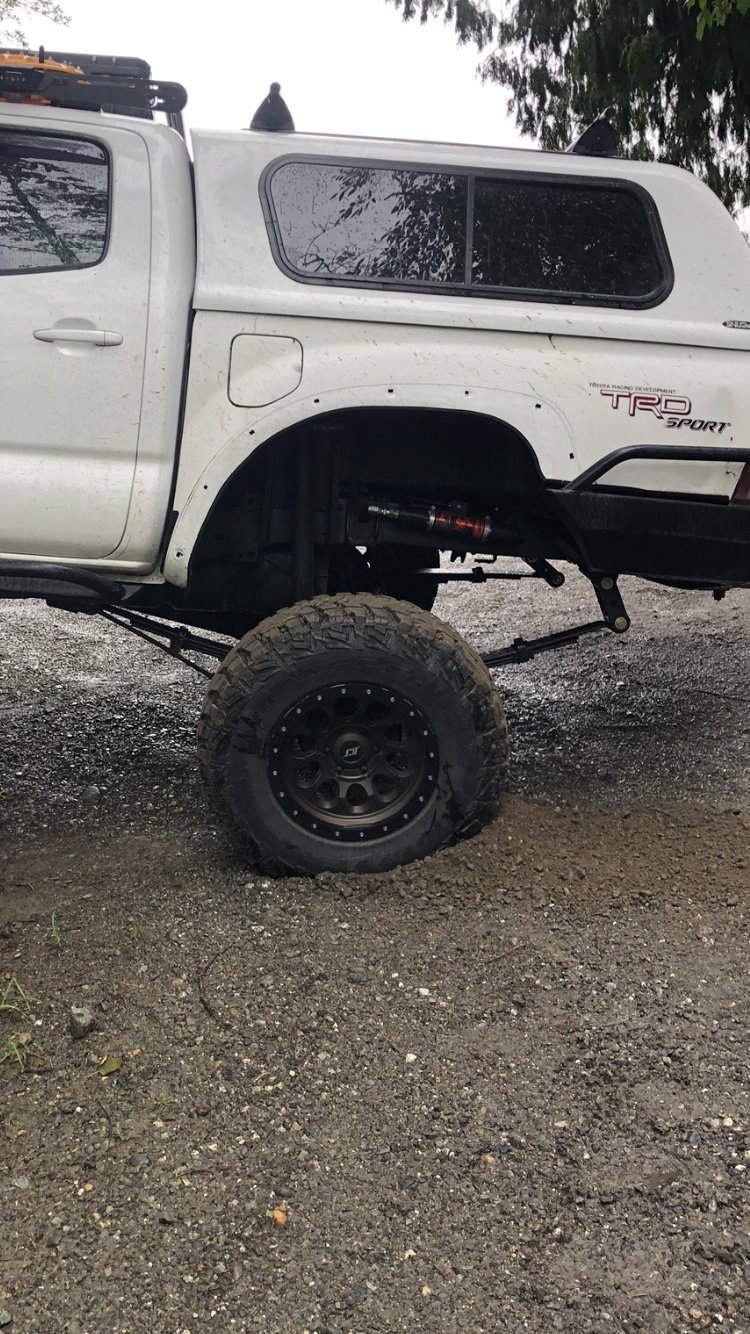

    I'm having good results with 3 year old dobinsons. Still easily hold arch after loading my tools in and out for work. This was yesterday , 34's for refrencePXL_20240225_202124283.MP.jpg PXL_20240225_202117820.MP.jpg
    ARCHIVE[OP] likes this.

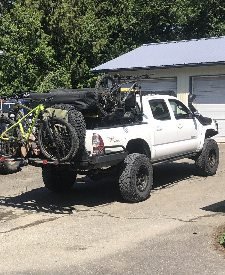

    IMG_7495.png Chevy 63’s use the entire 14”.

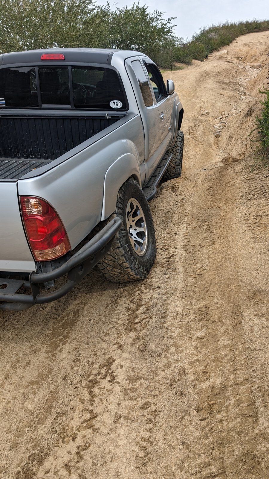

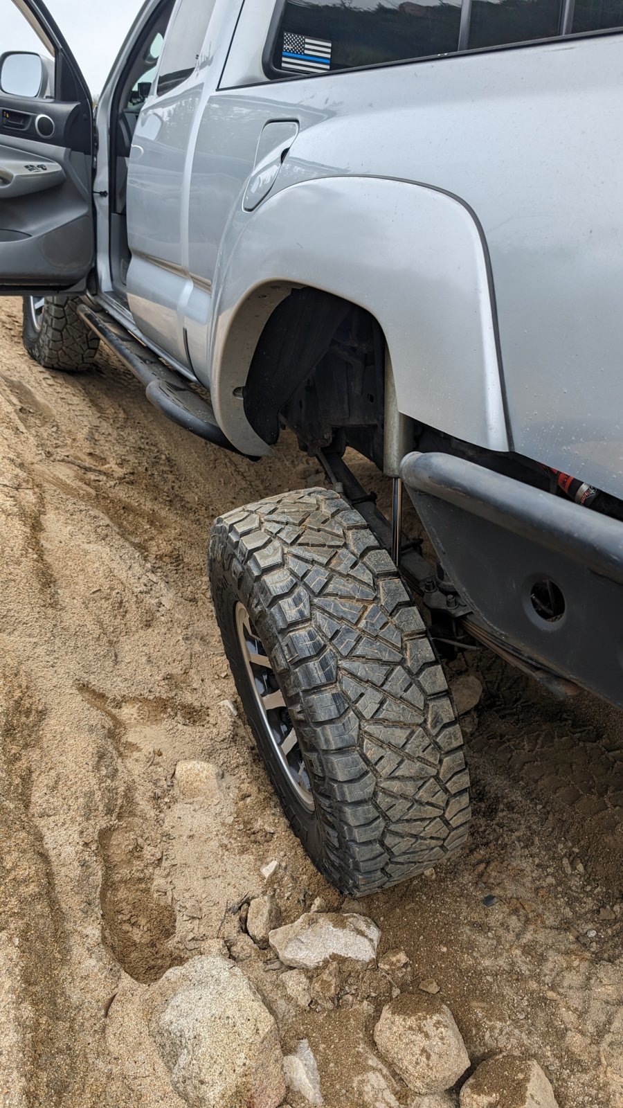

    IMG_7497.jpg I love the added flex and ability to haul a ridiculous amount of weight.
    Ricardo13x likes this.
