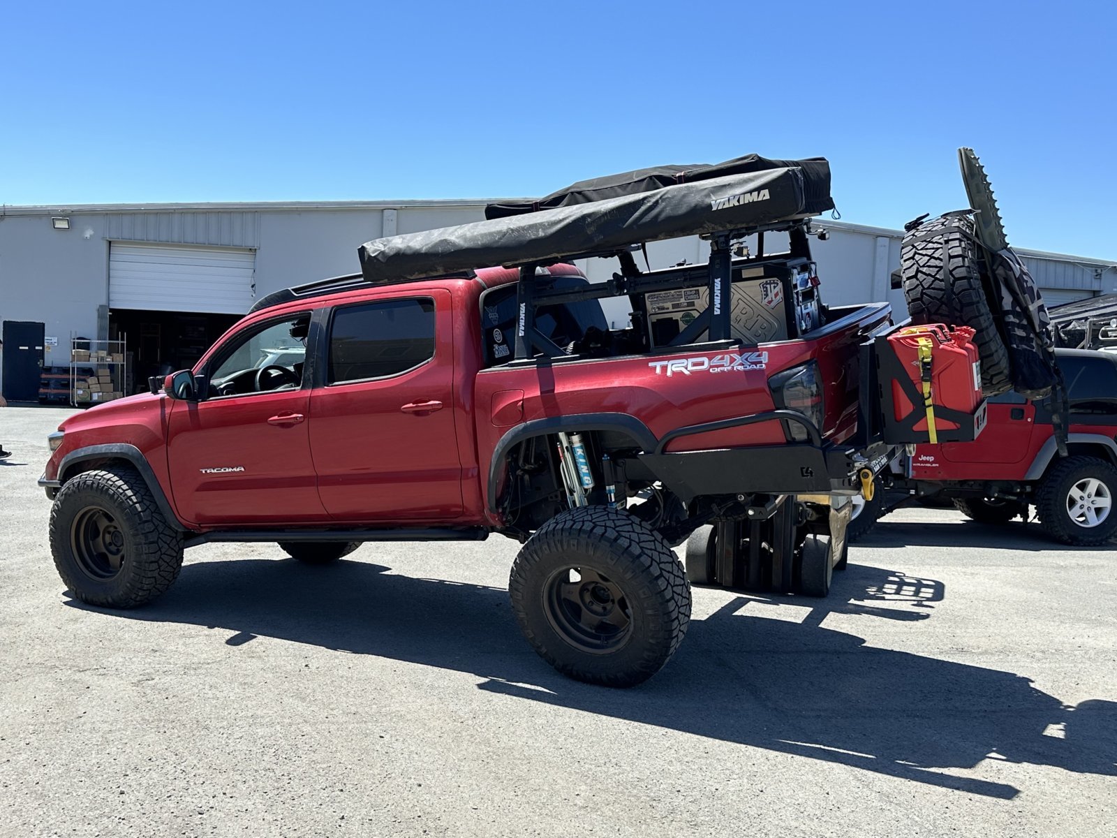

    Keep in mind guys that a swing out bumper is an overhung load, with CoG about 4 feet behind rear axle, that mod alone can total 400-500lbs that the leaf springs need to support.
    (An overhung load behind rear axle makes front axle lighter, and transfers weight from the front to the rear axle.)

    I spoke to the shop that installed my suspension and they think spring under is my only option? I don’t think so and think the HD springs should suffice for the rear swing out and spare.
    Thought? Pro and cons of going spring under.
